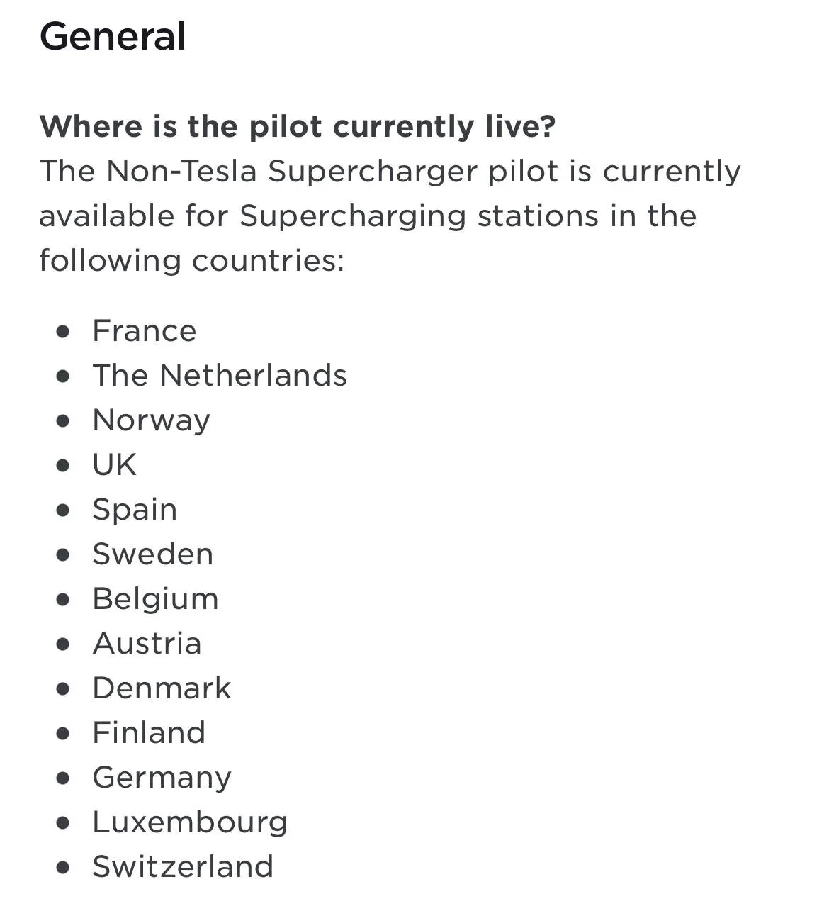

Bumping an old thread because it’s important that people buying Taycans in the US understand this.
By far the majority of EV charging stations in the US are Tesla superchargers. They are all 480v. When Tesla completes there plan to open the stations to all EVs, Taycans without this option will only be able to charge at 50kW. I have selected this option on my order.
I ordered mine with it as well. Most Tesla chargers are open now.
nickmdp
Nov 18, 2021
325
555
Midwest
2022 Taycan GTS ST
Ah, those are just comments by the company that they plan to do those things. They've also been planning to release full self driving for eight years now too...
