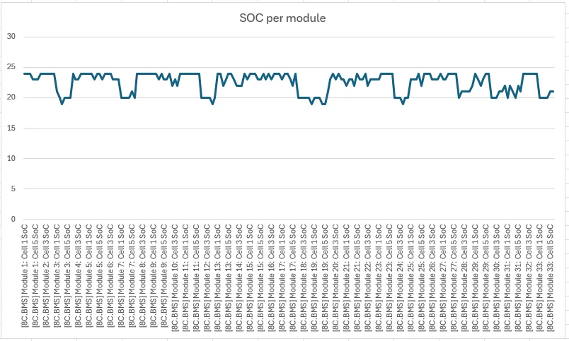

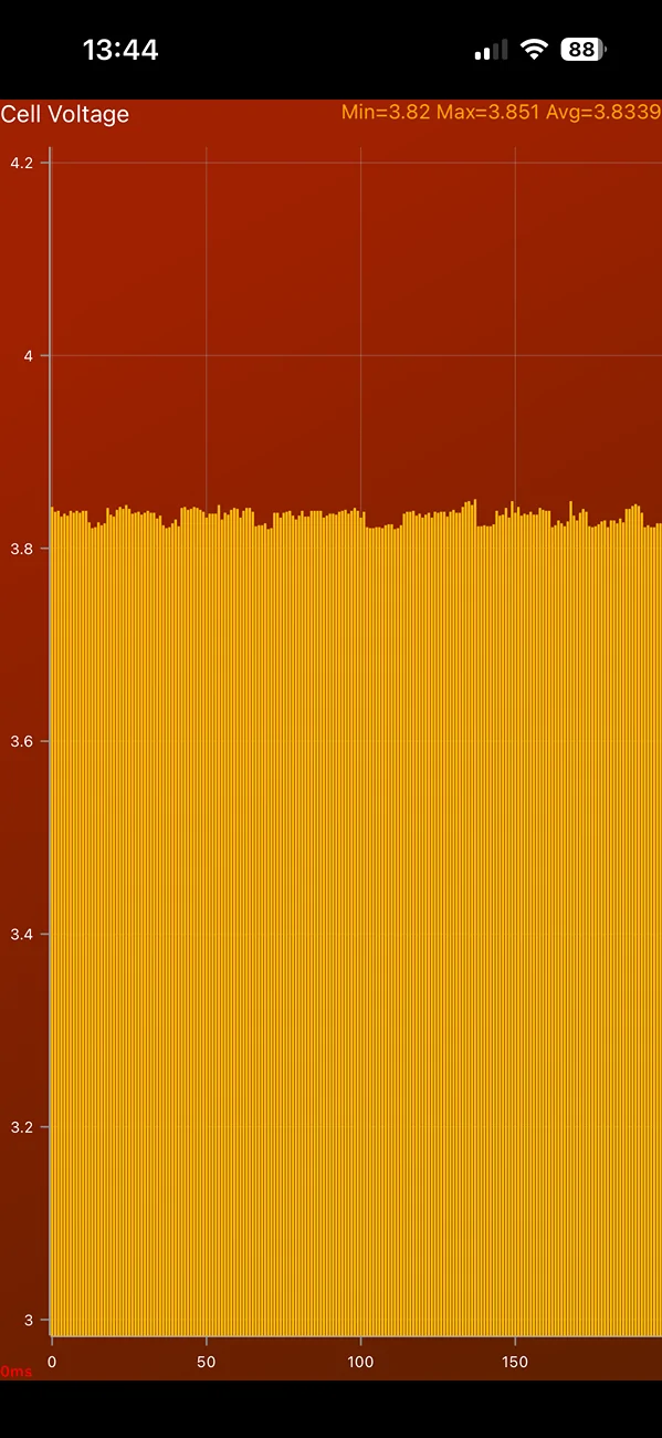

Based on CT14 software and Car Scanner I have a voltage differential of 0.1 volt on 6 to 10 modules. I had it 3 times out of 10 measurements. Not very good, I know. This is a 2022 4s CT with 50K and a SOH of 80%, and I received the Arb6/Arb7 letter last year. The diagnostic software was installed over the air four weeks ago, and I did not receive any notification of any kind and the issues mentioned above were there before the software installation.
Also, when the SOC is below 40% I’m losing 5-6 percent at night, but strangely enough, the cell voltage is identical before and after the percentage drop, so this is not a balancing issue. If I’m running a couple of launches, the differential is up to .2 volt on those 10 modules. They are definitely weaker.
I know what you are going to say. Bring the car to the dealer.
What other information/diagnostics can you give me based on the symptoms above?
