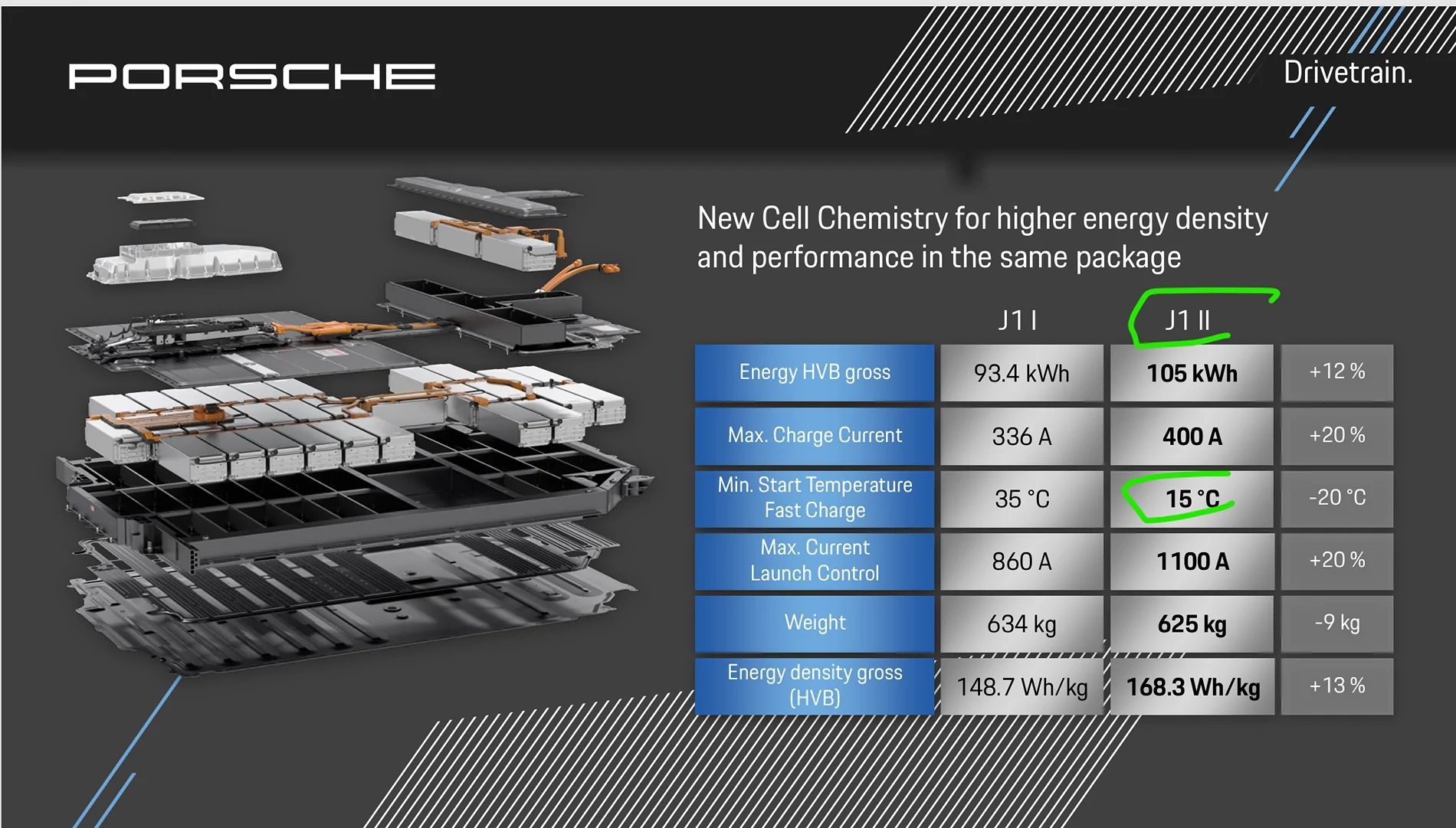

And leave the car in Sport Plus, while charging (with car "on"): that maximizes battery-temperature management. This results in around 15-30 more kW charging power, when getting underneath maximum charging-power (263 kW J1.1, 315 kW J1.2)

I tested my CT4, J1 only once, it was spring time, so battery was over 20C, but without preconditioning, it didn’t charge over 60kw (on Ionity 350, where i was usually carging at 260kw).
i haven;t tested J1.2 without preconditioning yet, but i found out that charging power is quite constant around 235kw and it doesn’t drop till 70%Soc….

J1.2 I cited the number from the spec-paper. Never drove/ charged one.

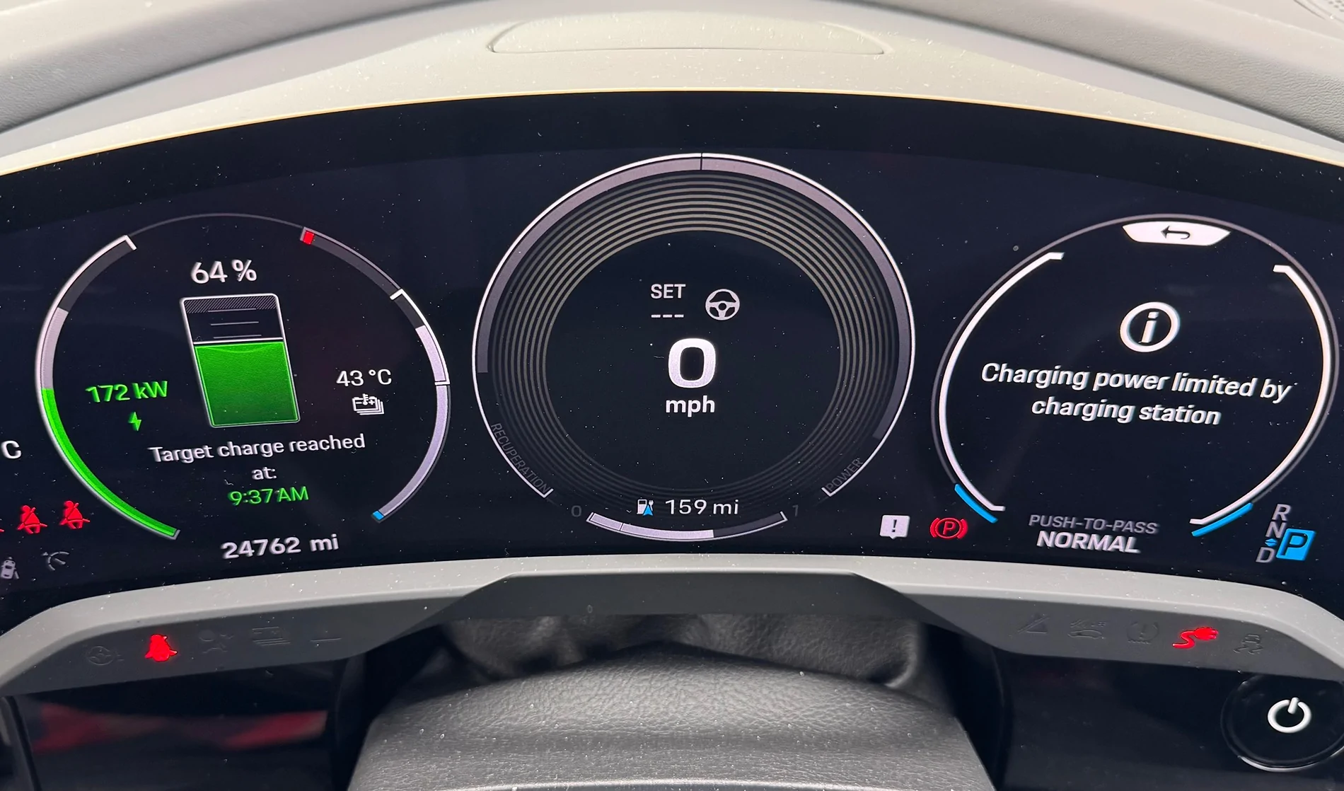

I regularly see over 310kw in J1.2 when the charger is not restricting power, 318kw my personal best so far. The J1.2 will tell you if the Ionity station is limiting your charge rate, if not your car is limiting for some reason
Oh…that’s true, i’ve seen this message, but i thought it’s some glitch, since i was charging several times over 260kw on the same before 🤷‍♂️
