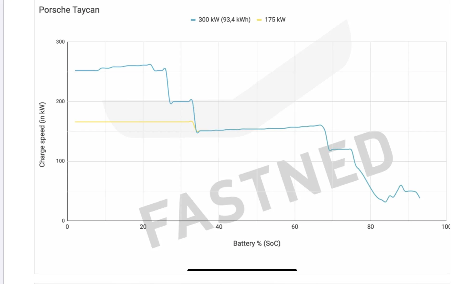

Wonder if the Fastned curves need a refresh post the big uPdate and MY23?
I have a feeling these graphs need an update. I have not found any fresher ones for the Taycan though. Seems the car does not throttle down as early as shown.

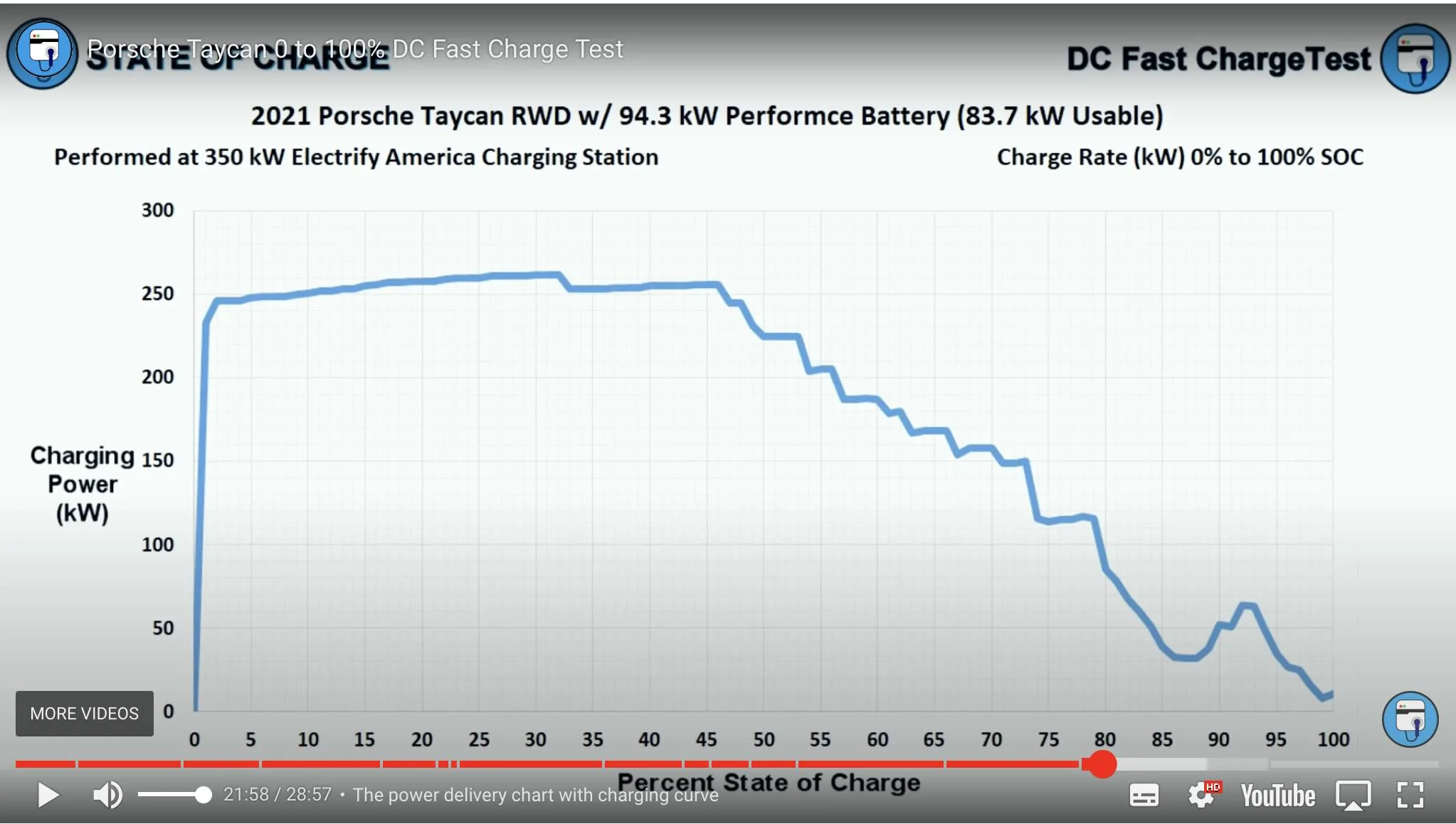

This one was done in 2021 and already at this time the charging curve was different to the Fastned one. This is very close to what I have experienced at several Ionity stations. And in such case the battery saving setting would make a difference. Slightly longer charging times then but quite marginal. Perhaps a few minutes if you charge from 10 to 80%

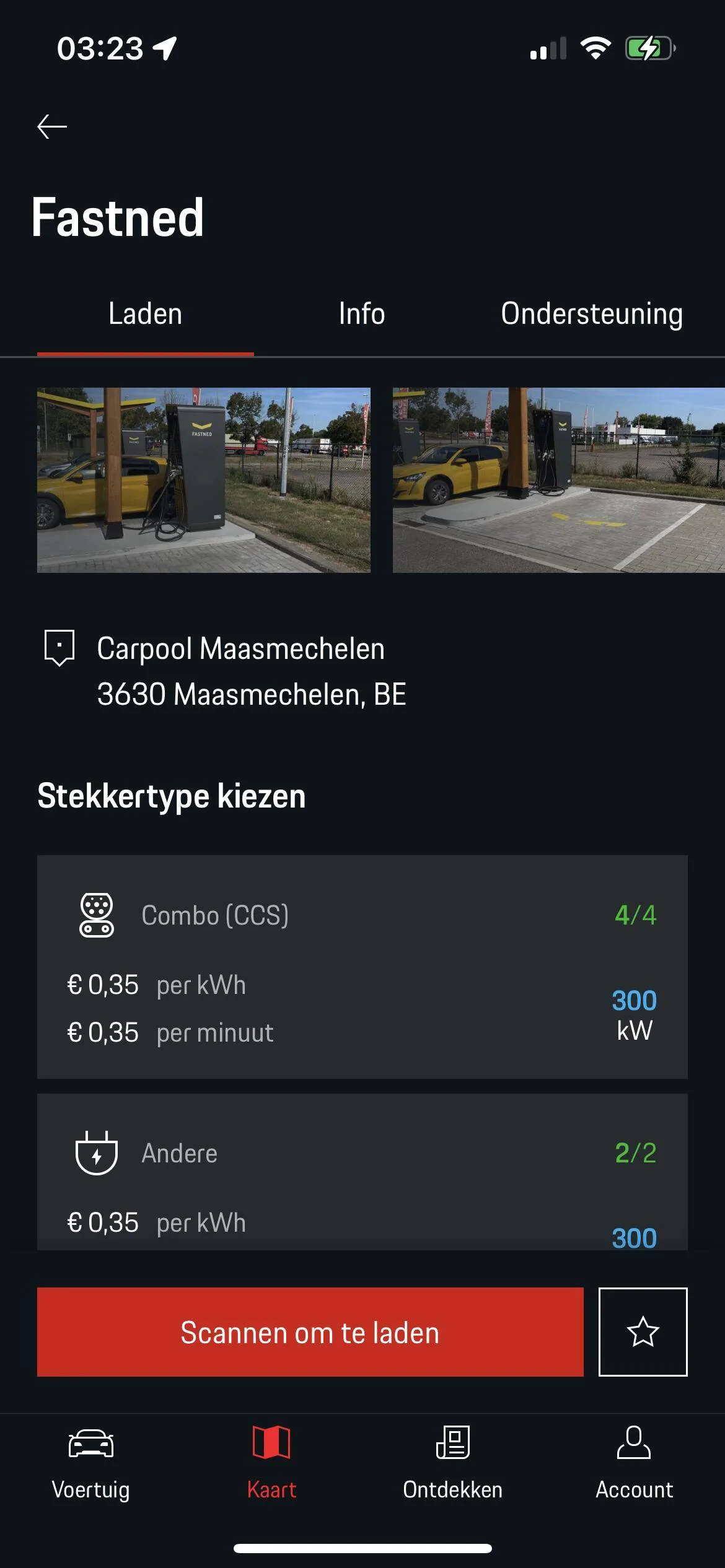

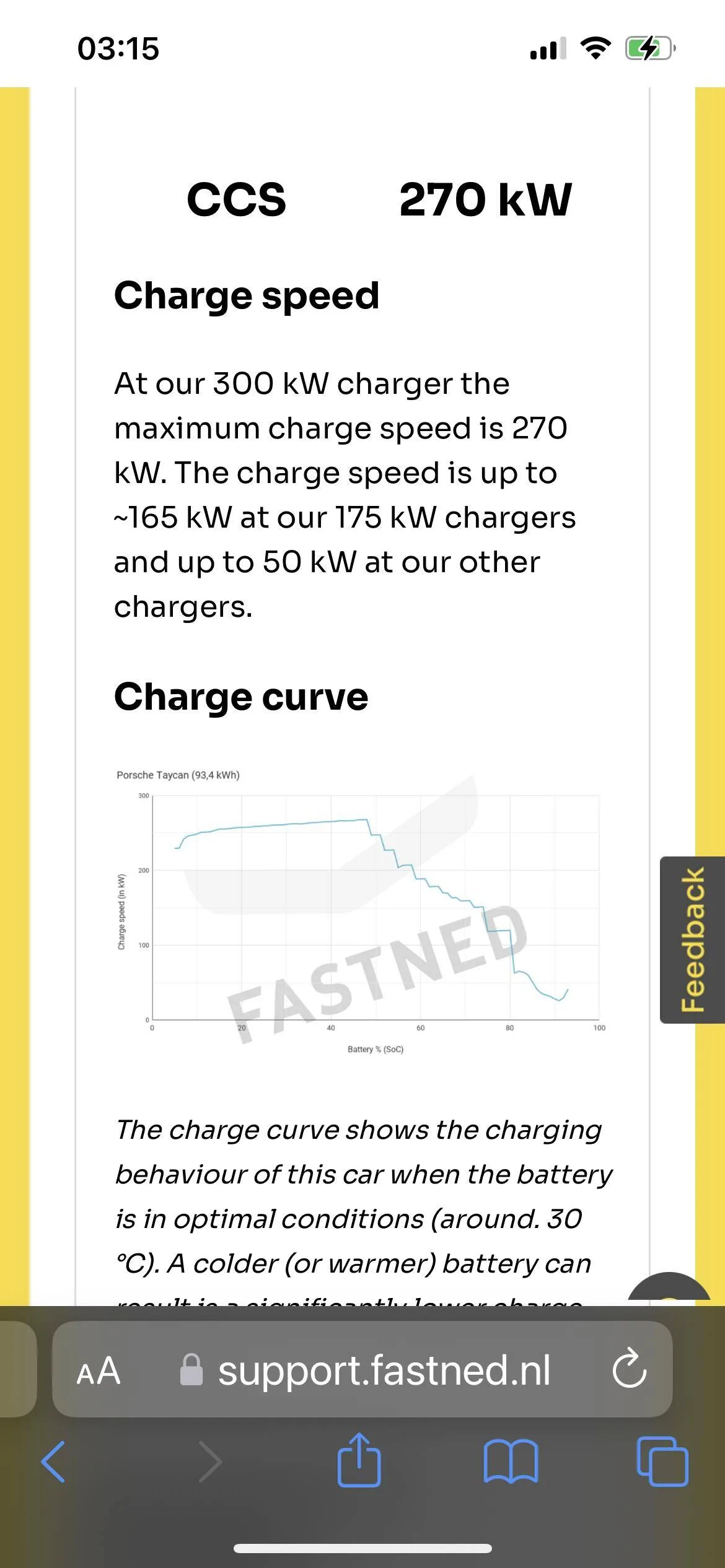

I think they did. Saw this today.
I saw that Fastned now also shows as a charging location in My Porsche app and that it should be accessible with charge service for 35 cent per kWh and 35 cent per minute. Didn’t try it yet but until now I always used plug and charge. This works well but at a much higher Fastned rate than with Porsche.This would be good news.
