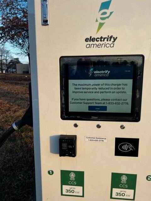

Normal I'd say plus you don't know if the EVSE was throttled by the operator for example.

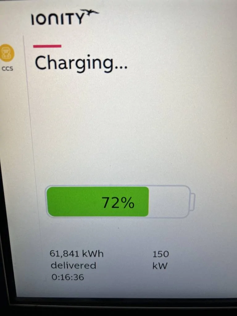

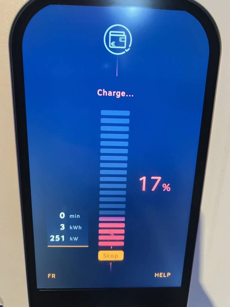

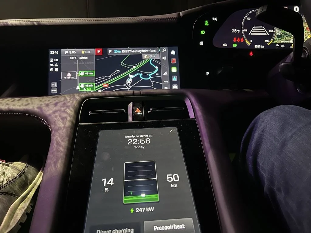

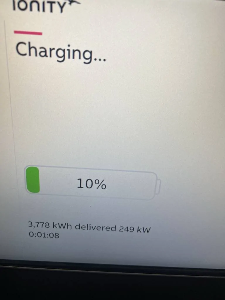

Can only speak to IONITY in Europe but I did 3,000kms across France and the UK in the last few weeks and on the drive down never saw above 0c (32F) the entire day and was generally -3c (mid 20s F) and at every stop, 5 each way, I was getting 240-255kw straight away every single time. Battery was preheated by the PCM. The sites were quiet generally which maybe helped.
The only slow charges I saw were at Tesla sites but even then I was getting 145, against a theoretical max of 150.
In summary I think the car isn't the problem in these situations it's the charging infrastructure.
