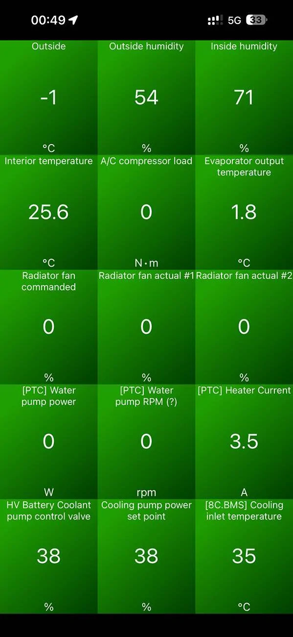

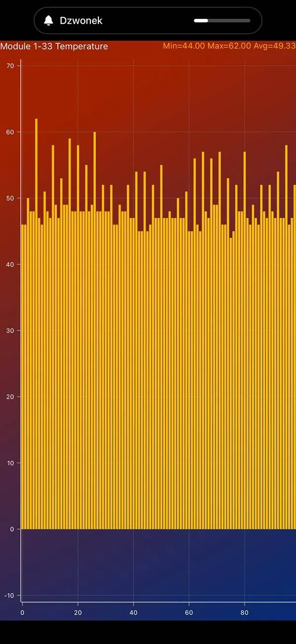

- the battery temp during charging screenshot (Car Scanner). Some modules looked like overheated
- screenshot of fan/water pump dashboard from Car scanner taken after 8min of driving - never looked at it before, so I have no idea what are “right” values of those parameters

Let me clarify. Your battery temp went to 49C / 120F and then the charging stopped: by the car or the charger, any error messages, turtle icon? I was in a close to 0C / 32F charging, preheated battery, clear weather, no ice buildup, and fans were going all out starting about your temp but kept going until battery temp reached 55C / 131F and turtle came on.
I would say temp sensor that triggers the fans frozen over or the fans may not able to turn with some ice buildup on them or around them, but I have not heard of anyone with seized fans having reported that the car would tell you that fans are seized. I do not think there is a sensor there.
The car seems to protect itself by stopping charging, but I would say it should give you an error or a turtle icon to let you know. Bottom line, not having fans turn at the 49C / 120F is not normal.
