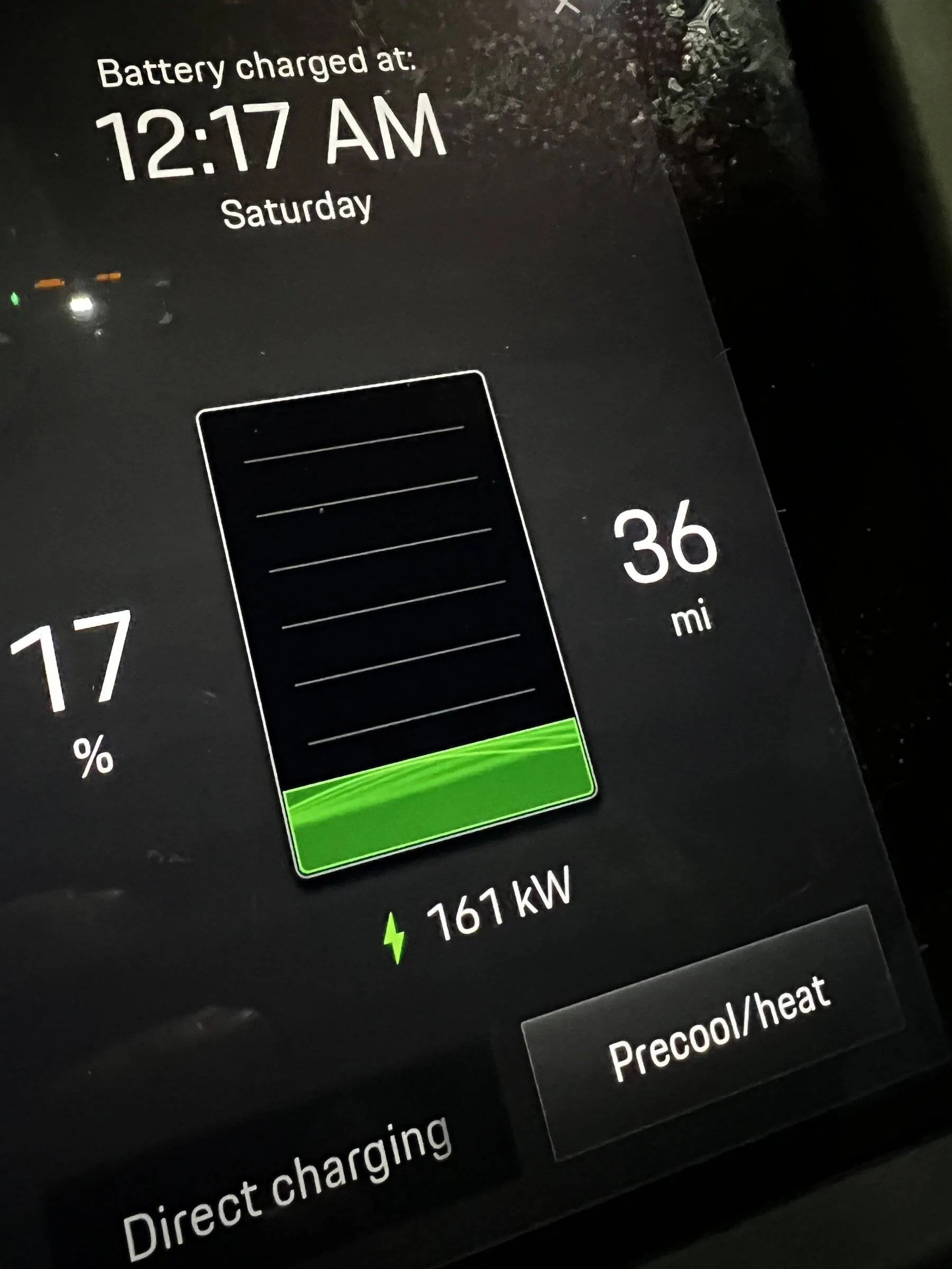

So this has happened to me a couple times, and I can't find any details about what it means.
While sitting at an EA 150kW charger, I've noticed the charging speed ramping up above the charger's rating and seeing the charging lightning bolt turn green.
I suspect it's the onboard charger kicking on but I read that it only works with 400V chargers and EA uses 800V so it doesn't really make sense.
Has anyone else seen this?

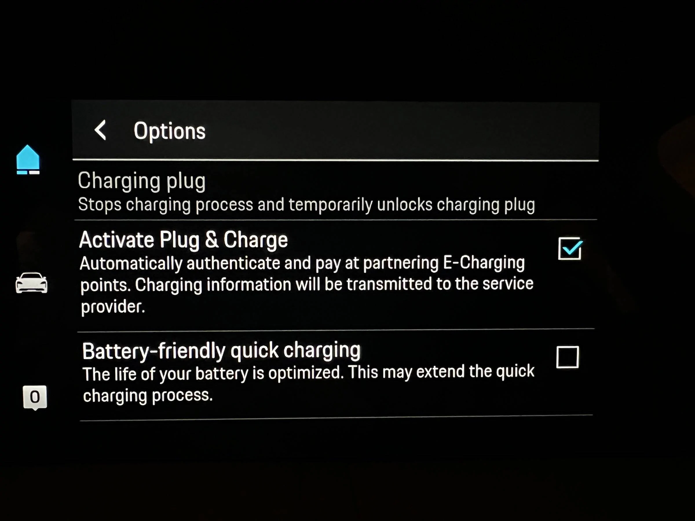

Do you you have L3 battery friendly charging enabled by chance? It’s the only thing I could think of. It’s not the onboard charger.
I had to double check - It's not enabled

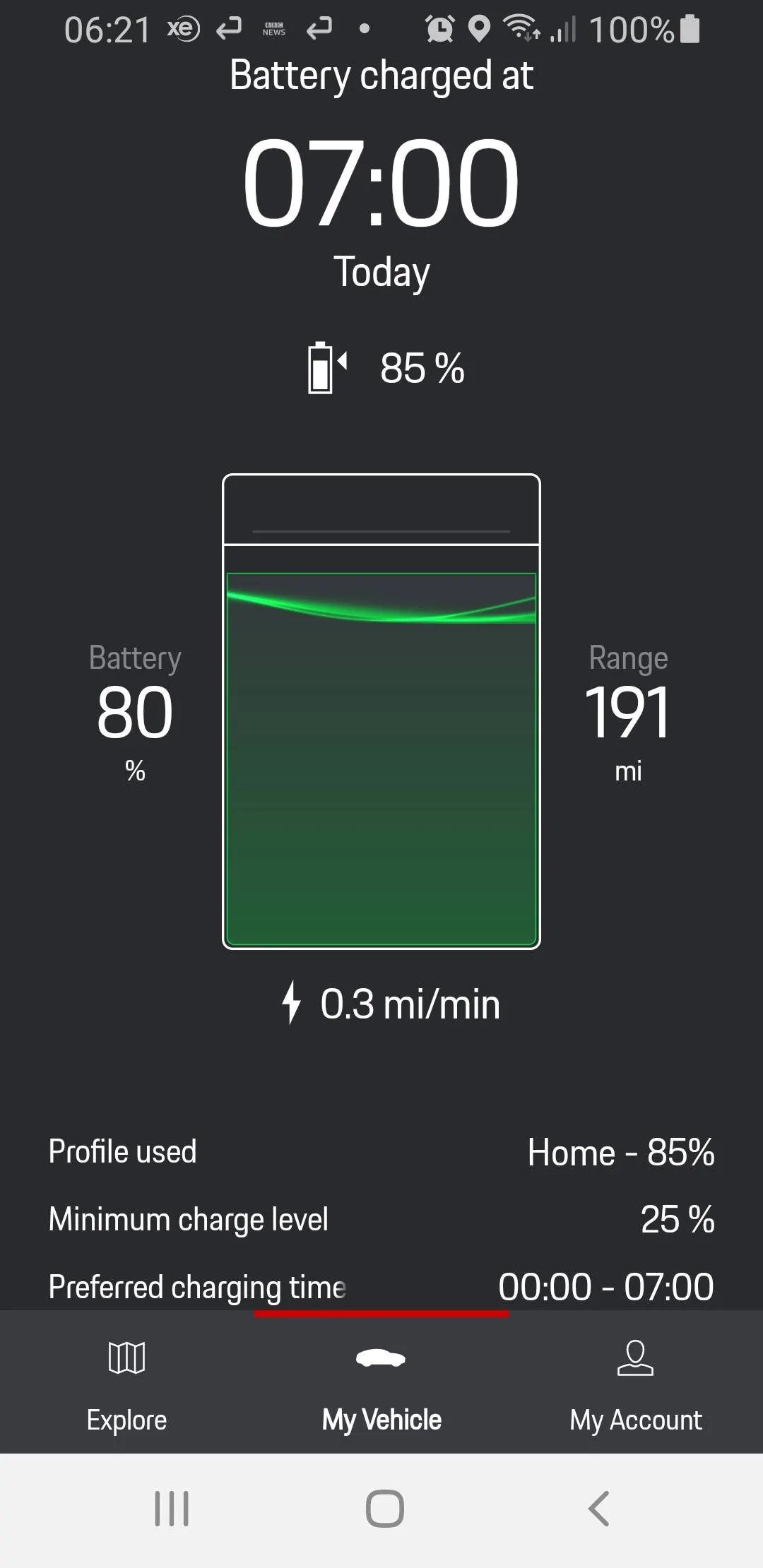

I always get the lighting bolt even when AC charging at home. Simply denotes charging is in progress!
Porsche Taycan Green lightning bolt while fast charging Screenshot_20211126-062111_Connect

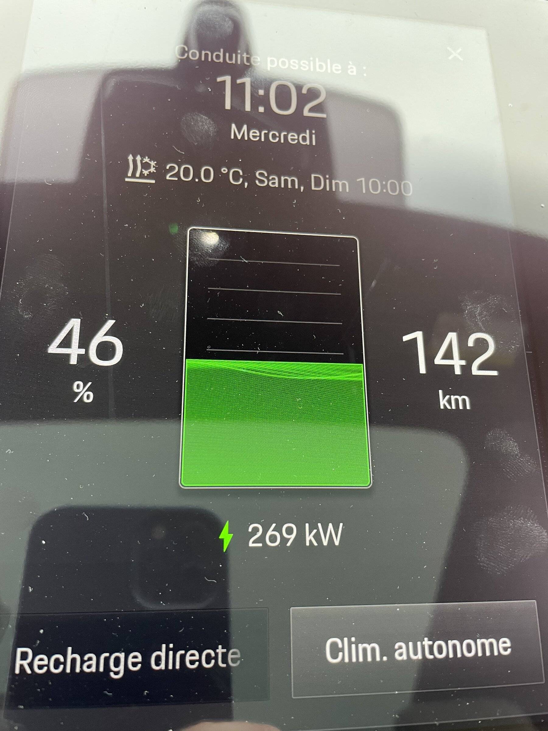

I see it green when it’s really fast at the beginning.
Like at Ionity at 269 kW

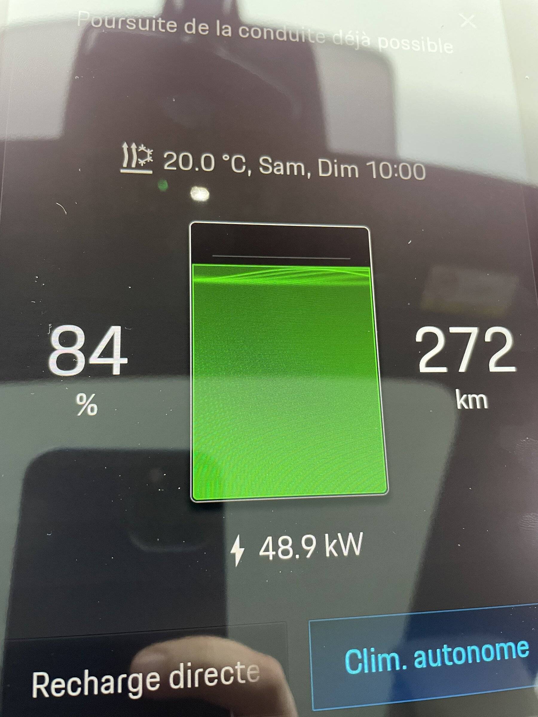

Porsche Taycan Green lightning bolt while fast charging 5E6DBF10-07A9-4A8B-BD52-CF7A7CA9C015
But not at the end when it’s slower.
