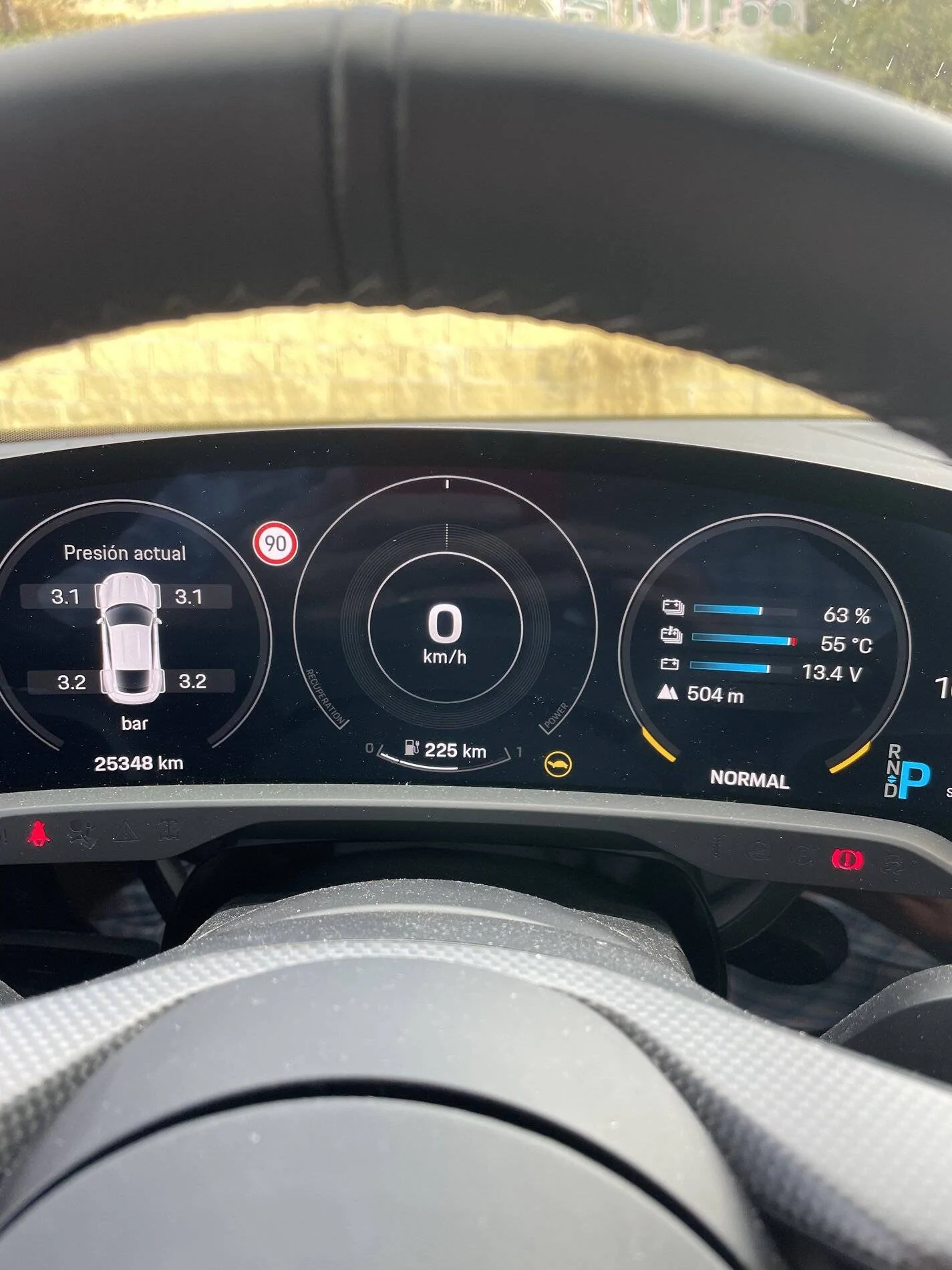

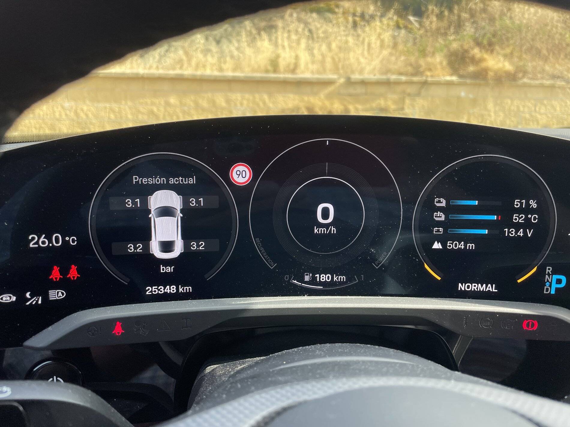

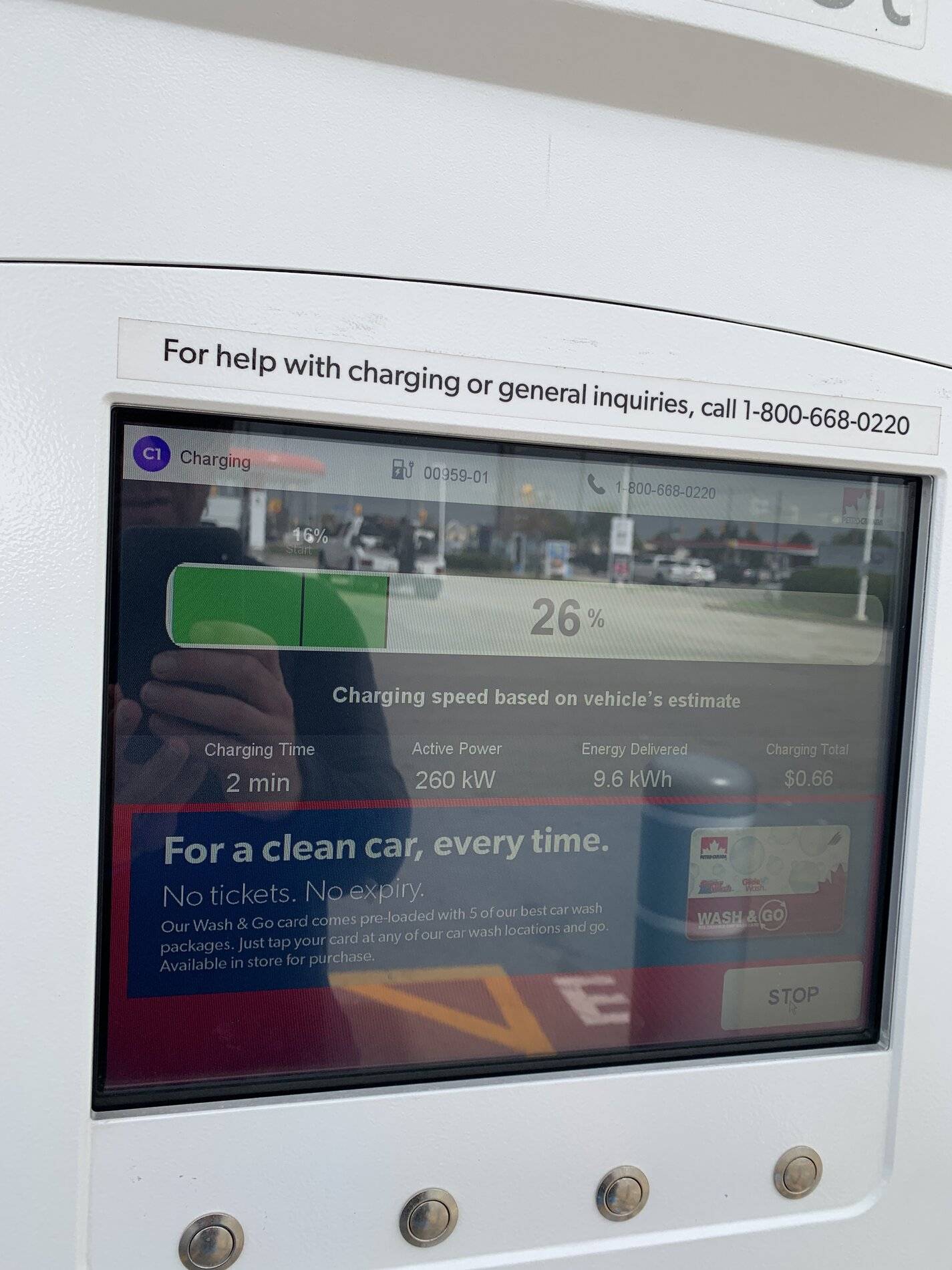

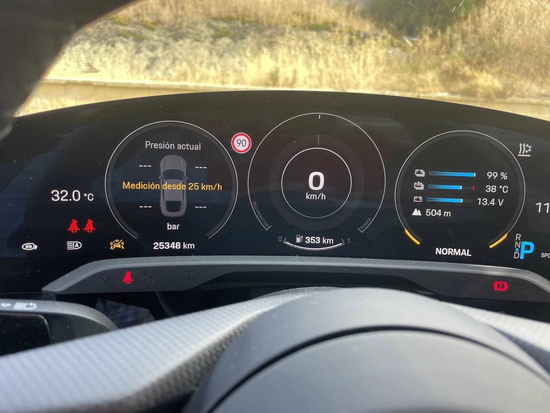

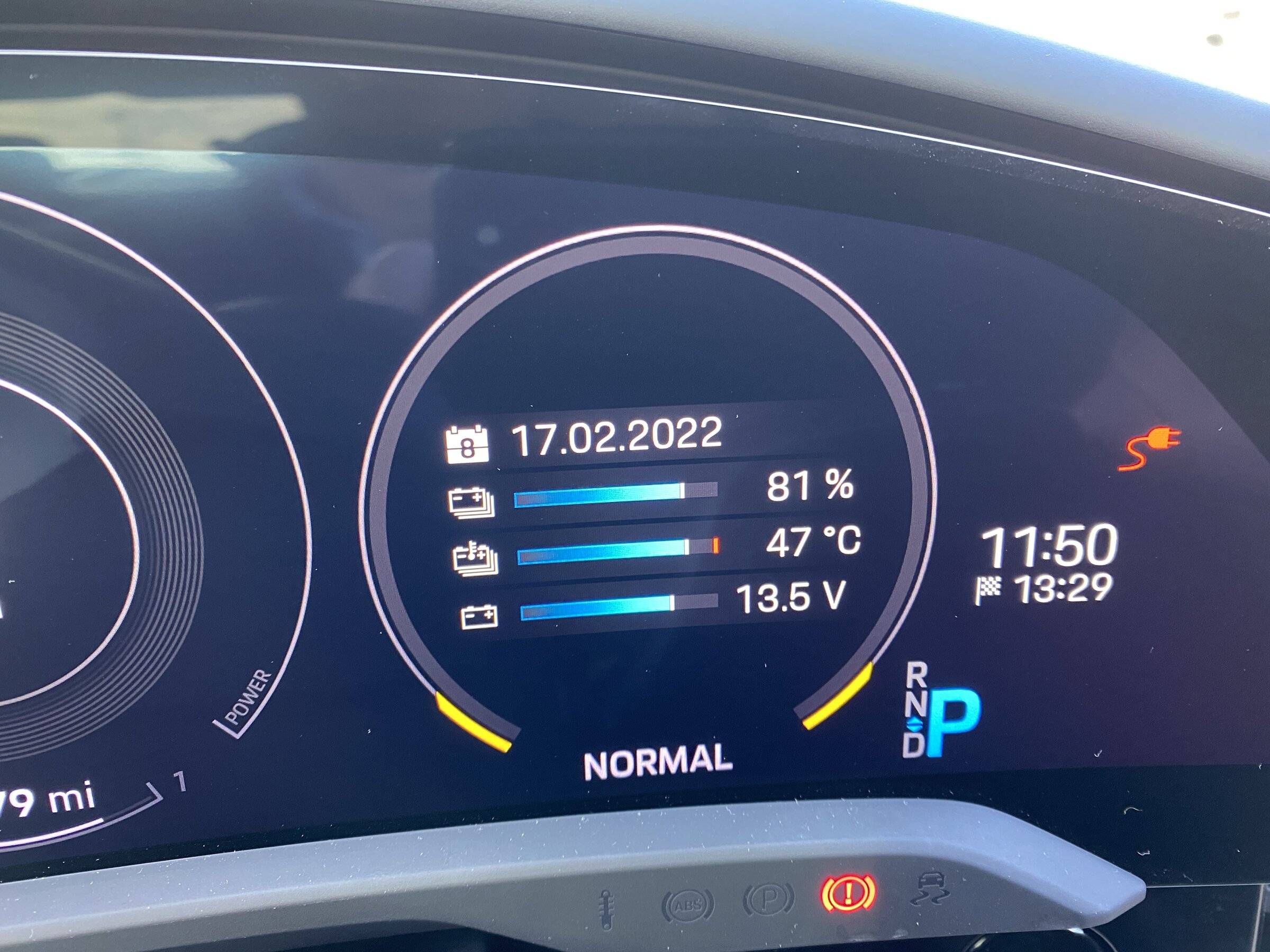

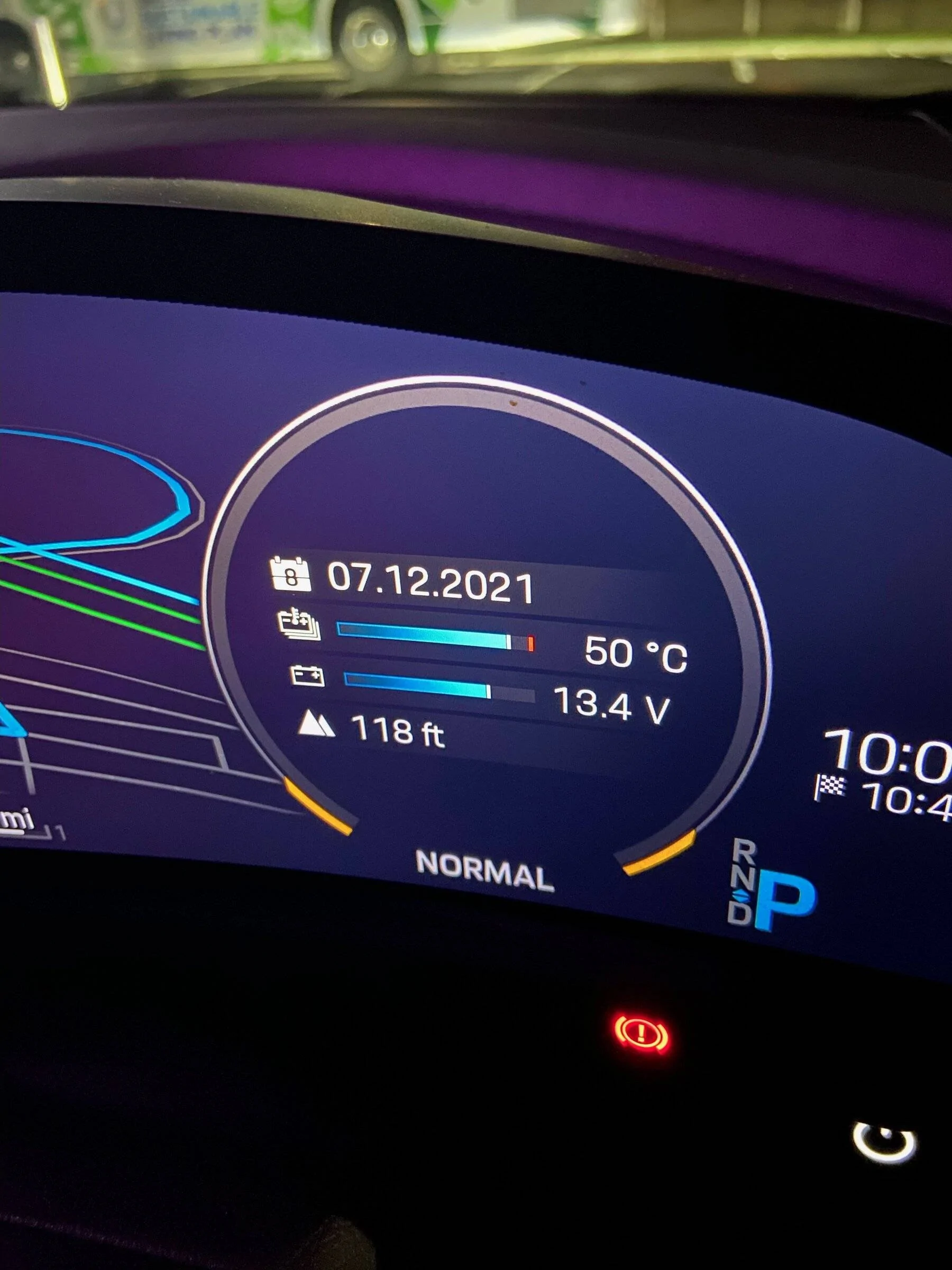

I have reached higher tempereatures and just noticed while going thru the photos that at 55°C the turtle appeared. The temperature drops with the charging rate … I had no problem as I went to 99%… my next Ionity charger was far and uphill …

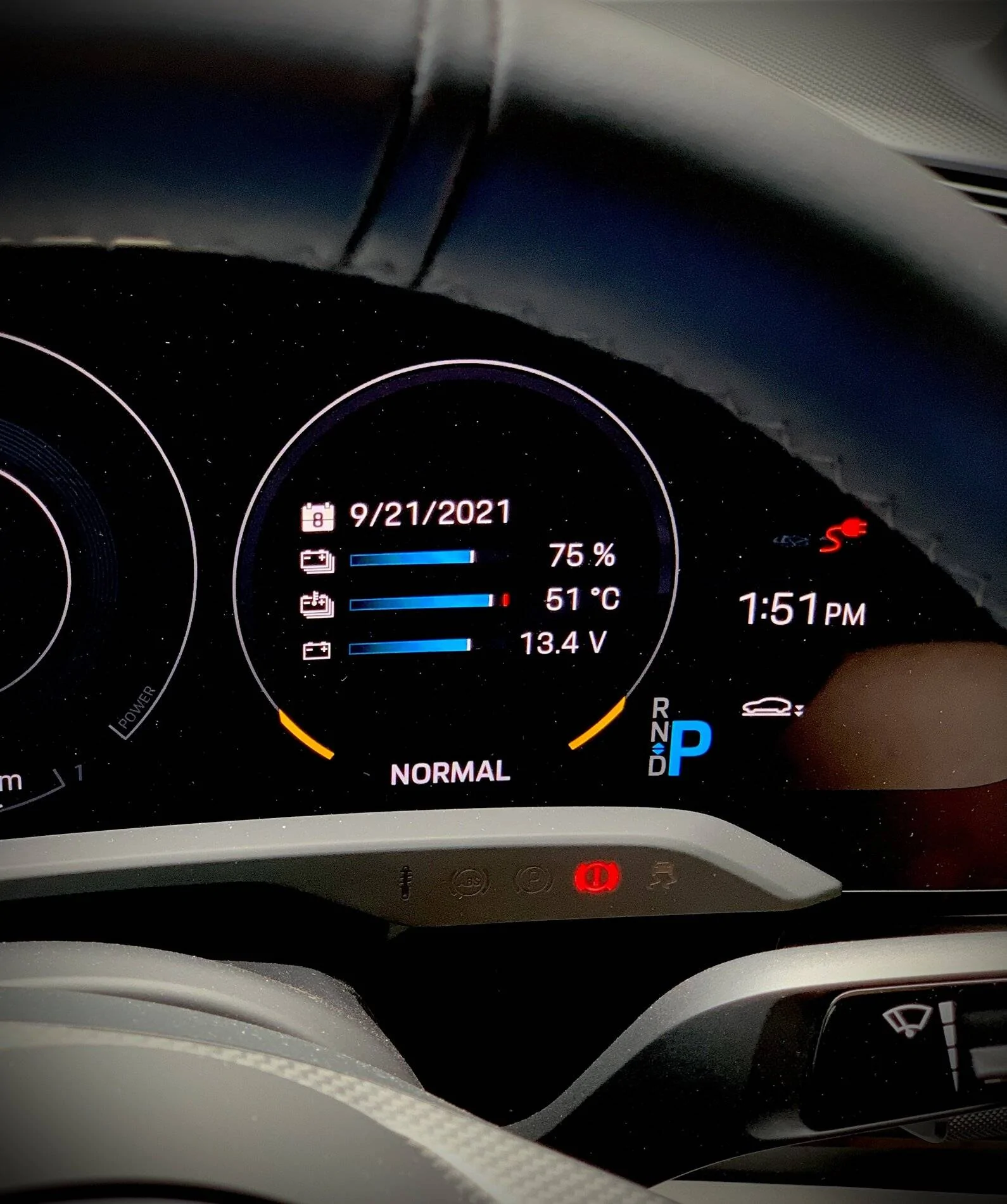

Used Porsche Nav with charger options on so battery pre-conditioned I assume prior to arrival at Ionity ? Never seen my battery temp this high is this right?

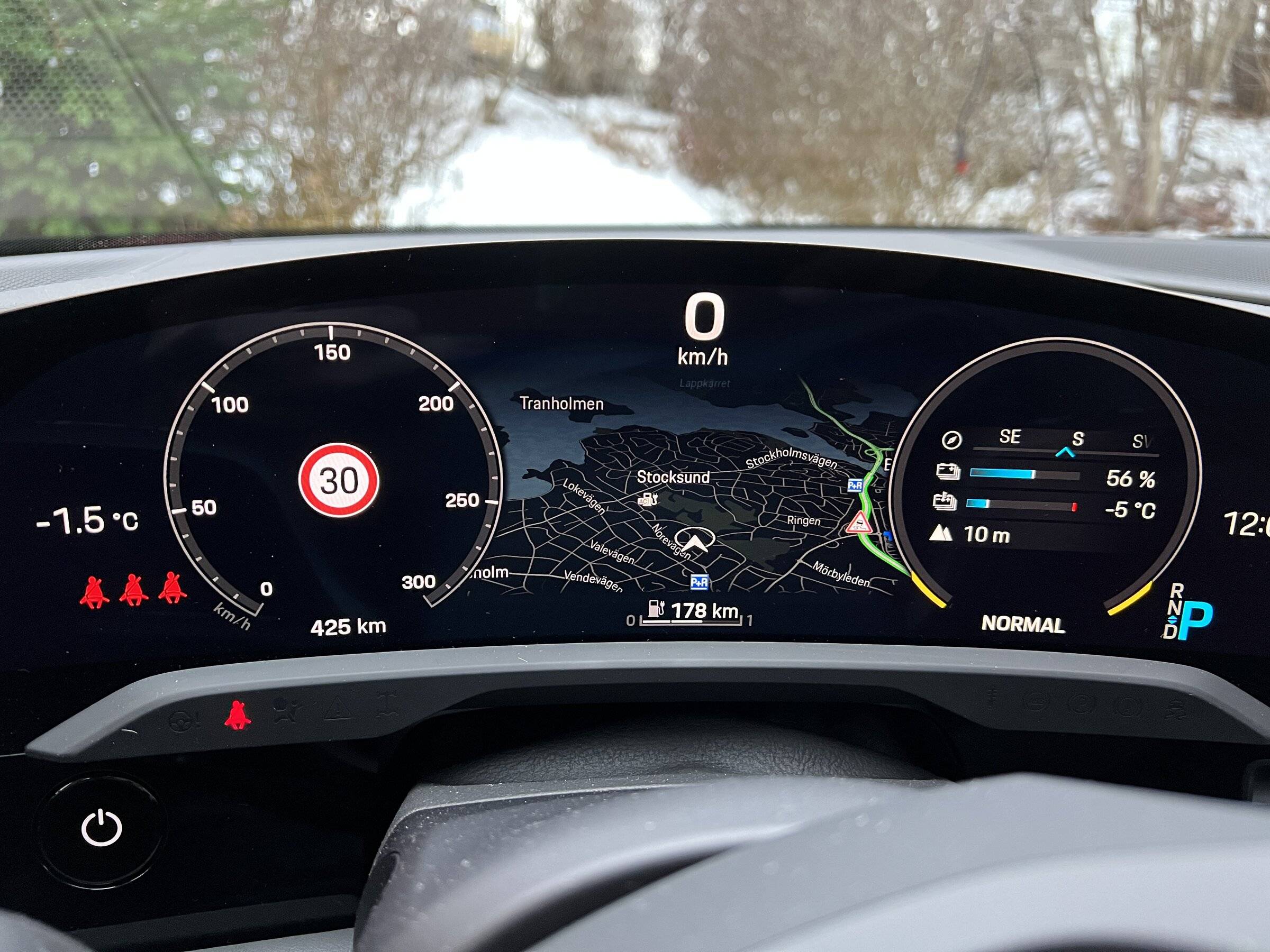

I had this interesting relation between outside temp and battery temp after a 20 min drive yesterday (the -1.5 was about correct).

I've never seen battery temperature below +3Celsius... even if outside temp during the night was down to -5.

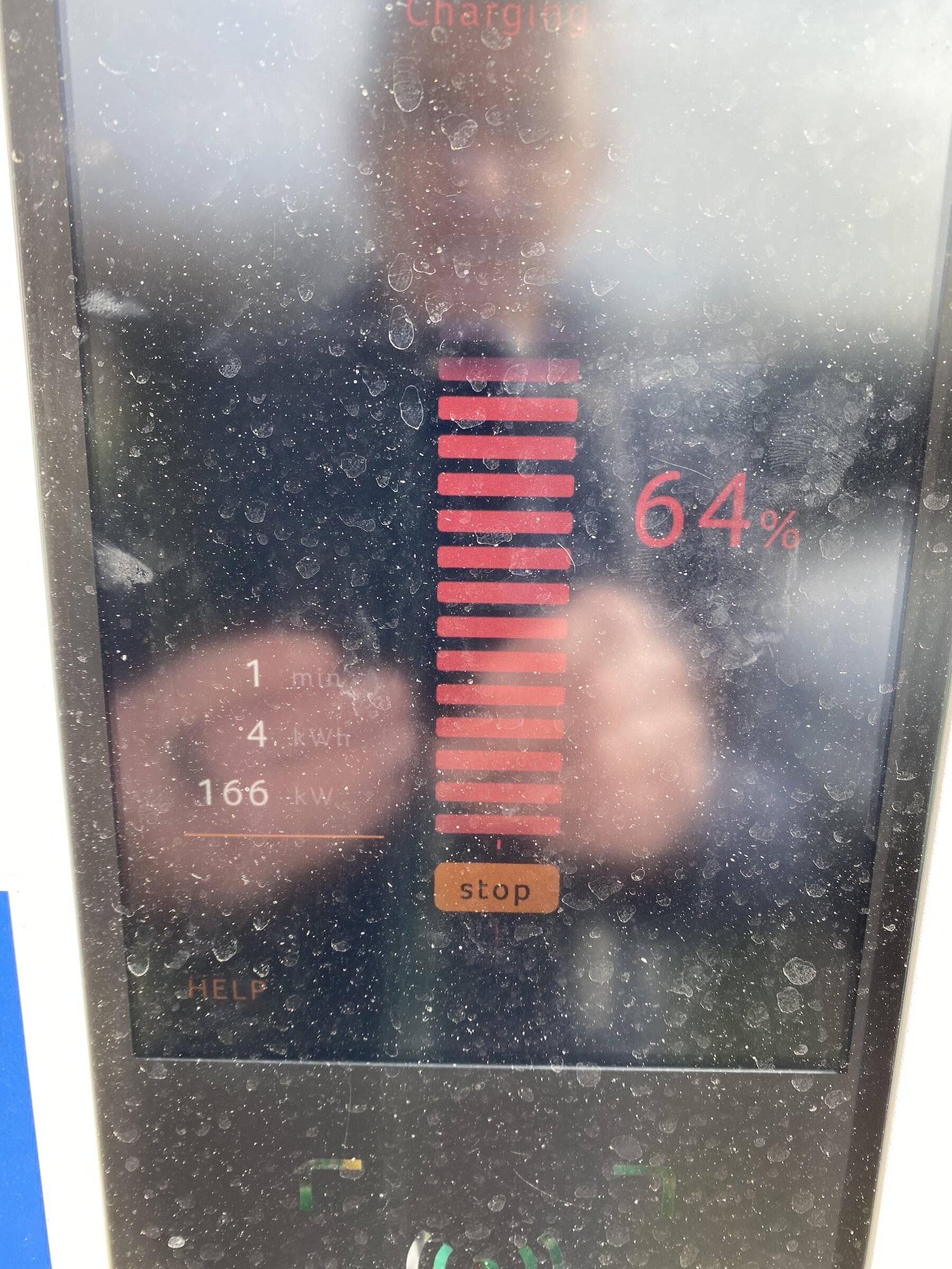

I’m having a mini road trip in the UK, and thought I would experiment with setting a charging stop en-route via the navigation system to see how much it would pre-heat the battery.
I did the same trip from home to IONITY in Peterborough (76 miles) in mid-January. The outside temp was -1 C and I didn’t use the navigation - just turned up. The battery temp was 12 degrees, and the car would only charge (on a 350 kWh charger) at 50 KWh.
Today, with IONITY set as a charging stopover, the battery temperature climbed from 12 C when I left home to 47 C when I arrived at the charging station. The outside temperature was 9 C. I was at 64% state of charge when I arrived and the car started charging at 166 kWh immediately. By the time I’d been to the loo and walked back to the car, it was at 95%.
So, it does make the charging quicker if you pre-heat the battery, the only down side is the electric consumption increased from 38.5 kWh per 100 miles to 45 kWh per 100 miles as the battery was pre-heating.
