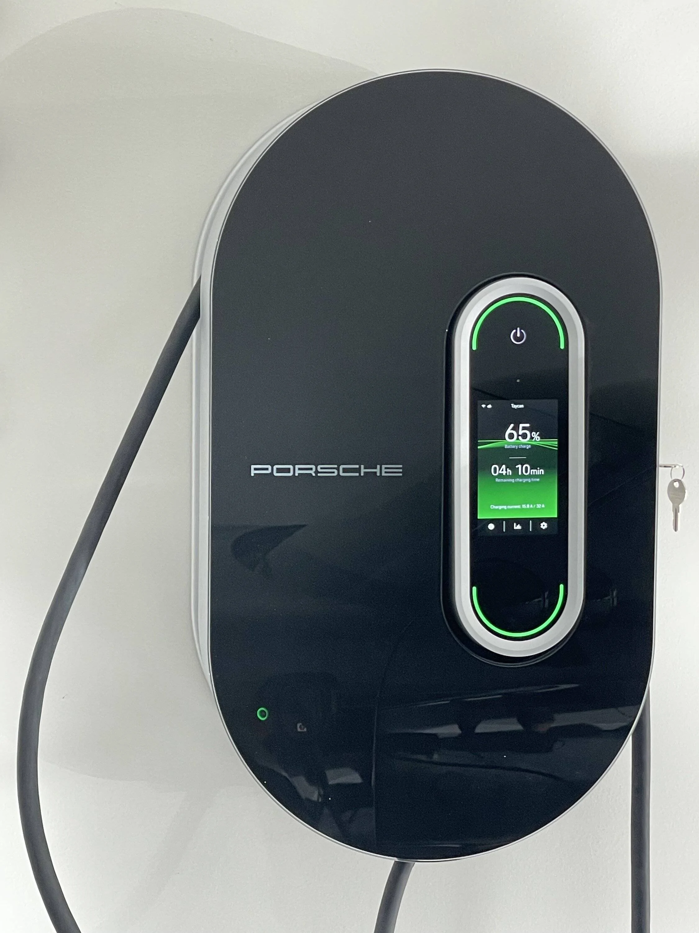

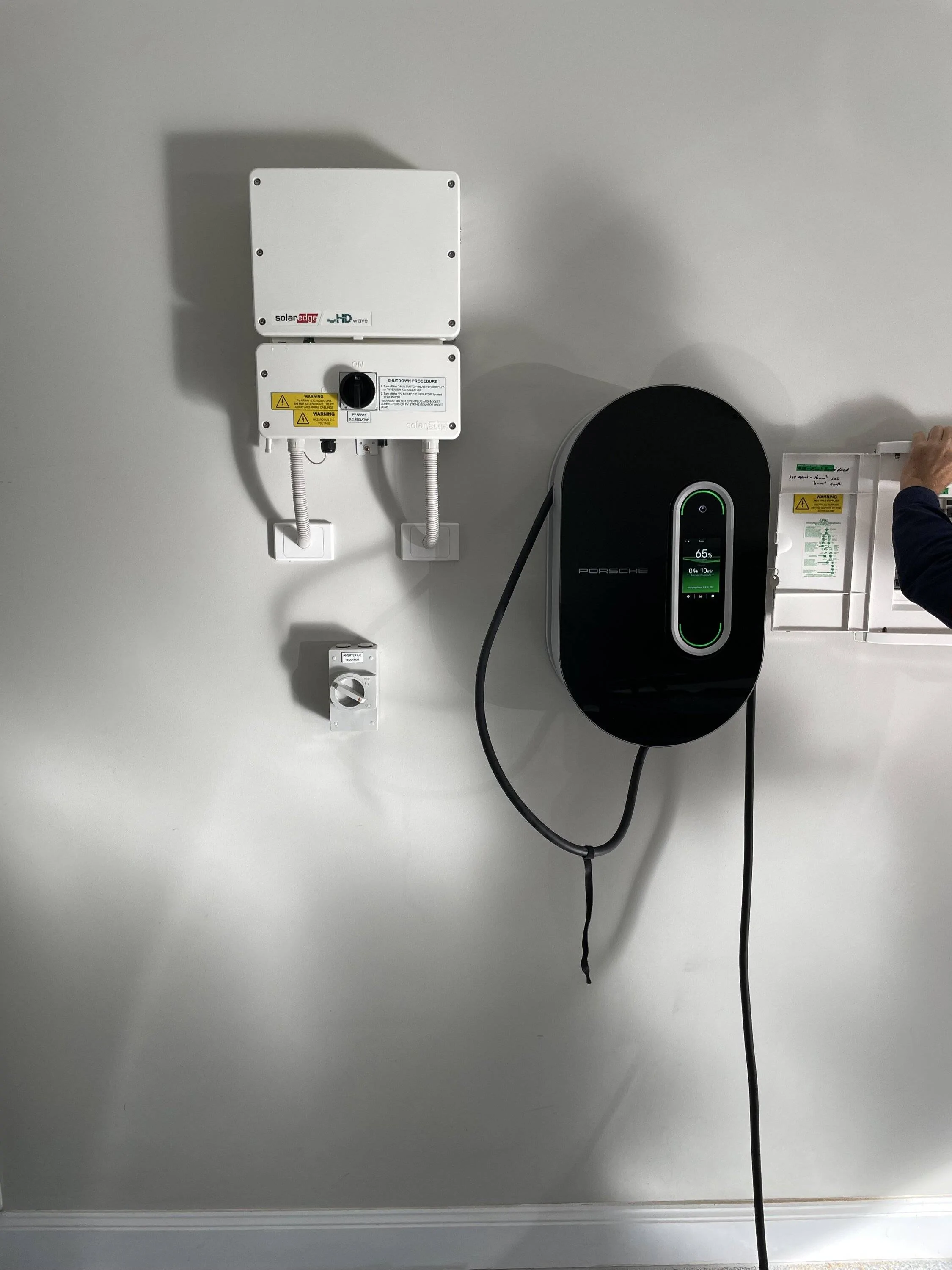

I have the 32 amp circuit fitted in my garage delivering 11kw. If I had the 22kw upgraded onboard charger in my car I could get up to 22kw.
In Australia you cannot untick the option of charging so you have to pay for the wall charger as part of the purchase. I have charged at home and it works well.
Also at hotels Porsche have installed this same charger and call it the Porsche destination charger.
At the Porsche centre they have dc chargers at 150kw.
In the states is it cheaper to purchase other brand of chargers?
