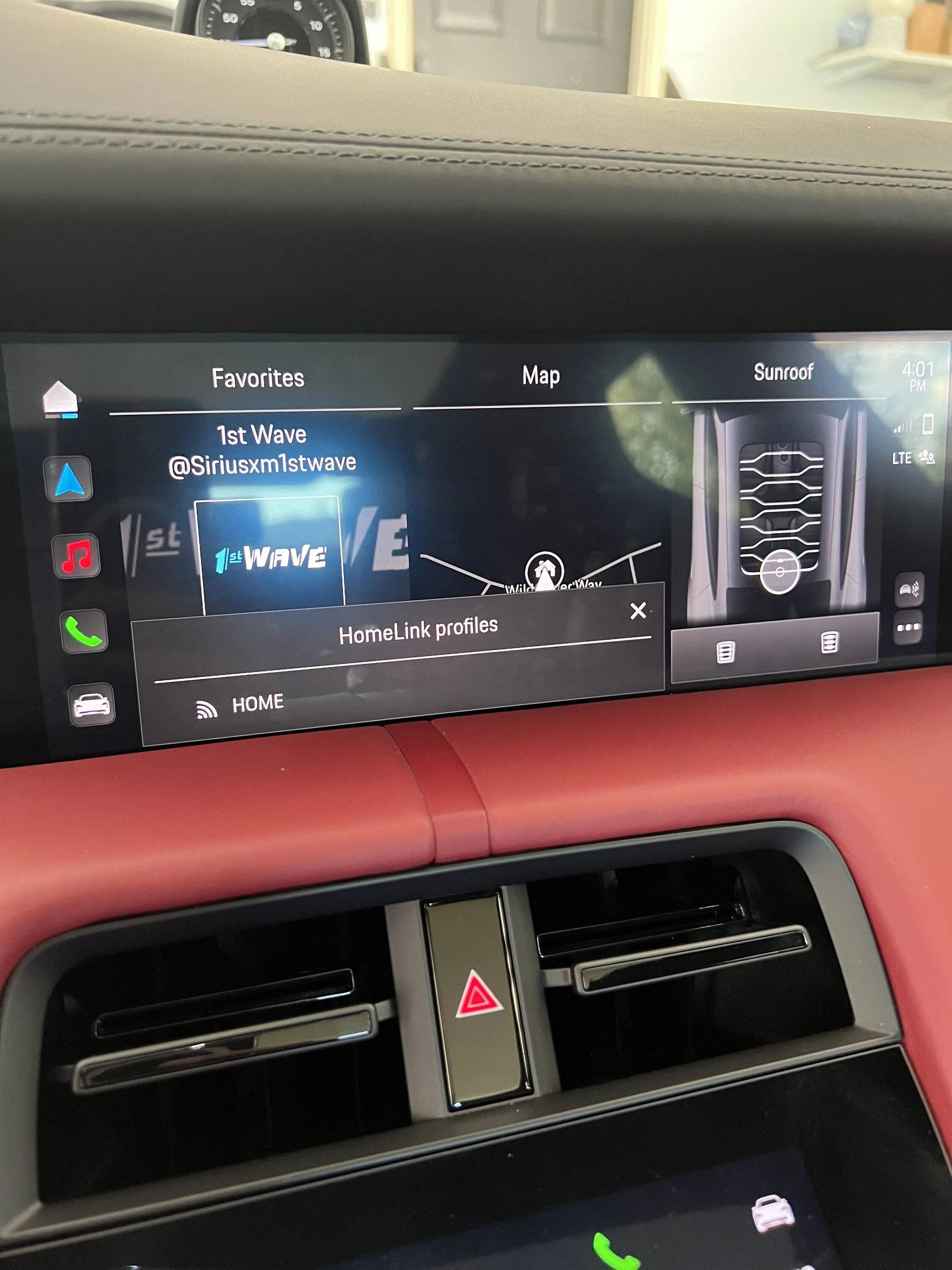

I have Homelink setup and have programmed one of the diamond aux buttons to open the garage, which works great. The issue I’m having is that the Homelink notification, which automatically pops up when I’m arriving or leaving my house, is not clickable.
I can’t imagine this is intended. What’s the point of the pop up if it’s not clickable? Obviously I know when I’m at my house. I’d rather have the option to turn off the pop up prompt than have this useless thing blocking part of the screen. Anyone else have this issue? Couldn’t find anything in the forum history.

It's clickable for me. They changed design of the pop-up with the latest software update and made the clickable area a little smaller – I assume so that folks with multiple homelink devices can get more onto the pop-up.
Anyways, have you tried clicked directly on the the part of the popup in your screenshot that says "HOME" – and not to either side of it?
Because that part of the pop-up is clickable for me.

Yes many times. Guess I’ll have to keep trying!
I don't have my diamond buttons set to Homelink. Perhaps to rule that configuration out – set your diamond buttons to something else – and try the popup again?

Hold it down and the icon to the right of home on the pop up will look like it’s sending a signal, then the garage door will pen or close

I have found that since the update, you must keep the button pressed longer… maybe a full second or even a little longer…
Yep tap and hold and it sends a signal
