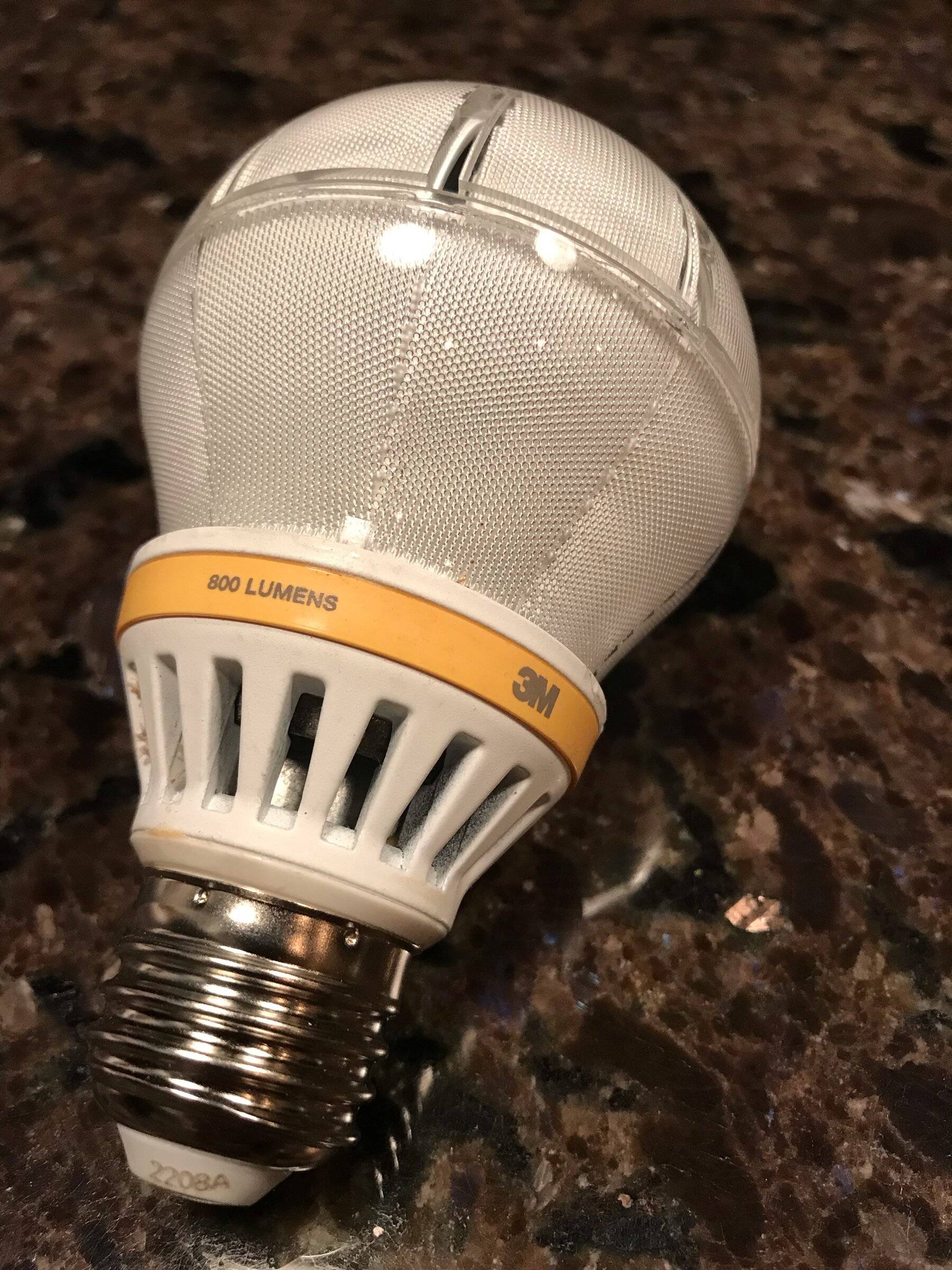

Mine is a LiftMaster as well.
But I did a quick google search and found that is may just be the type of bulb you use.
https://blog.lightingsupply.com/blog/do-led-bulbs-interfere-with-garage-door-openers
These are what I have in my garage door openers: GE Relax
Porsche Taycan Homelink Pro Tip 1641260872440
Confirmed: It is for sure the bulb. After reading these posts, I pulled this 3M LED out of my opener (no idea how old it was, I'm guessing at least 5-7 years old) and replaced it with a good old fashioned incandescent bulb. Home Link now works like a champ!

I've had a myriad of troublesome issues getting my Taycan to recognize and open my garage reliably. I deleted and re-added, faithfully following the instructions repeatedly, and could not get my garage door to open except intermittently.
With that in mind, I thought perhaps my 15-year-old garage door opener was out of date with the Homelink technology imbedded in the Taycan so I spent $625 and had a new a garage door opener installed. As the technician finished installing the new unit, I mentioned my problems with the old one. After my tale of woe, he looked at me and said, “I wish you told me that earlier. The problem isn't with your garage door opener, it's with the LED light bulb you used to replace incandescent one on the garage door opener.”
He told me that LED light bulbs emit a frequency that effectively jams the signal from the remote used to open the garage door, including the Homelink in the Taycan (or any car for that matter). Hence my problem.
After setting up anew in my Taycan with the new opener, everything works hunky dory. The moral of the story is if you’re having trouble with your Homelink, check to make sure you're not using an LED light bulb on the garage door opener. Who woulda thunk it?
So you only had problems with it when the LED was on? So no problems opening the garage after the LED light on the opener has timed out for example? If you had problems with LED light off, that was not the reason.
Well, I don't know what to say other than that since I changed out the light bulb to an incandescent everything works perfectly and it's been months.
90
8,428
7,425
Maybe your opener uses the lightbulb filament as an antenna?
LED bulbs interfere with garage door opener signals.
90
8,428
7,425
How do they interfere if the bulb is off, which means not powered at all since no power is the only way to shut off incandescent bulbs?
90
8,428
7,425
You laugh, but there are some interesting designs out there. Engineers come up with clever solutions. Not saying this is the case here for sure, but would not rule it out, especially if the led bulb interferes when not powered at all.
Many people try to get homelink working right after they opened the door and the light is still on.
