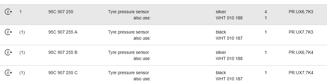

Eventually, this week I had my J1.1 winter wheels fitted with TPMS valves which work with the J1.2.
(With all the things wrong with a Taycan, why did Porsche dick about with something which worked perfectly and change the TPMS frequency!)
I contemplated buying a set of valves from Amazon and getting the local tyre place to fit them, but getting the correct part seemed to confuse many sellers who lacked product compatibility knowledge.
If you need TPMS valves for a J1.2, the part number is shown below.
1. It's insane to pay 3-5x the price buying them from Porsche in a Porsche box. When the same manufacturer can be bought online for a fraction of the cost.
2. There are four different sensors on the facelift:
Porsche Taycan How good is your Taycan at winter? 1769188358996-yk
7K3 is 433 Mhz, 7K4 is 315 Mhz. The other difference is the color.
USA and Europe should always have the 433Mhz.
