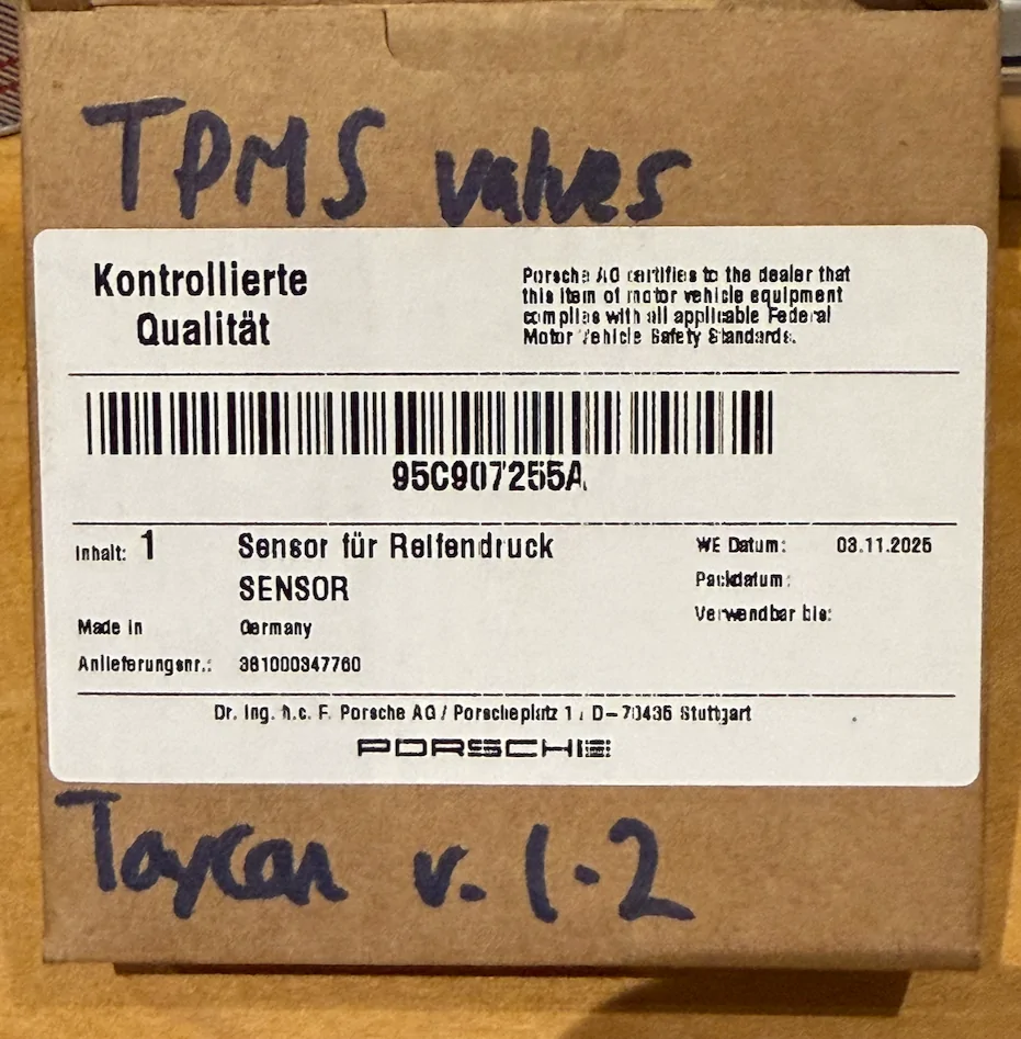

ct4s
ct4s
Bob
Jan 17, 2024
327
229
ST 4S
Eventually, this week I had my J1.1 winter wheels fitted with TPMS valves which work with the J1.2.
(With all the things wrong with a Taycan, why did Porsche dick about with something which worked perfectly and change the TPMS frequency!)
I contemplated buying a set of valves from Amazon and getting the local tyre place to fit them, but getting the correct part seemed to confuse many sellers who lacked product compatibility knowledge.
If you need TPMS valves for a J1.2, the part number is shown below.
Porsche Taycan How good is your Taycan at winter? tpms
