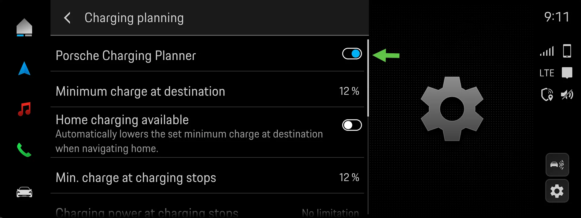

Switch what on or off?
PIRM:
NAV --> Settings --> Charging Planning
Porsche Taycan How to use charging timers 1777893317110-st
Then adjust your % for minimum charge at destination or charging stops as necessary.

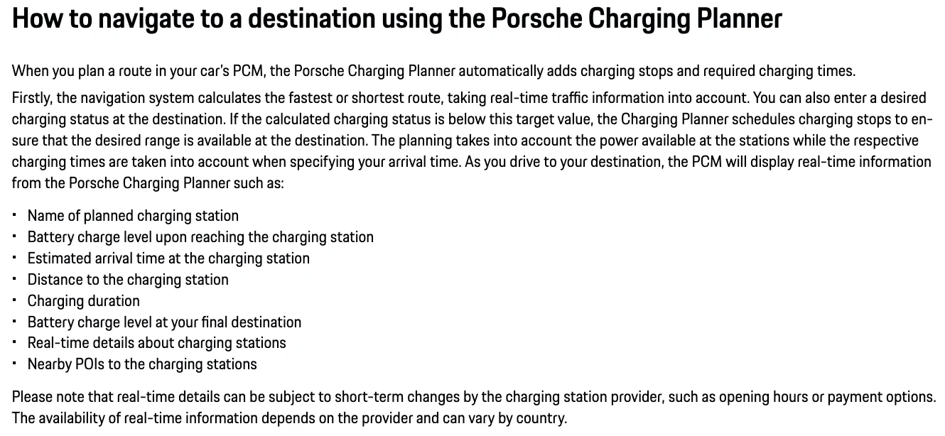

You must have the the EVSE selected as your stopover location OR in this case selected by Porsche Charging Planner. Two scenarios are possible.
The fact that your battery was reporting 43C then it was preconditioned - 32C is what I would normally see (sometimes higher) but as you've heard from others they have also experienced higher numbers.
In summary, you don't have an issue, your battery preconditioned on the expectation of charging from a low state of charge at the recommended EVSE based on your minimum charge at destination setting (15%), you opted to ignore, got home, the end!
