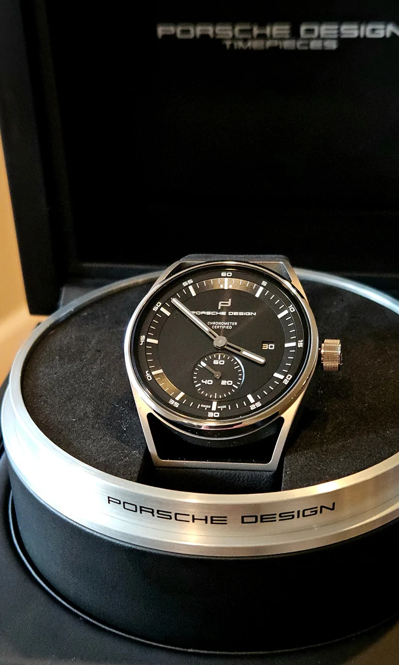

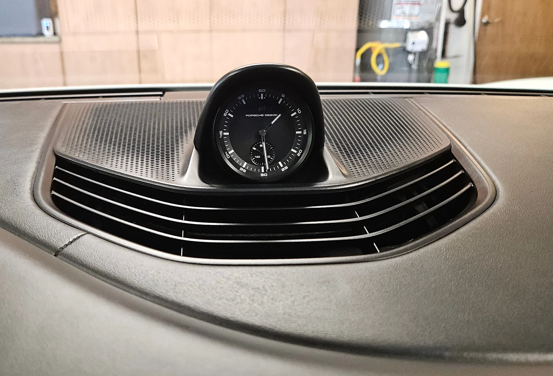

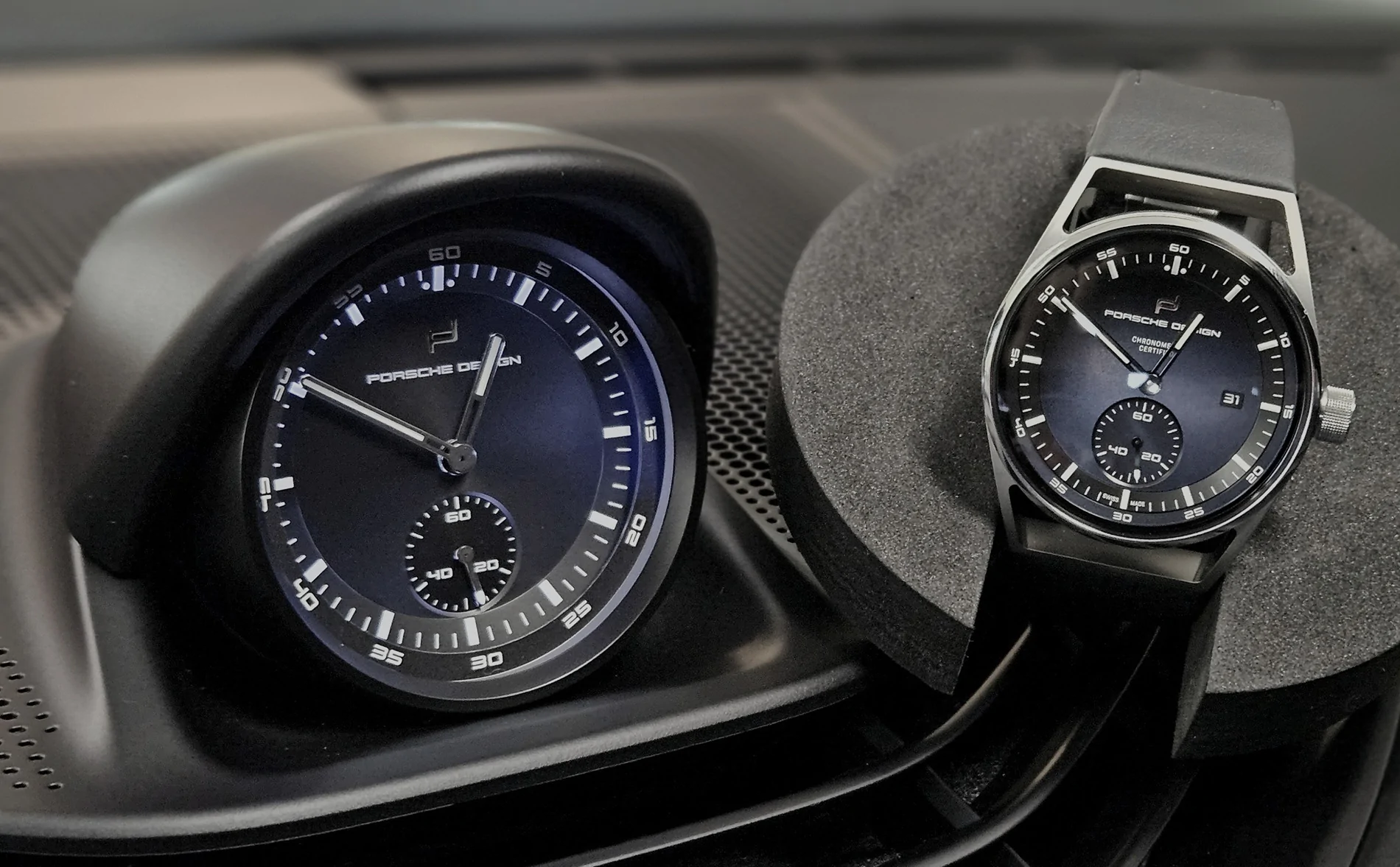

Ah, a little over the top perhaps :) ... but I happened upon a nice pre-owned Porsche design subsecond 42mm watch that exactly matches the clock in the car, and I could not resist :cool:
Porsche Taycan Install Porsche design sub-second clock 20251031_125027
Porsche Taycan Install Porsche design sub-second clock 20251030_155149
(The watch is nice and well-made, but I personally wouldn't pay new price for it)

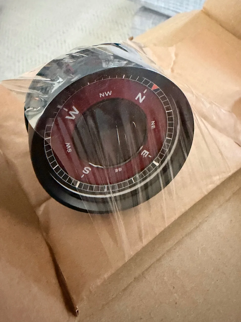

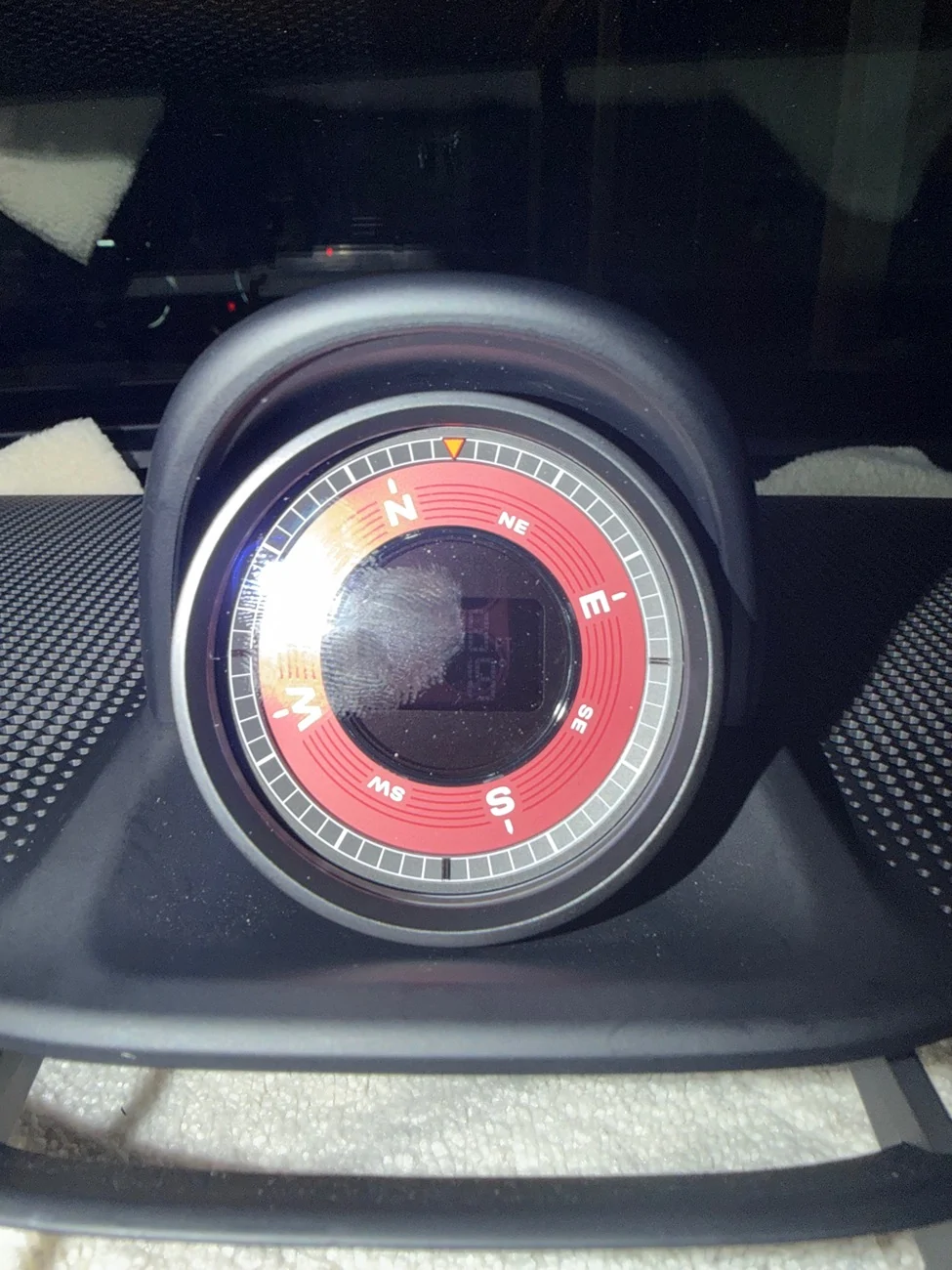

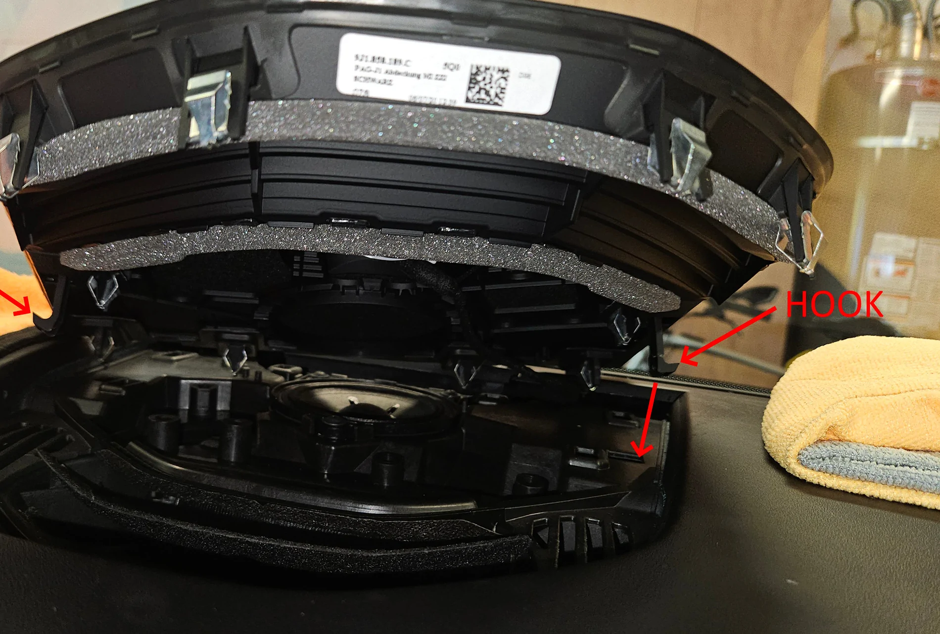

For future people upgrading their clocks to compasses. This is a 2025, and it was more difficult than I hoped, but exactly what I should have expected.
Part 9J0-919-107-AE-OG6 from suncoast. This is “Bordeaux red” and it matches my seat belts, but not the cluster (that’s default gray/black). Cost was $820 and shipped from Germany to Midwest US for $125. Just over $1,000 w tax.
Porsche Taycan Install Porsche design sub-second clock IMG_2730

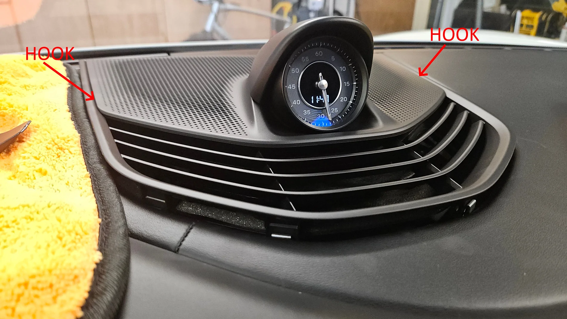

Use spudgers to pop all the retaining pins around the large part in the center. The rear retaining clips are the most difficult. Just put the spudger/plastic pry bar deep at an angle for leverage. Take care not to damage your dashboard.
Before you do anything else, prep a large piece of cardboard to protect the upper dash. The metal retaining clips are pointy and can dent the material. Ask me how I know.
Porsche Taycan Install Porsche design sub-second clock IMG_2731

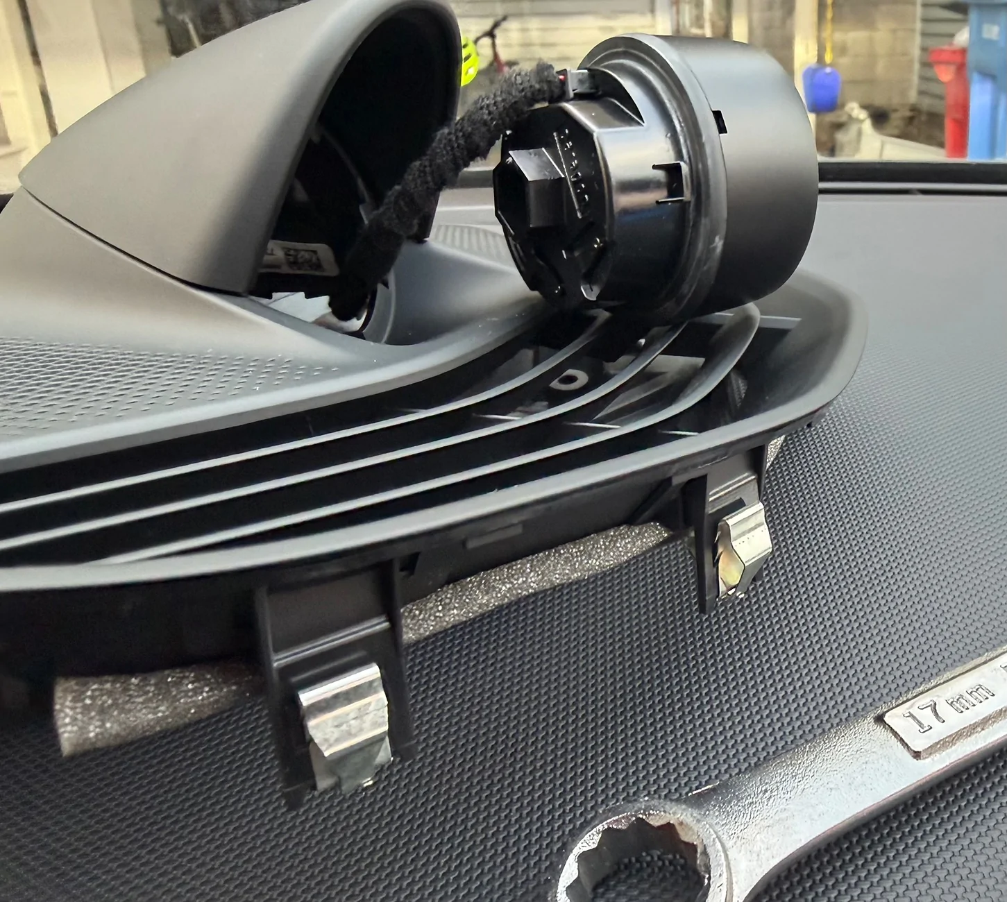

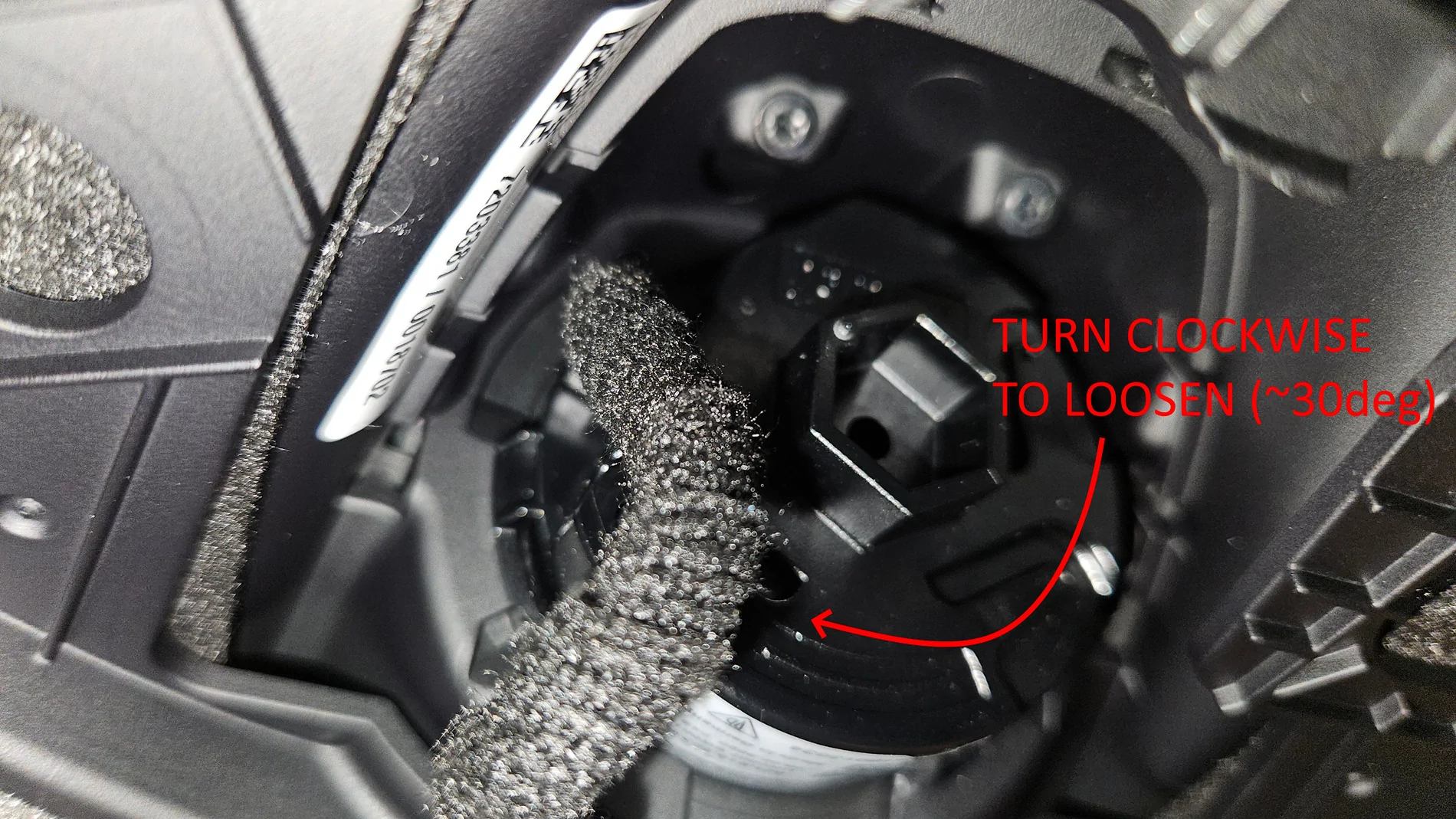

Use a 17mm wrench to gently rotate ccw, opposite of indicated arrow on rear of clock. Once turned 20 degrees it will slide out front.

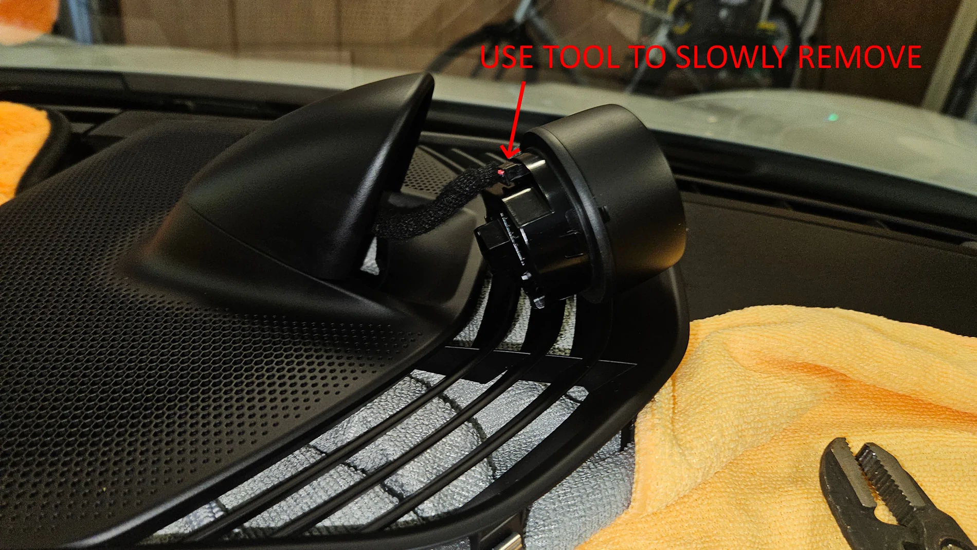

I’m sure there’s a way to disconnect the 3 pin harness but I couldn’t figure it out. Instead, I turned the face of the clock ccw until it clicked and the glass came off. You can then carefully wiggle the assembly from the plastic housing. The only thing holding it in is the friction of the 3 pins. Once out, you can access the interior tab holding the wiring harness in. Poke it and gently wiggle. It should come free. It took more poking force than expected.
Reminder: careful with the dash!
Plug the compass in and note the UP triangle. When you plug it in, the compass will orient so be careful that you know what way up is. Insert and seat it about 20 degrees ccw and then carefully put the 17mm to work, get fully seated, perhaps use a detail towel to hold it firmly and give it a clockwise twist until triangle straight up.
Porsche Taycan Install Porsche design sub-second clock IMG_2738

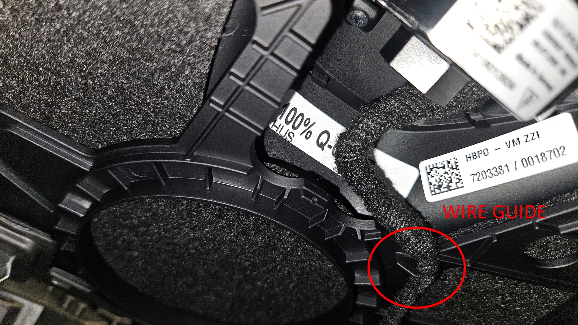

Push the thicker ends of cable back down below dash and into compass
assembly, press skinny part of wire into channel on the bottom (of the top part you’re holding). Note clip locations and align, push back down.
You should be done.
