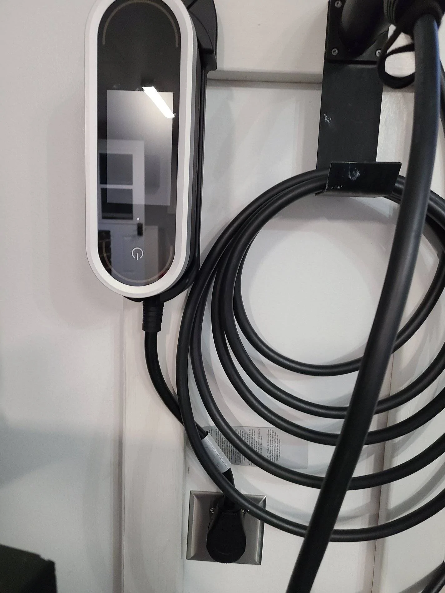

I actually had it flipped with ground at 6 o'clock so I don't have to bend the cable. My outlet was closer to the floor so PMCC had to be above it. PMCC is upside down but that is not a problem since the info on screen is useless.
In my opinion the best insrallation is with the outlet installed about 14 inch higher than the top of PMCC and ground at 12 o'clock.

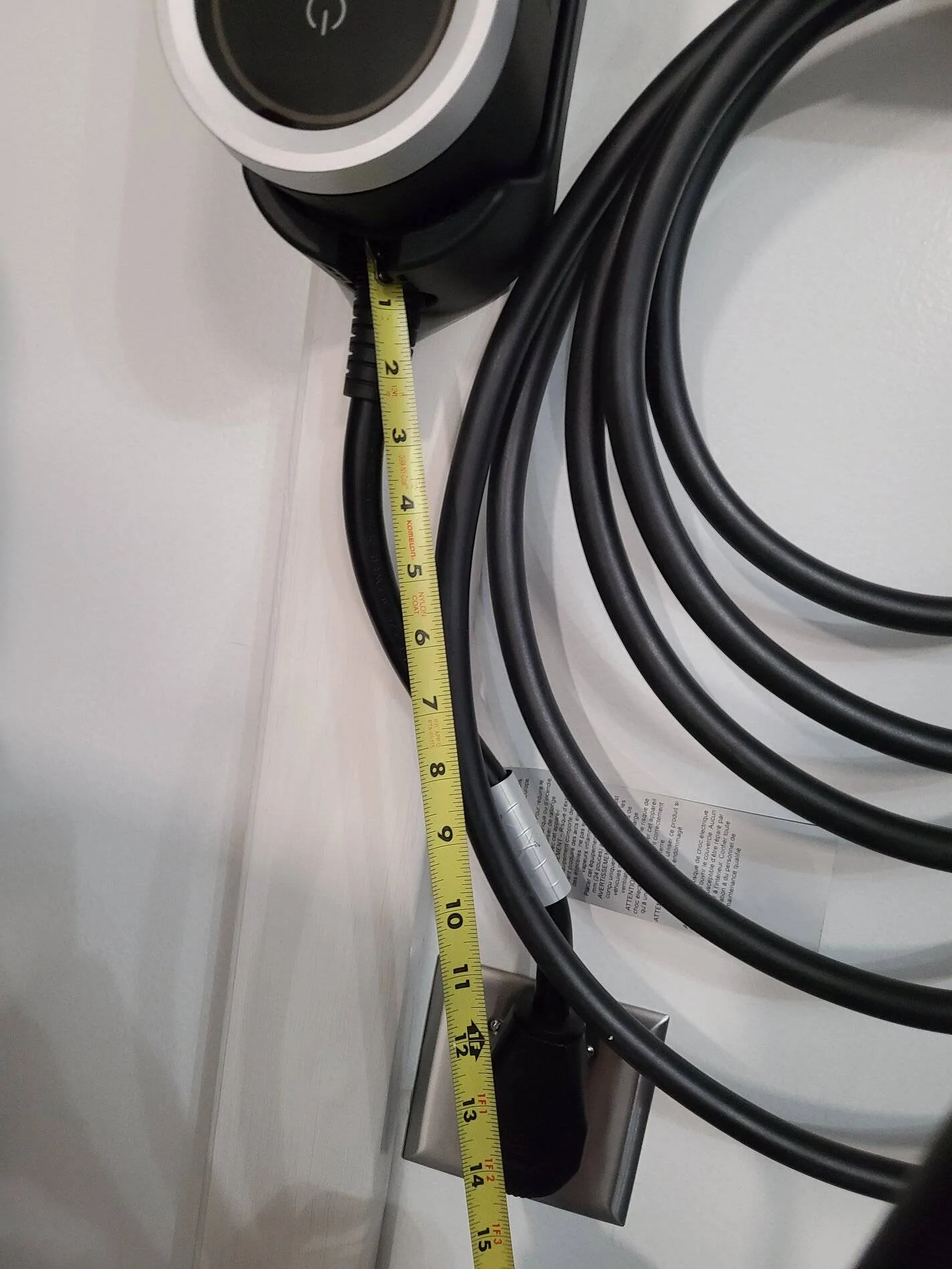

I also attach a picture with a tape measure so you can get an idea how long the supply cable is.

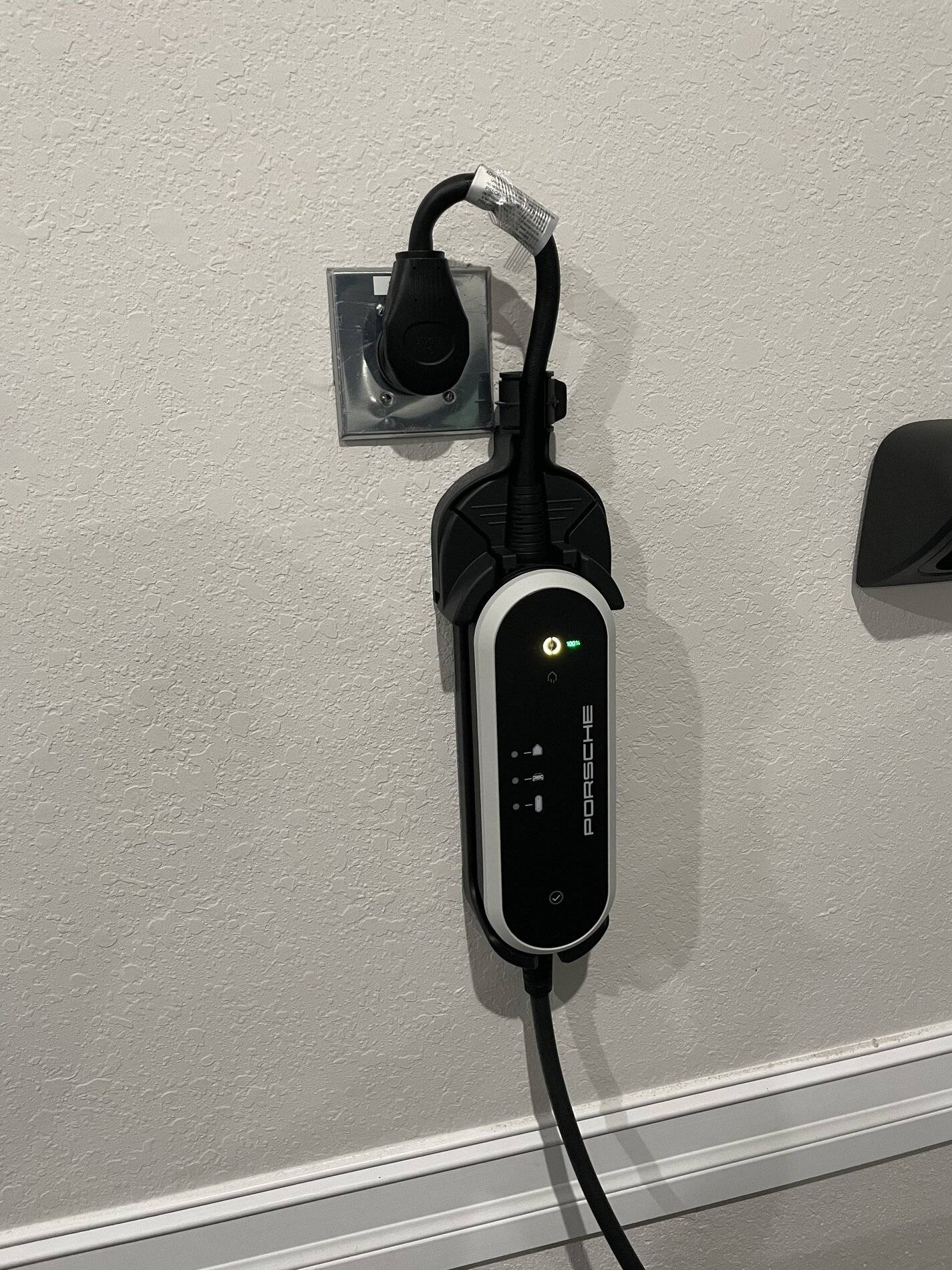

Here’s my charger with the bend - for reference ? I’ll be picking up a cabinet too

I did not want to have mine hanging so close to the floor to avoid my kid breaking it with the bike. That is why it is installed above the outlet and it is upside down.
