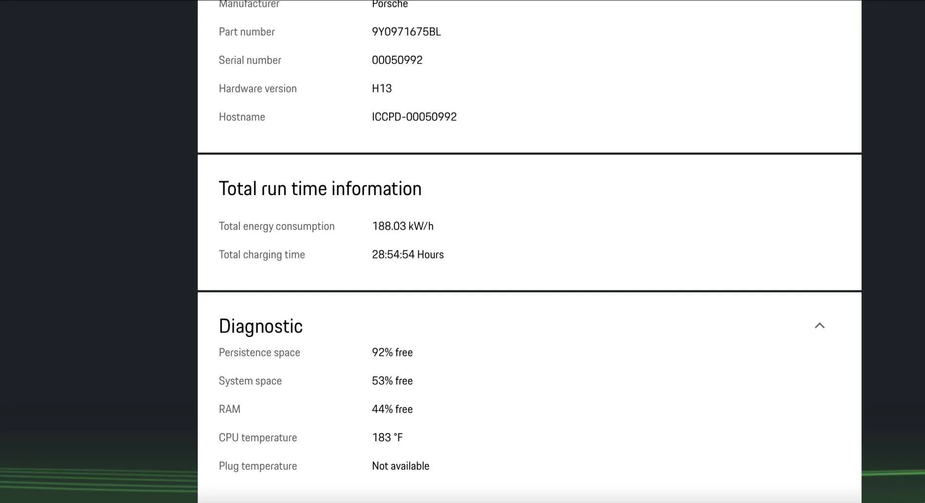

My internal CPU temperature is 183 degrees. Is this too hot?

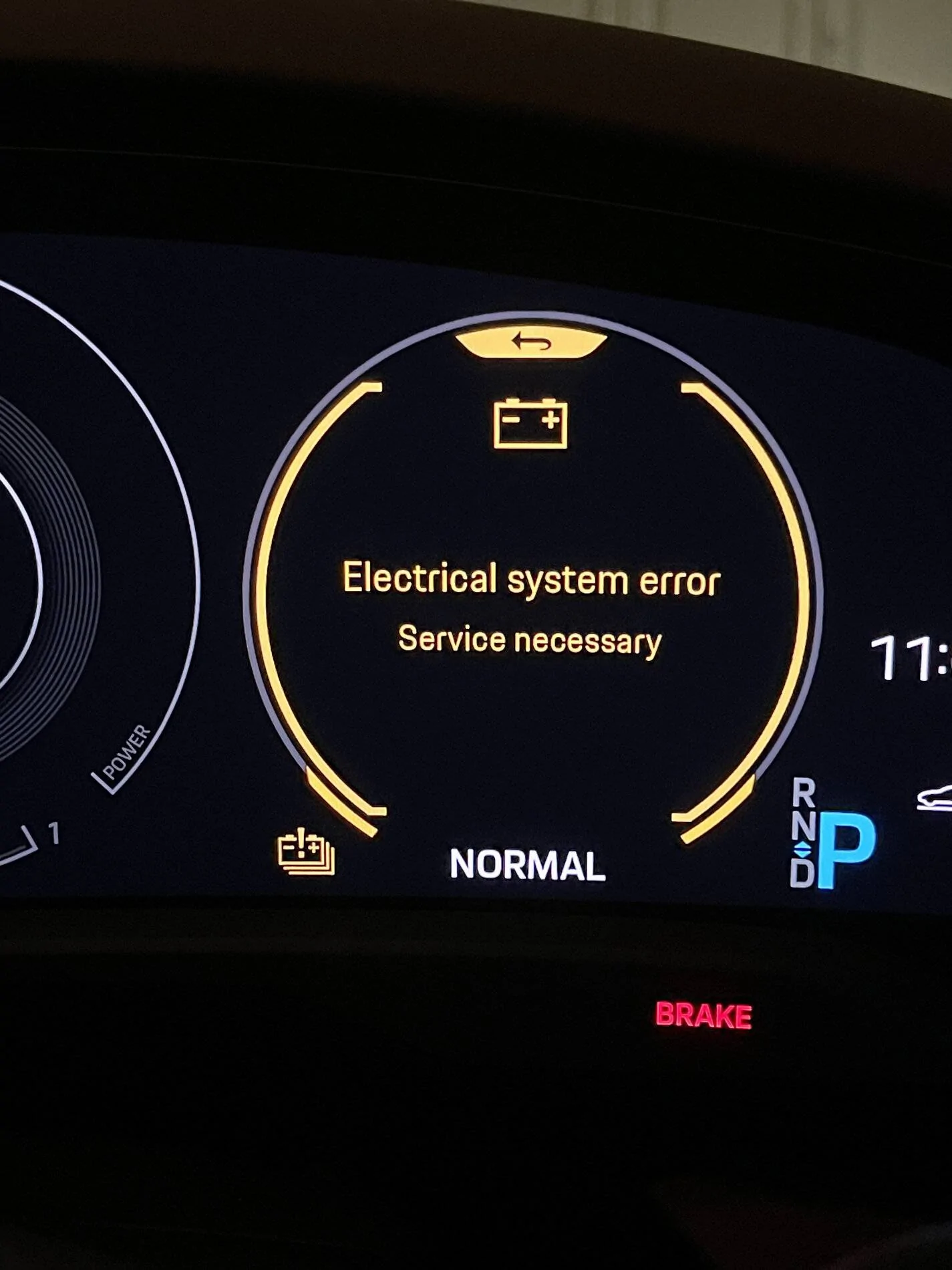

84°C is no problem at all for a CPU.

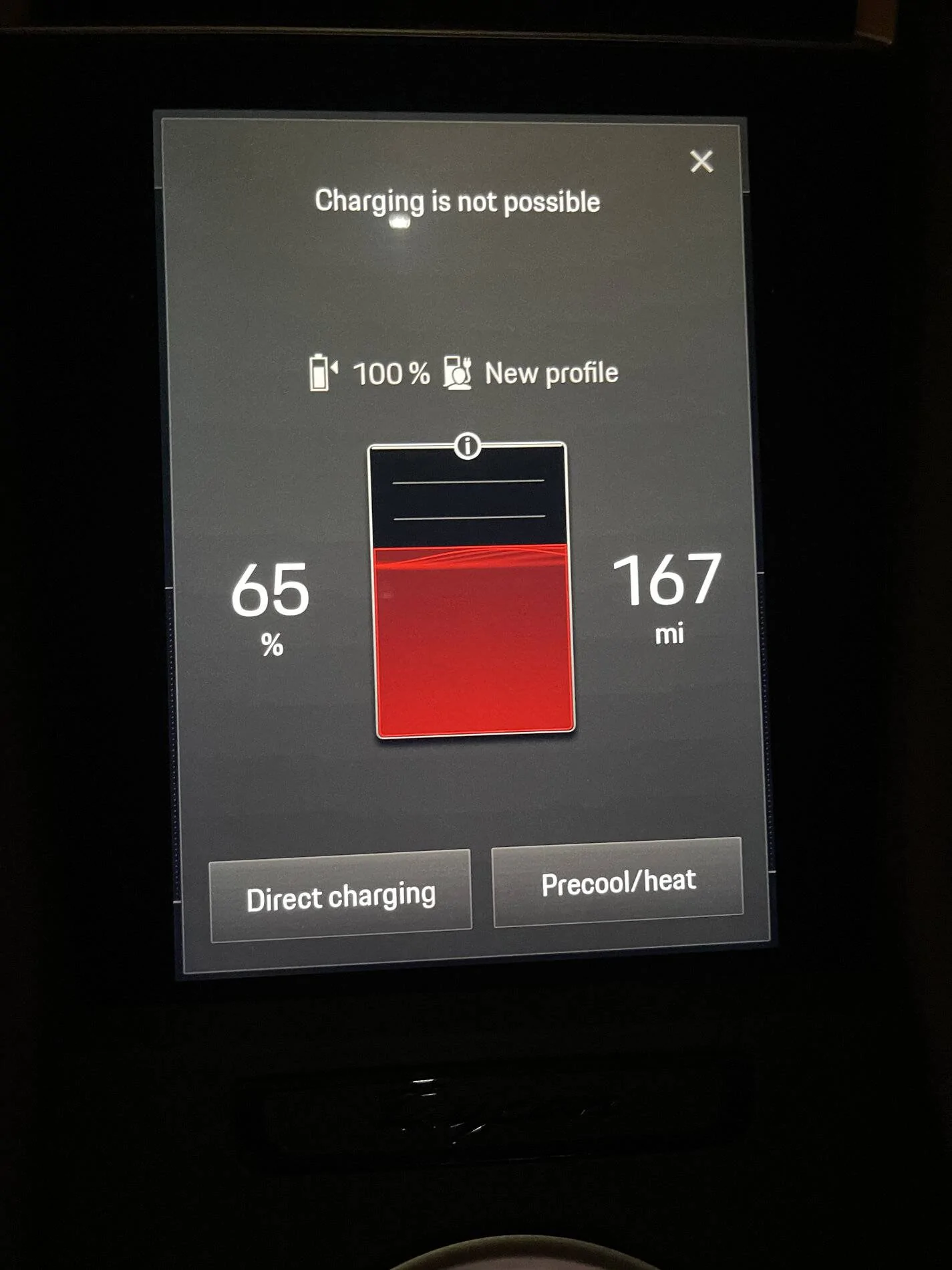

The body of the unit got so hot, I was concerned about leaving it on and potentially causing a fire.
Then this happened.
Porsche Taycan NEMA 14-50 Supply cable heat data Error Messag
Porsche Taycan NEMA 14-50 Supply cable heat data Some 3 hours later
I see, hot to the touch or did you measure the temp?
Did you try to switch off the car/charger. Could get the charging going?
LovinTaycan
Feb 24, 2020
211
105
Austin, Texas
2021 Porsche Taycan and 2019 Mercedes S560V
I switched it off for an hour, and then overnight and in the morning, nothing was different. The error warning was still there and the car could not be charged.
It was very hot to the touch, I did not measure the temperature at the surface.

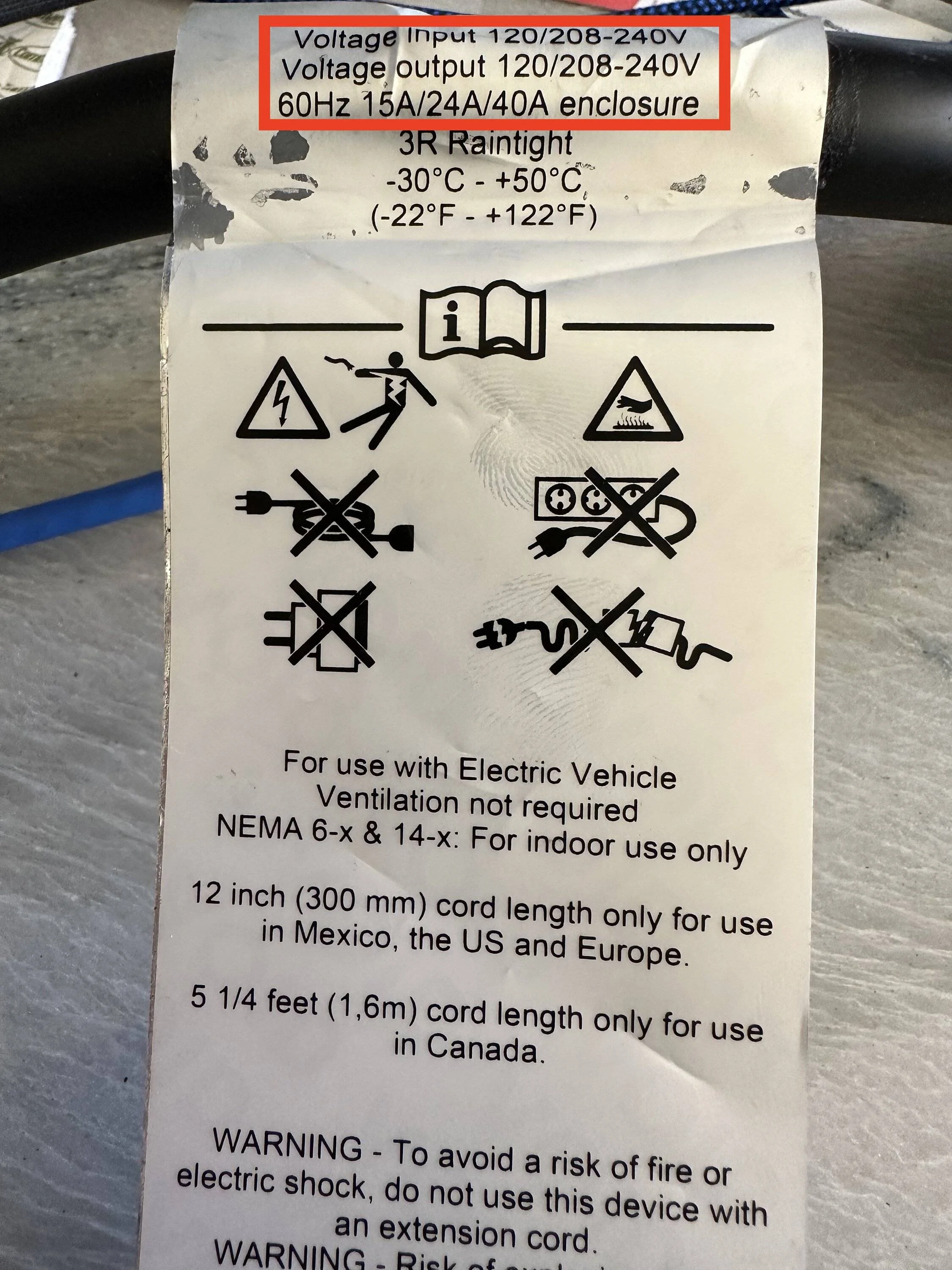

193
7,026
10,510
Picture below is from a PMCC unit delivery in April of 2021 with my 2021 Cayenne eHybrid - compare to picture in post #3 - label now states cable is rated for 15A/24A/40A usage - but is still 10 AWG wire according to embossed ratings on the wire insulation surface…
Porsche Taycan NEMA 14-50 Supply cable heat data IMG_0361

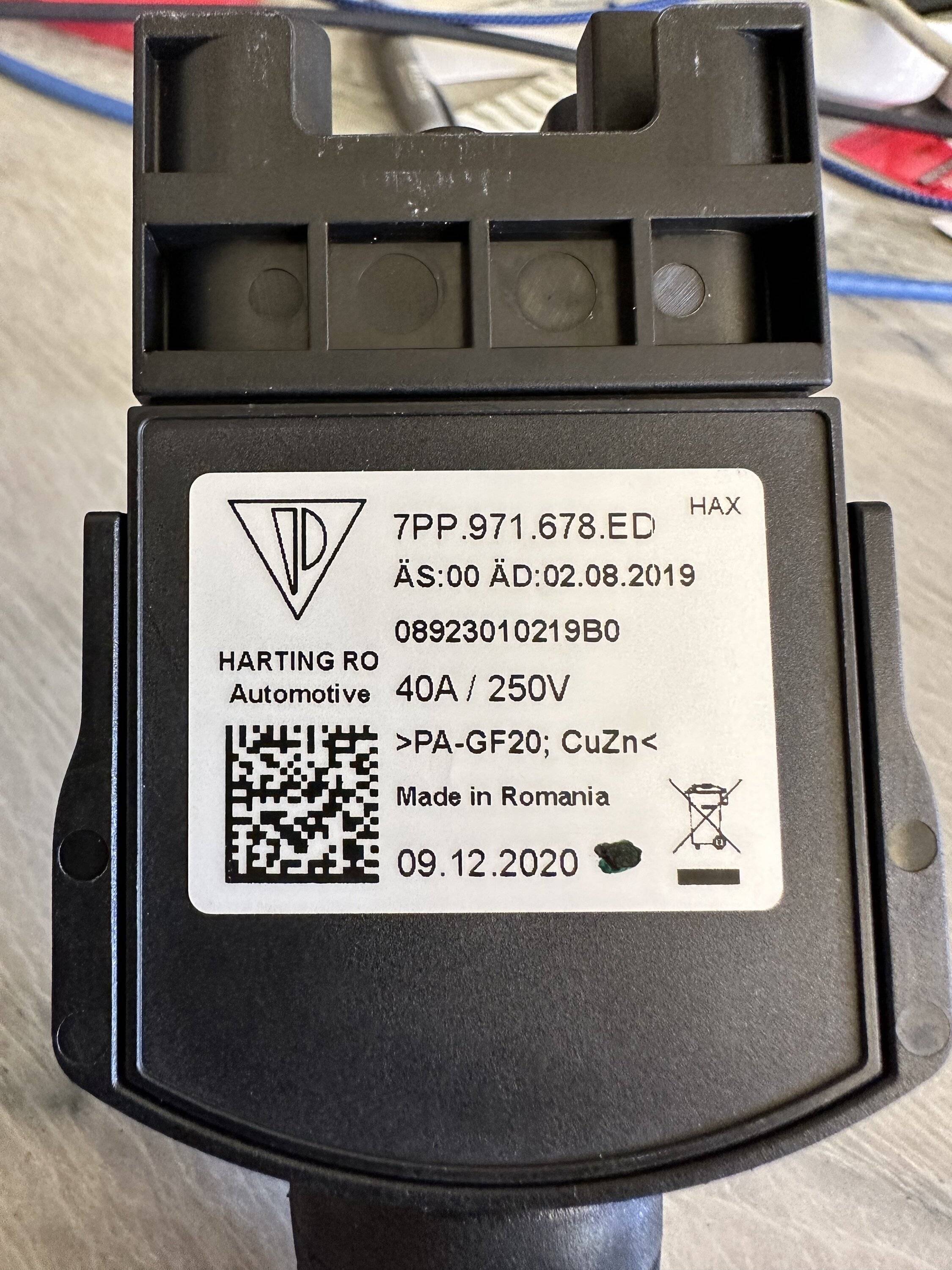

193
7,026
10,510
porsche clearly label this cable as providing 40 amps - and I'm going to guess it was made in Sept. of 2020 (my Cayenne was delivered in April of 2021 so this would track for manufacturing lead times)
Porsche Taycan NEMA 14-50 Supply cable heat data IMG_0362

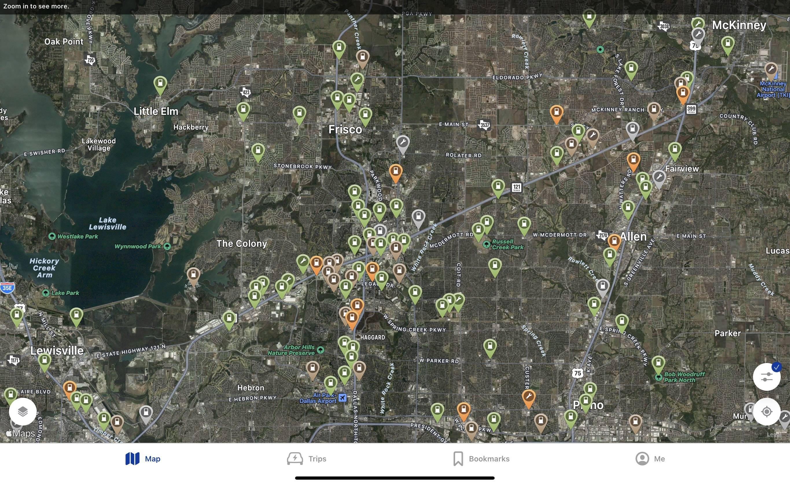

Daveo4EV, Do you have any updates on Porsche’s possible solution other than reducing the charging power from 100% to 50%. I spoke to my dealer’s service manager about upgrading to the Clipper Creek or the Tesla unit that you recommended. I was told that using a charger other than a Porsche or Electrify America home charger would void our Taycan’s battery warranty. To your knowledge, is this true? Thanks
here is plugshare for Allen Texas - take this screen shot into yoru Dealer and ask them which of the charger's listed you're allowed to use just to make sure…I'm pretty sure none of these EVSE's are Porsche EVSE's - so your dealer is saying you (and all other Taycan and by induction future Macan EV owners) can not use _ANY_ of the charger's listed for all of Allen Texas…
get a list of allowed charging locations from your dealership that will not void the warranty - for non DC fast cahrging - which hotels, restaurants, malls, golf course, airports, car service shops, govt. rest stop (caltrans in california has serveral rest stop eVSE's) - and where in canada you're allowed to charge your vehicle?
