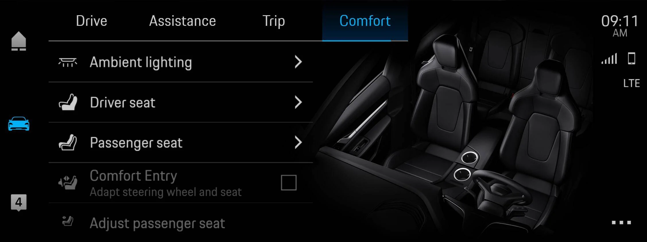

Curious about the memory issue - all Comfort settings enabled in PCM?

To be honest I’d got to the point I’d assumed the car doesn’t have key memory so perhaps I’ll reset and start again. Dealer just said ‘it should work’ but the screens keep flickering and occasionally hang completely so o was going to raise it when it goes in for the seat issue.

Memory pack is standard with the 14 / 18 way seats which you will have so my guess is that something hasn't been enabled - there are many options not mention pressing the memory key on the door (press Set then choose 1,2 or 3) and that you have logged into the car (suggest auto login rather than prompting for your PIN code)

Many thanks,

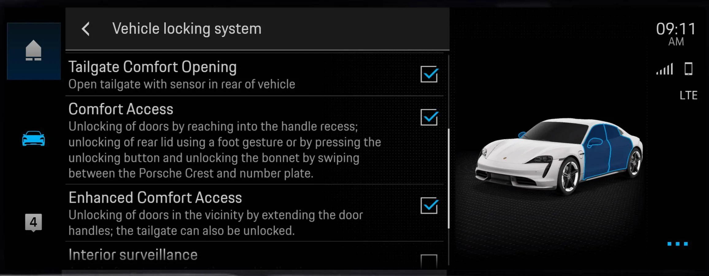

Yes I have all that however its the function where it remembers by the specific key (ie. my seat/climate is different to my partner's). When I unlock the car the seat stays in her position and the climate is HOT :)
I suspect it's a software thing as sometimes the memory on the door buttons isn't recalled first time.
I'll see what the dealer says....

Ok - I get this sometimes and generally if | don't use the key to unlock (use comfort opening instead). Using the key (button) generally forces the settings to be reloaded rather than pick up from last user.
I suspect its a "feature" and poor programming - hey it's a Porsche, we expect no less!
