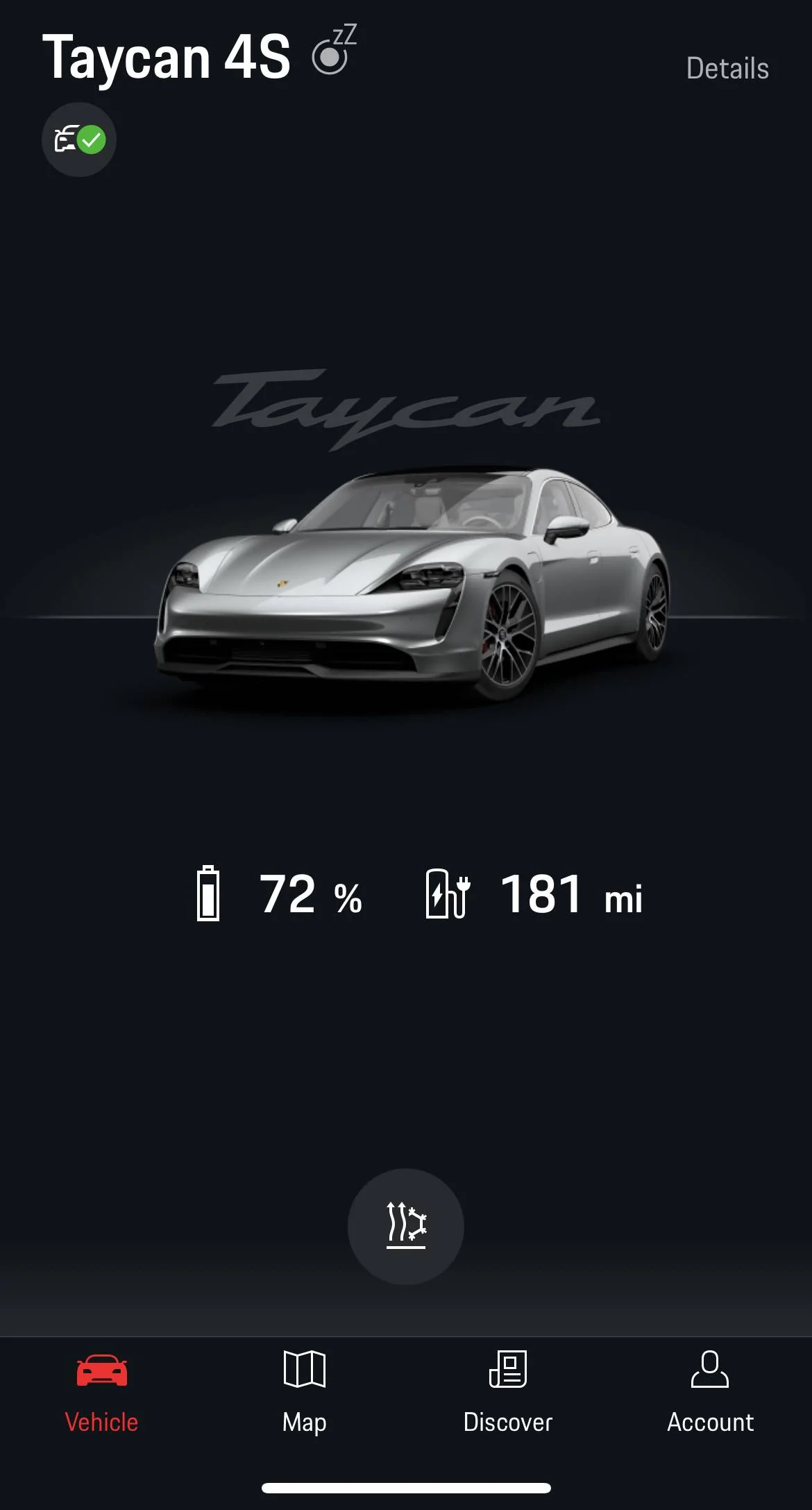

My 4S+ happens to be at 72% right now haha. Normal + AC.
Porsche Taycan Is the Taycan really exceeding EPA rating? 3C415177-0513-46BB-BCE8-FFEEA9F94102
My indicated range was lower for the first thousand or two miles and continued to creep up, I suspect you'll see the same. Definitely lower now in the cold weather, I saw over 300 multiple times in the summer in range mode at 100%.
