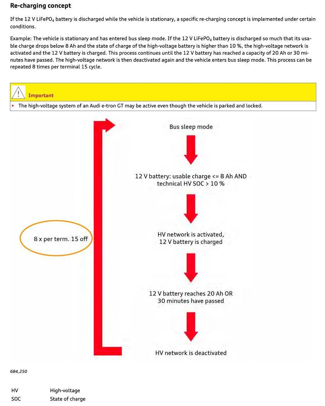

Yes switching on (Terminal 15 cycle) Taycan re-sets the 12 Volt charging system back to zero so it will then charge up to 8 half hour charging sessions. I have had this confirmed by Porsche.
The Taycan system works the same algorithm as the Etron (attached).
One of Porsche HV Technical experts confirmed “The Audi variant is identical to our Taycan’s.”
