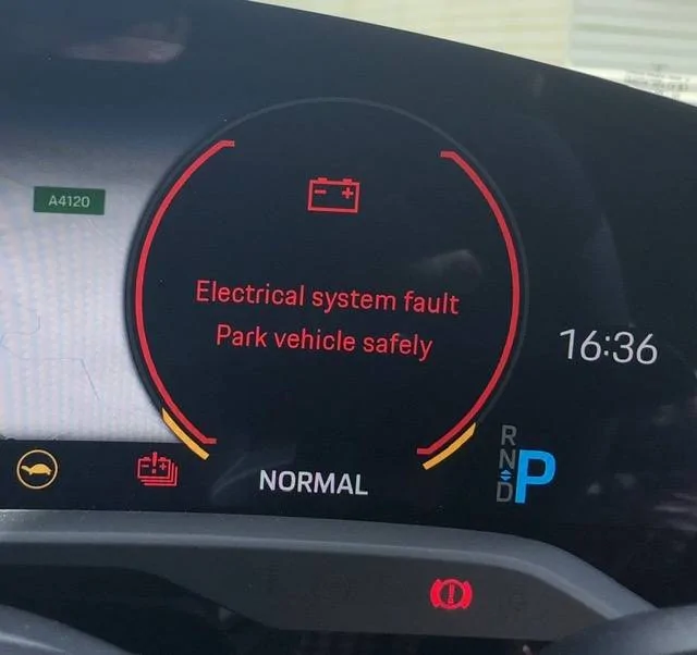

Sorry i see the same problem yesterday did you find any solution my car made it 2 times ?
Yes. This is the same issue that I have. Mine only happened after the software update. It does reset itself after 15 mins. Dealer did the DME patch software update. But this may not the be right fix. My car experienced the same error again after the fix. It is very random and so far, infrequent for me. Going back to dealer next week.
