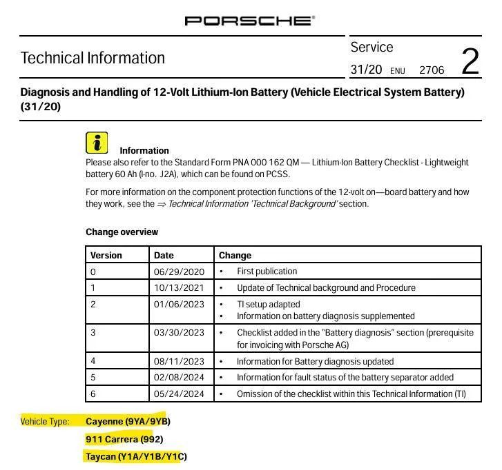

The recommendation has been in place since 2020. Below is the official Porsche documentation.
As for a good trickle charger look for a CTEK Lithium Charger. As long as the trickle charger is designed for Lithium charger, as the charging parameters are different from normal lead acid batteries
The document you attached is numbered 2003.1, and the original 2003 version is different.
Since your version is later, I find this paragraph interesting --

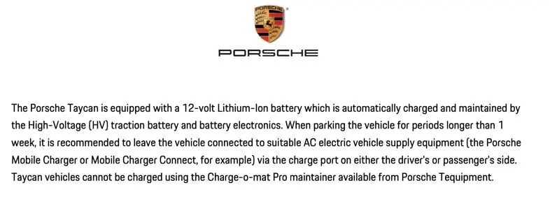

Note that they don't recommend a "maintainer" for the battery, but rather recommend the car be connected to an EVSE on one of the charge ports. So the attachment doesn't specifically mention a trickle charger, but the user's guide does. Weird.

I am not aware if there are any further updates to the ATI. If you look at the history it was issued and then withdrawn and the reissued. There was also a detailed description of the initial charging cycles in a manual for Audi, that highlighted the sequence of 8 cycles while the car stayed unused. I have no information about any new SW release if that 8 cycle limitation was revised later??

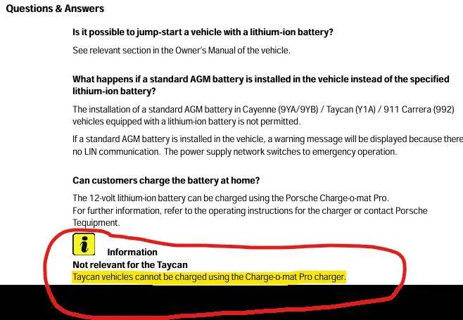

If you refer to this
Taycan vehicles cannot be charged using the Charge-o-mat Pro maintainer available from Porsche Tequipment.
that just emphasises the fact that the normal 12 volt battery maintainer for lead acid batteries will not work with the Taycan. It is designed for normal lead acid batteries! There are different charging parameters for Lithium batteries.

The last TSBs/ATIs that I can find at NHTSA about storing Taycans (dated March 2022) do not mention/advise using a trickle charger on the 12-volt battery. Dealers are advised to charge the 12-v battery every 8 weeks using a suitable Li charger. Nothing about "maintaining" with a trickle charger.
The current online owner manual version conflicts with TSB. Such is life.

I think that last remark – “cannot be charged” - refers to the inability of the Charge-o-mat Pro to charge a dead battery as opposed to using it for trickle charge.
Do you agree?
I think it probably means it won't charge the high-voltage drive battery, though I agree it's vague.
That said looking at the Tequipment website the Charge-o-mat Pro is not listed as compatible with any Taycan model.
Do you agree?
No. My interpretation is the "information is not relevant for the Taycan". It should have been reworded to say the following is my suggestion: The Charge-o-mat Pro can not be used to charge the Taycan PB/PB+ battery.
