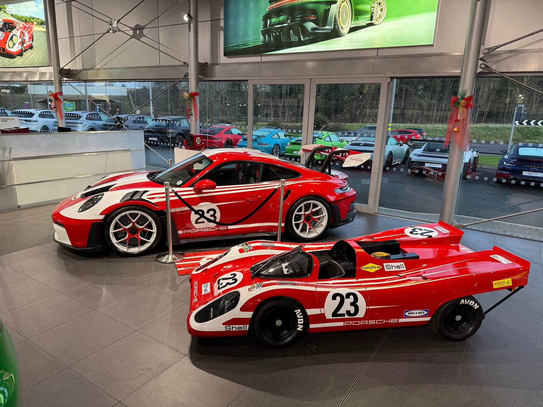

Sat in the dealership.
They can’t run diagnostics until Monday.
Courtesy car on its way from Enterprise - expecting a 1.0 Polo.
It drove fine to get here. When i stop it’s not fine.
It’s happily charging on the dealers DC charger, and when I arrived the LV Battery error had gone.
But interior light, comfort access etc still not working.

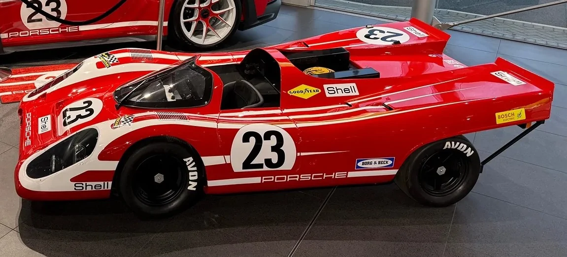

I’d be better off in this [rather awesome] child’s car :)

PS I didn't know they made a convertible version of the 917.....🤪
It's a lucky child who gets this for Christmas
