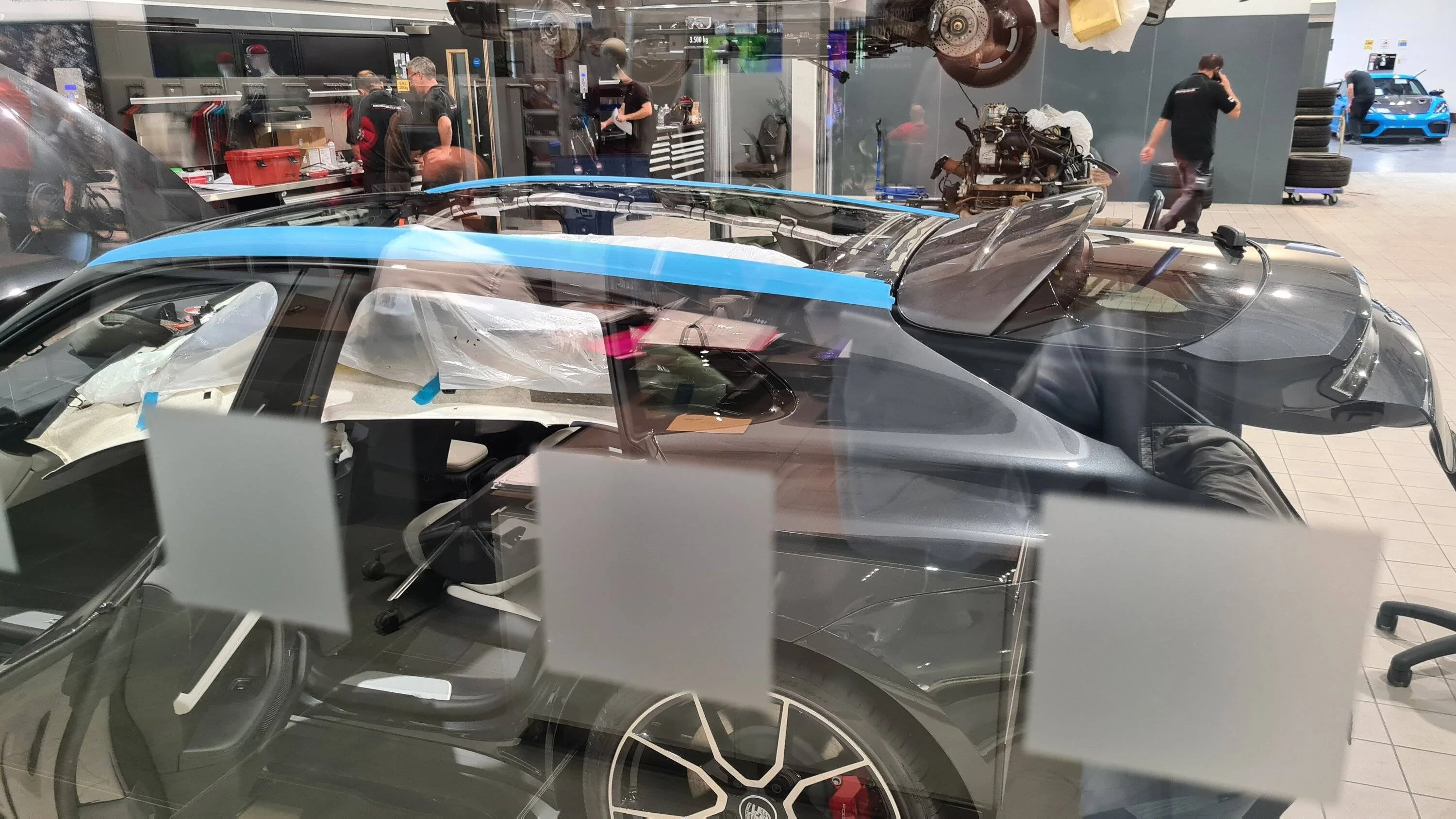

Don't know about the Sedan but not on a turismo
Porsche Taycan Lasted 9 days (Panoramic roof) 20220830_163718
