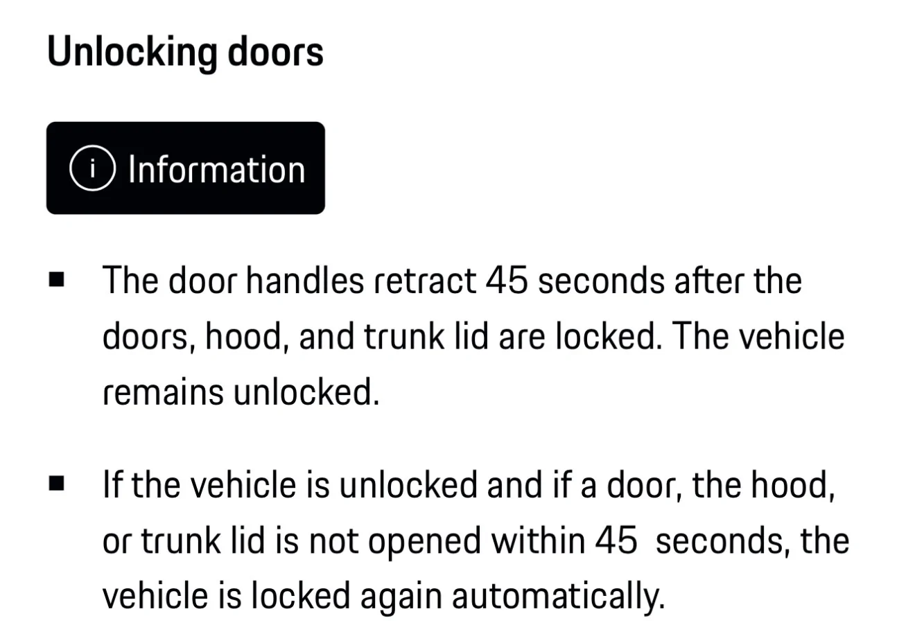

There is nothing in the manual on walk away locking but it does say this:
  • The door handles retract 45 seconds after the doors, hood, and trunk lid are locked. The vehicle remains unlocked.
  • If the vehicle is unlocked and if a door or the trunk is not opened within 45 seconds, the vehicle is locked again automatically.
In my manual, this section appears under the “Unlocking Car” section which tells me that with Comfort Access, if it senses you get near the car it unlocks itself, but if a door, frunk, or trunk are not opened then it locks itself back again.

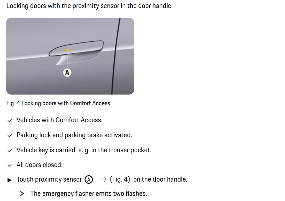

Sorry but my J1.1 definitely locks when I walk away. It's also stated in the manual. I don't know where you're getting your information but m 2021 locks every time I walk away!
SoccerMan94043
Nov 24, 2025
862
611
San Jose
2025 Taycan GTS

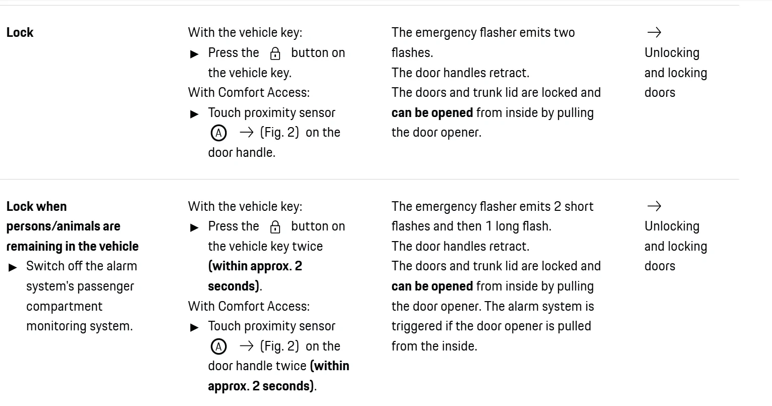

Post a link to the manual and a screen shot of what you describe.
Here is the later 2021 manual (not sure if this is exact for you): https://manual.porsche.com/#/wpi/Y1A-2021-20200504-37-NAR-2.0.2/en_US/main
Here is what I could find in your manual on this (it's the same as my 2025... no auto locking on walk away):
Porsche Taycan Locked key inside car brave_screenshot_manual.porsche.com
Porsche Taycan Locked key inside car brave_screenshot_manual.porsche.com (1)

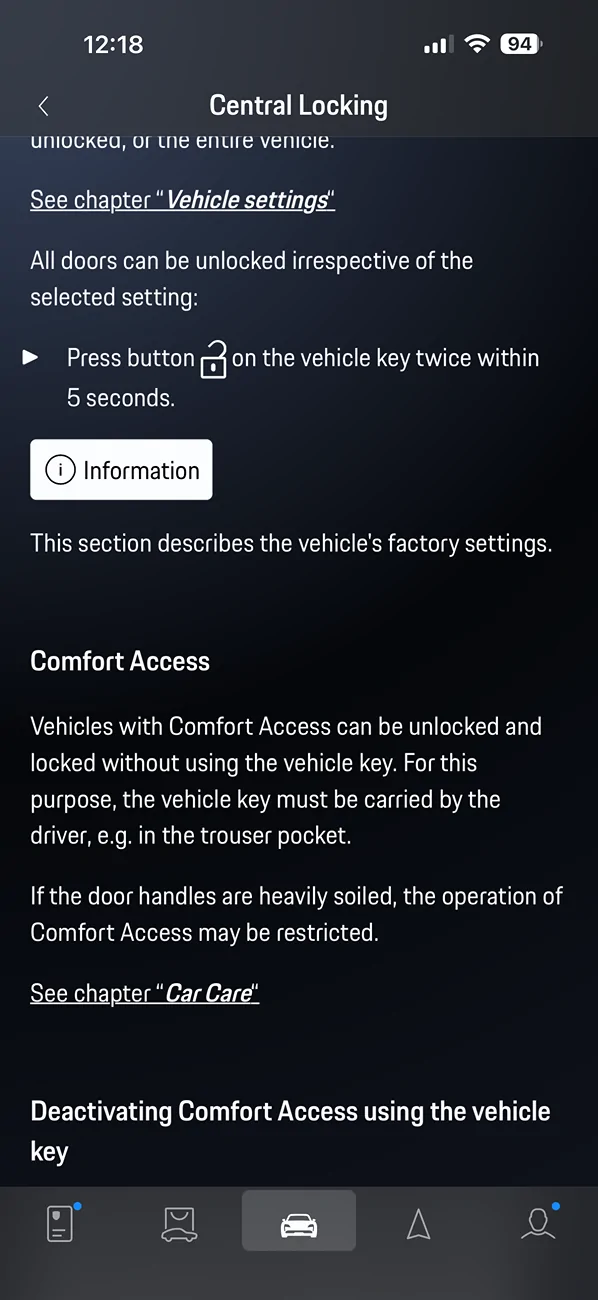

well maybe in Europe that feature doesn’t exist but here in the States it absolutely does
[/QUOTE
here is a screenshot from my Porsche Connect app quoting the manual. When I get a chance I’ll post pictures from my manual
Porsche Taycan Locked key inside car IMG_0560
