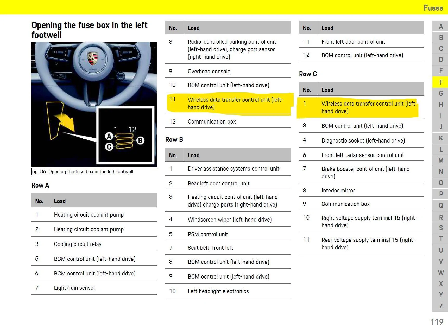

Jim
Dec 30, 2023
29
San Diego
2023 Turismo
I noticed the car was not updating/out of sync with my phone app for 2 days in a row when I first received my car. Then it started to work after several days. This past week it lost connection for 2 more days. I tried: pulling the fuse, 12 volt battery, "engineering reset", and ended up taking into the dealer. They "reset" my Verizon modem. Here's the kicker, the service adviser said Porsche is aware of the issue, and is working on it. But that Porsche doesn't have a permanent fix yet. SA was very helpful, but limited in what he can do for me. The app being out of sync with the car doesn't really bother me too much. I just really enjoy driving the car.
