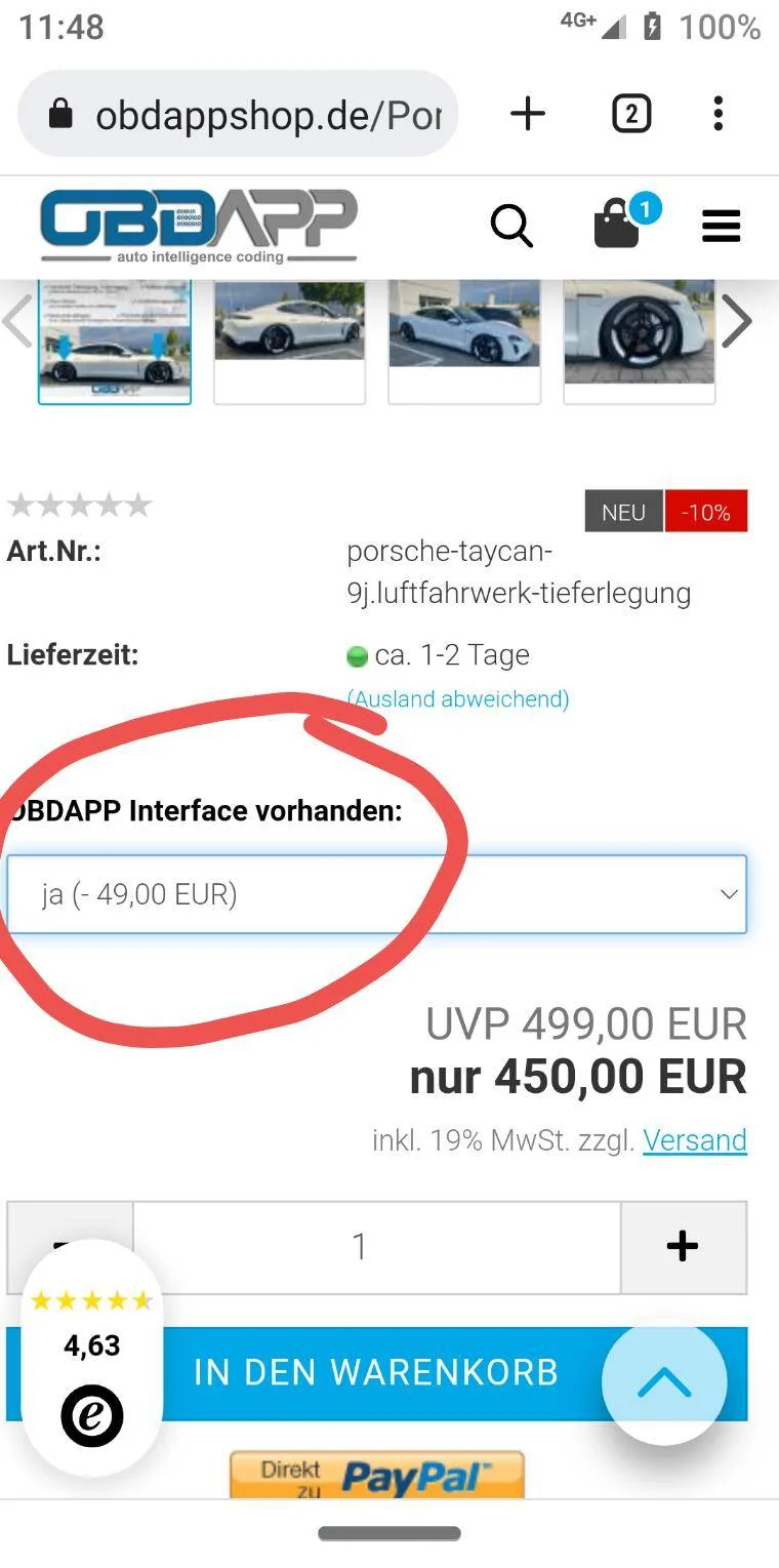

What does "OBDAPP interface available?" mean?
yeah thats right. You need an OBDAPP Interface to connect to the car. Later you can use it to get more functions or use the Standard / Service functions they have like i shared for battery query status or DTC section or what else you want. The dedicate function for lowering / adjusting the taycan you can buy in one shot or separate, thats this OBDAPP Interface available thing.

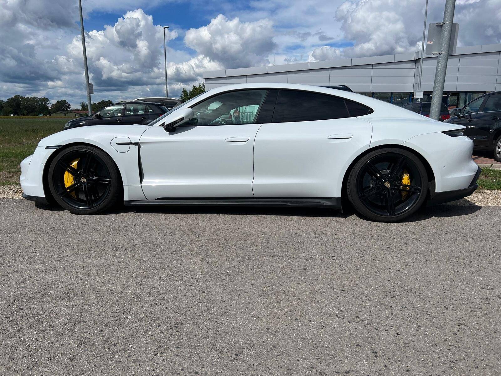

another great picture from an OBDAPP lowered Taycan Turbo S with yellow ceramcis, pretty nice posted in german pff forum

@taycanlovers what I still don't understand is what this means:
Porsche Taycan Lowering links? Screenshot_20220912-114938
What exactly is that OBD interface?
I already have an OBD adapter (Vgate Icar Pro and ELM327).
I also have the app installed so what am I paying for?
I mean the difference in €450 vs €499.
What exact hardware is needed?
Maybe you can illustrate this with actual pics.
Thanks in advance!
I'm highly interested in this but want to know what I'm buying (or don't need to buy).
