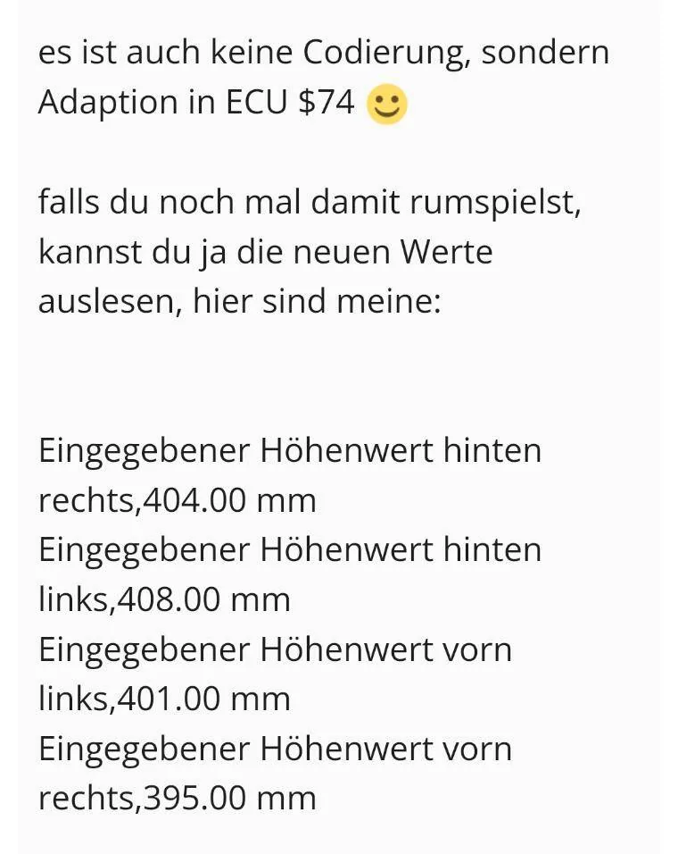

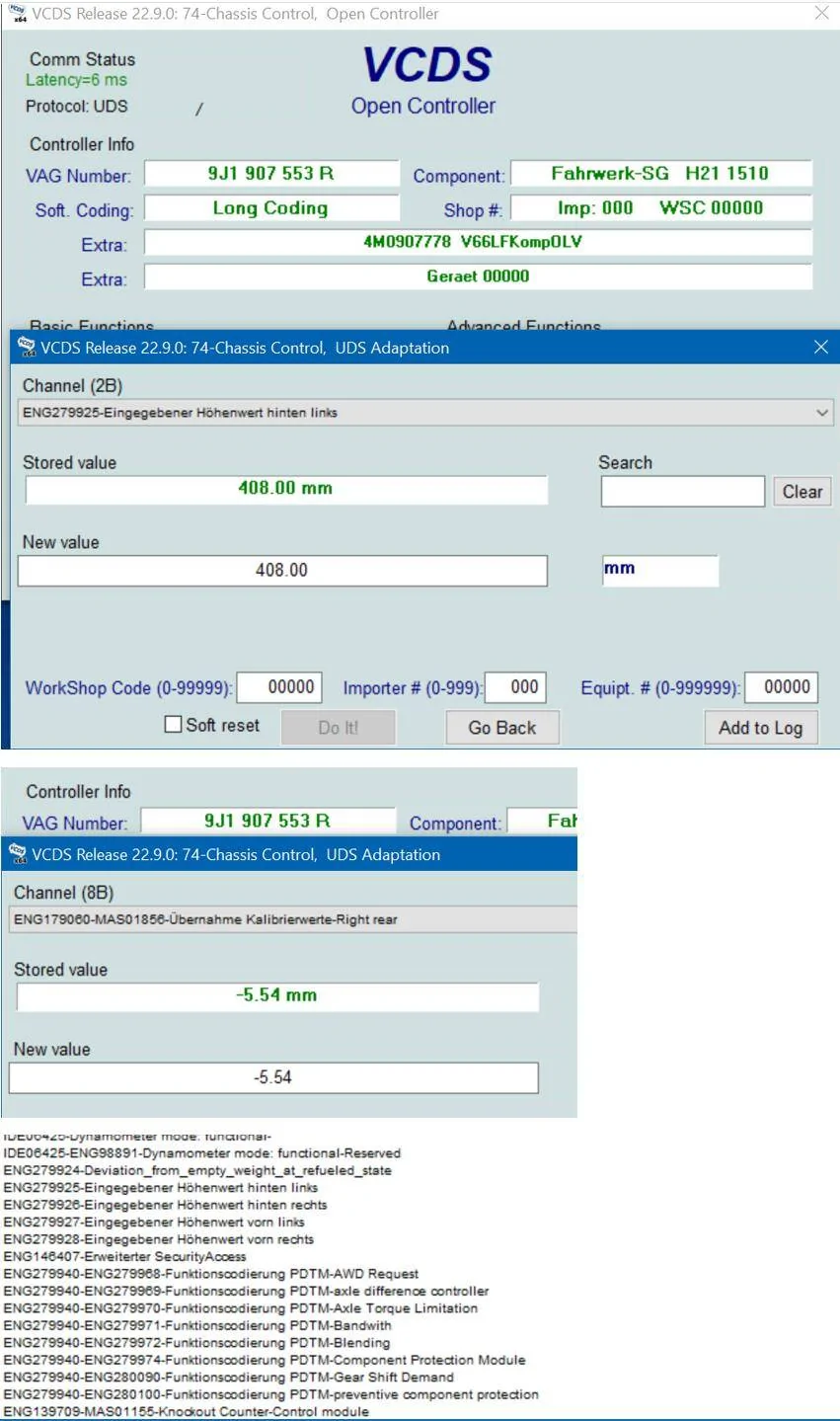

Oh and also because I know someone who did it already but that's just a small, unsignificant detail in this story.
Porsche Taycan Lowering links? Screenshot_20220915-160630
PS That $74 is not 74 dollar but unit 74Chassis Control Module.
I'm a quick student. ???

Thanks @Dee for looking into this! Based off your review, is this essentially the same thing as installing lowering links, but just software based? IE it just lowers every mode and the front axle lift by a set amount
Yes.
I'm only in the beginning of this proces so don't expect results soon.
All I know now it can be done but as with all experiments it must be checked and confirmed.
That takes time.
