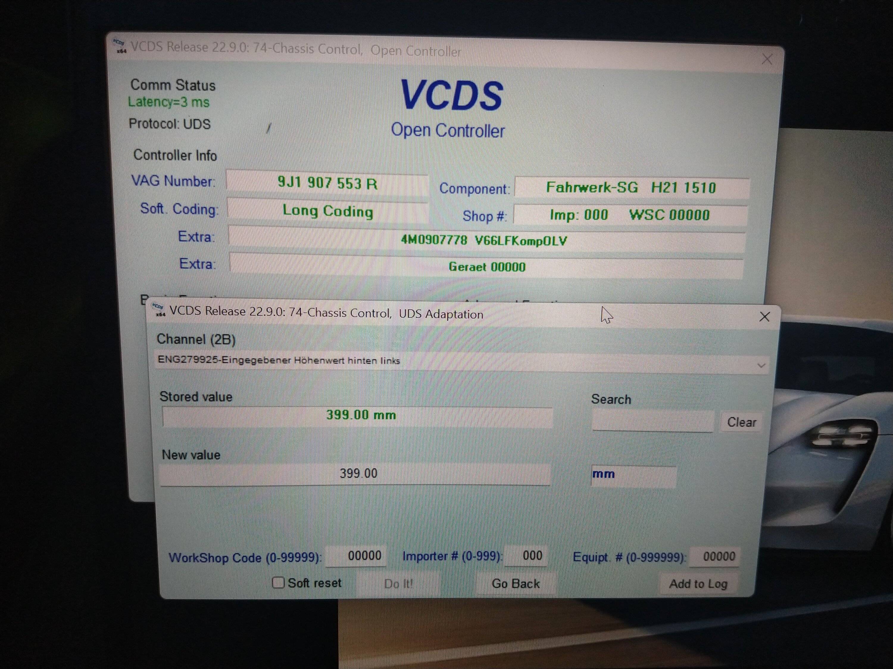

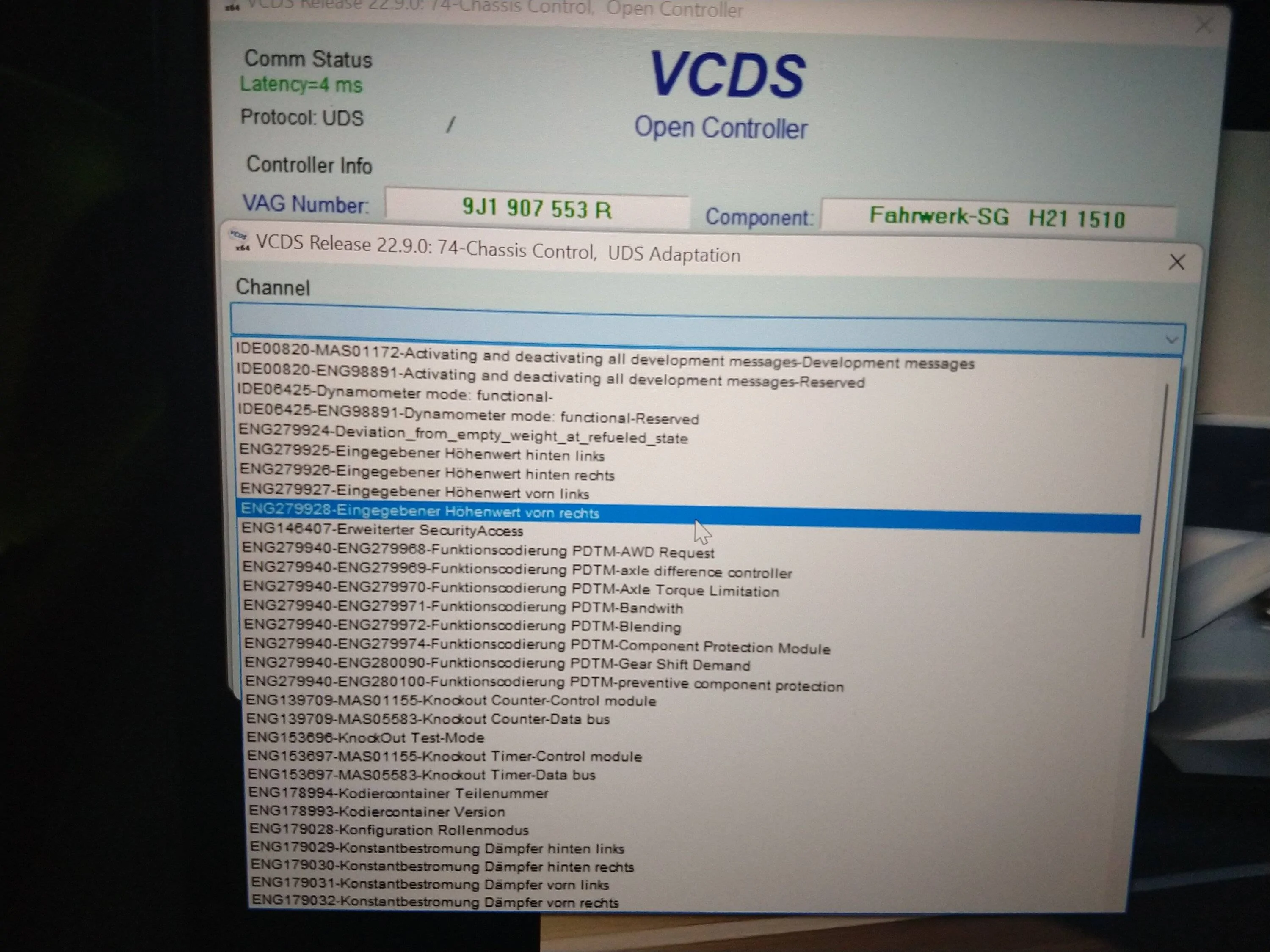

Today I connected the laptop to the car and start searching for the control module.
I found it:
Porsche Taycan Lowering links? IMG_20221004_122725879

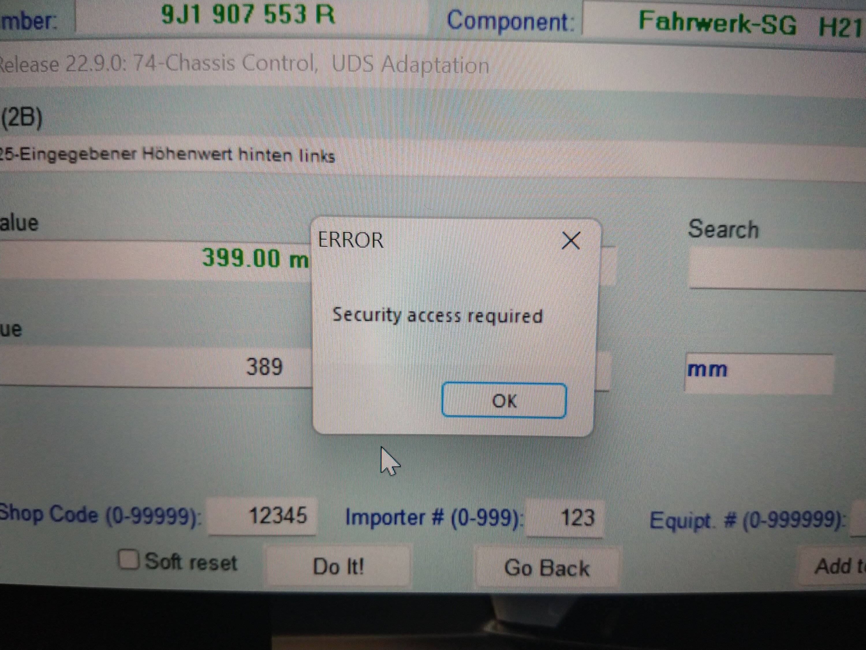

You can select the different channels (it's in German of course):
Porsche Taycan Lowering links? IMG_20221004_122817943
But unfortunately I can't change the value cuz the module is secured by a SA code (security access code):
Porsche Taycan Lowering links? IMG_20221004_124144035
Apparently the 12345 doesn't work, unfortunately.

I managed to make a full back-up of my car so that's succes #1.
And now the best part: I got the SA (not the WSC), that's the Security Access code: 24084, succes #2!
@taycanlovers : here's the proof, changed from 399 into 410mm. :giggle:
I can also bleed the dampers, it's all in there.
Porsche Taycan Lowering links? Schermafbeelding 2022-10-06 162616

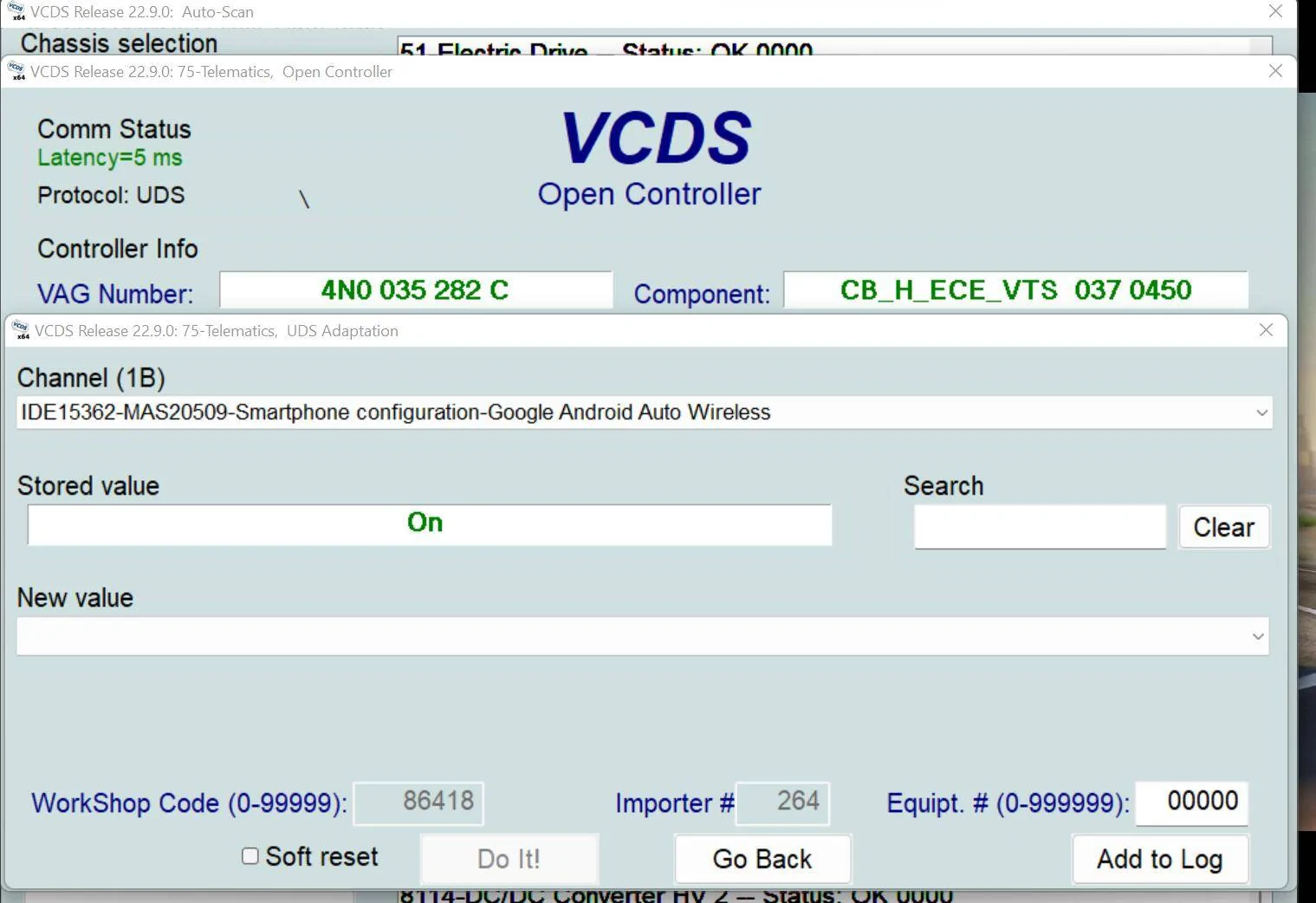

I also tried to switch on wireless Android Auto but no luck.
It just isn't there and doesn't work on MY20 cars.
Ah well, it was a good day. :rock:
Porsche Taycan Lowering links? Schermafbeelding 2022-10-06 151852
From the drop-down menu ("new value") you can select ON or OFF but it doesn't do anything.
I removed my old connection and made a new one, plugged it in (USB) but after unplugging it still didn't connect so I give up on that one.

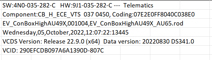

I come across many things, like the ConBox (Control module 75).

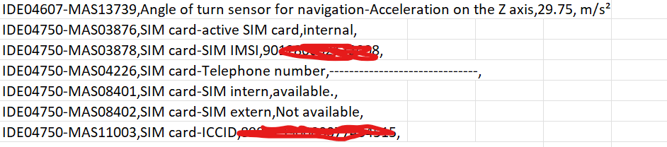

Porsche Taycan Lowering links? Schermafbeelding 2022-10-06 192925

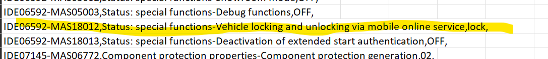

Here's the adaption of remote locking:
Porsche Taycan Lowering links? Schermafbeelding 2022-10-06 192253
Here's the actual number of the sim card (I think):
Porsche Taycan Lowering links? Schermafbeelding 2022-10-06 192819
Anyway, still haven't found what I'm looking for: the activation of the passenger display during driving.

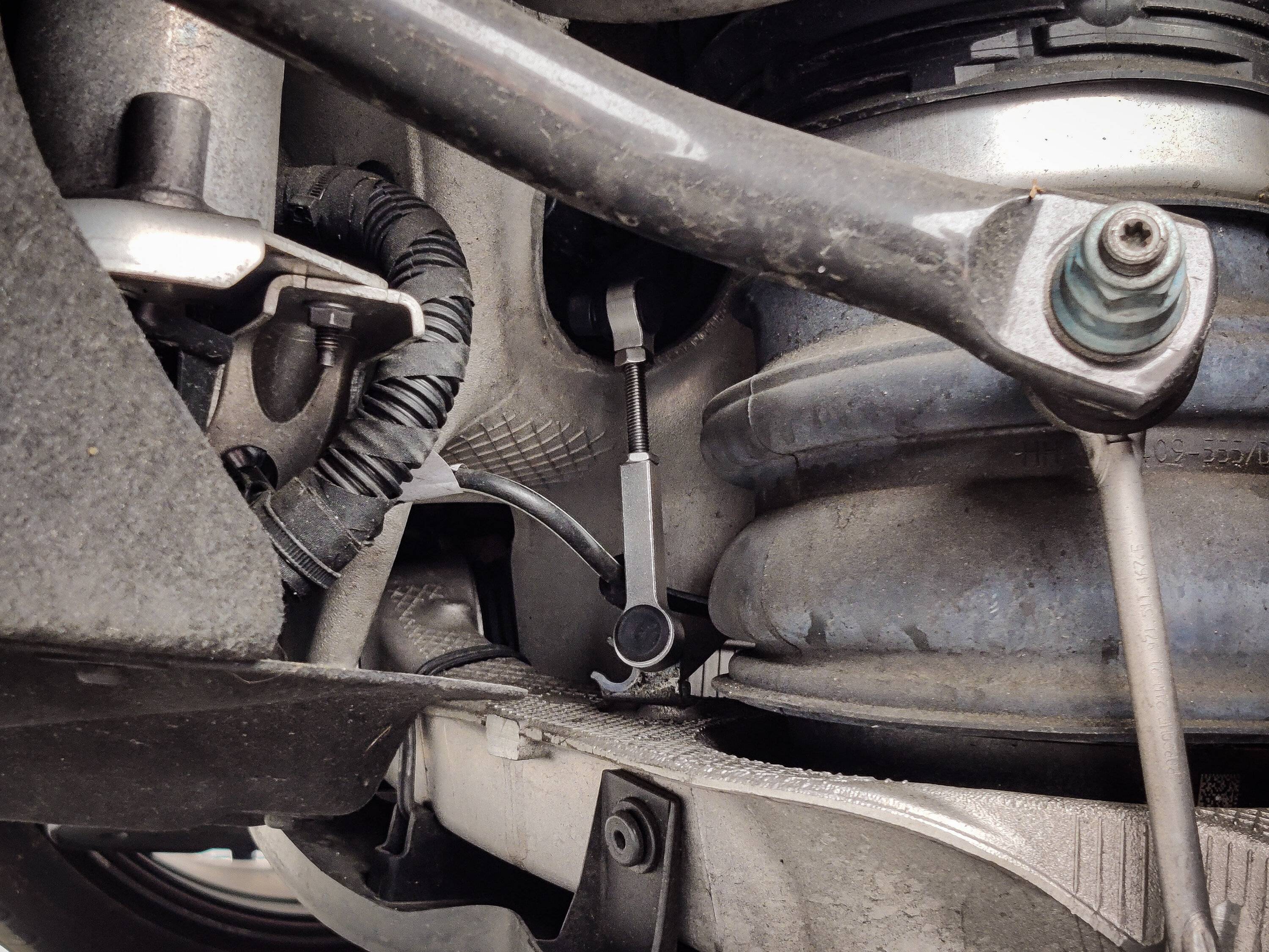

Had air suspension lowering links from Vivid Racing installed for a minor 5-6mm drop. Enough to look good but not slam it or compromise ride quality:
Porsche Taycan Lowering links? PSX_20221006_114449
Porsche Taycan Lowering links? PSX_20221006_114617
Porsche Taycan Lowering links? PSX_20221006_114353
Exactly, that looks much better.
My links provide 10mm and that's enough.
I tried 20mm but I could clearly see the increase in camber so that would need realignment so I switched back to 10mm.
At the tyre change there was no excessive wear on the rear, the front had some more wear on the inside but nothing that would need realignment, according to my dealer.
Besides, if I raise the car just one click I'm already in the OEM set-up so I think 10mm is the sweetspot: better looking and no compromising in ride quality.

1) Cool you were able to! I'll do the same. Thanks for sharing - as always.
2) Sorry for off topic - but it does work on mine. I had to connect it via wire first, but now wireless AA works.

maybe off topic here. I am from Hong Kong and own a 2020 Taycan, our Porsche dealer here doesn't enable Porsche Connect (or other connectivity related features) for MY2020 to MY2021 Taycans. Only MY2022 Taycan equiped with Porsche Connect. But some insiders in service center said actually all cars have the hardwares to use esim and Porsche Connect. Hopefully we (2020 & 2021 owners) can use Porsche Connect one day with VCDS!! Thank you @Dee
After the latest major updates, I saw on my phone there is wifi hotspot with my car's nickname available. I checked settings on my PCM, there is wifi hotspot enabled and I also found an IMEI in settings. So I guess very likely my car may have the required hardwares for Porsche Connect. Seems to me if a device 1) can share wifi and 2) have an IMEI, very likely it can use SIM or ESIM and connect to LTE/3G. I serached with the IMEI and I found the IMEI is from a thing called "CONBOX-HIGH with ALAS66A-W" not sure if it is the same conbox as you found on VCDS
As I saved my entire config of all the control modules I can go through them one by one on my computer instead of sitting in the car.
Dee
Dee
Dec 14, 2018
78
3,506
4,045
A lot
That's the one.
It's control module 75 "Telematics".
Still you need a contract with the provider, or at least Porsche should have the contract but you can try, sure.
You need to turn it on in the adaption IDE04750
