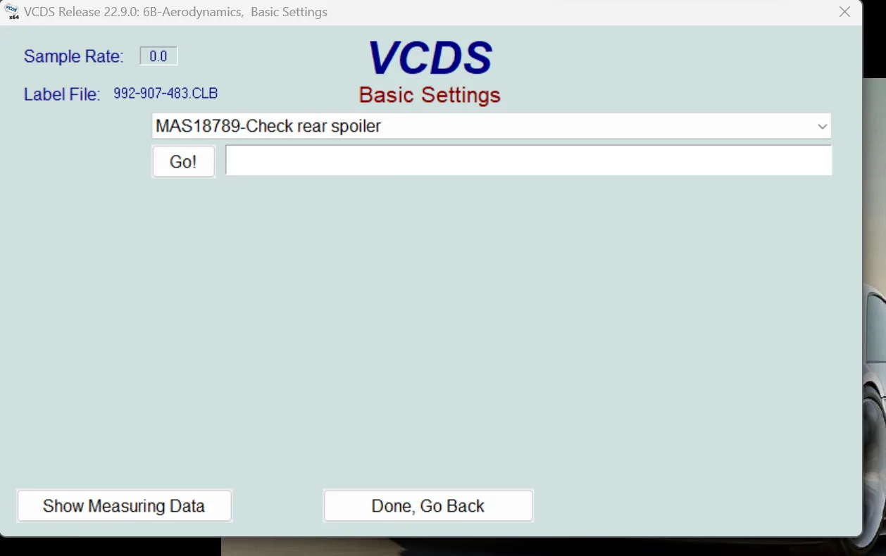

Let us know if you find a way to control the spoiler. :)
Porsche Taycan Lowering links? 1665238448693
It's control module 6B "Aerodynamics".
I don't know how it looks in VCDS on the car but according to this ADPmap you can even set treshhold speeds, when and how far the wing opens/closes.
Have to look at that some day, also if there's a test available to open it fully when the car is stationary.

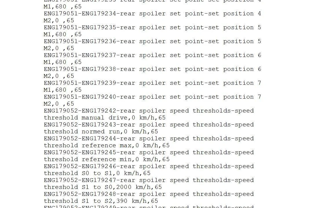

Porsche Taycan Lowering links? Schermafbeelding 2022-10-08 163737
I was curious so I tried but unfortunately there's a security key needed...:angry:
I also looked at the treshhold speeds and indeed, there's 65, 390 and 2000 km/h...
That doesn't make any sense, does it?
65 shoud be 90, 390 should be 150 and 2000 should be around 200 or so.
Anyone see a pattern?

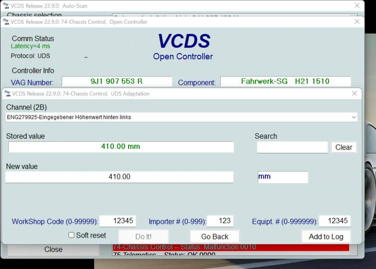

I managed to make a full back-up of my car so that's succes #1.
And now the best part: I got the SA (not the WSC), that's the Security Access code: 24084, succes #2!
@taycanlovers : here's the proof, changed from 399 into 410mm. :giggle:
I can also bleed the dampers, it's all in there.

Hi Dee, awesome work and thanks for sharing!
Can I ask what change you need to make here exactly? Do you just adjust the currently stored value by the amount of lift/drop you want? Eg. If the stored value is 410mm, would I change that to 400mm for a 10mm drop? And would that then be applied as an adjustment against all ride height settings?
My car should arrive in October. Super excited and really appreciate your help.
Thanks!

I've done this. An important thing missed from above is that in order to make adaptation changes using VCDS with certain control modules, the correct security access code is required.
On module 74 the code "20103" will be accepted but in my experience these don't make the required changes. Instead security access code "24085" should be used.
For the record, I lowered mine by 10mm and ran it like this for 2 weeks. I've just reverted to the stock figures.

Hi Moonstone. Thanks for the info!
Hoping you can help with my earlier query about what change to actually make:
Thanks!
Thanks!
No. The opposite. What you're doing is telling the module that the current height is actually higher that it really is, so that it reduces the height to get back to the correct level. So, you would increase it from 410mm to 420mm for a 10mm drop.

Ahh, I see! Thanks.
And that then applies globally to all ride height settings? Is the setting retained until changed back?
