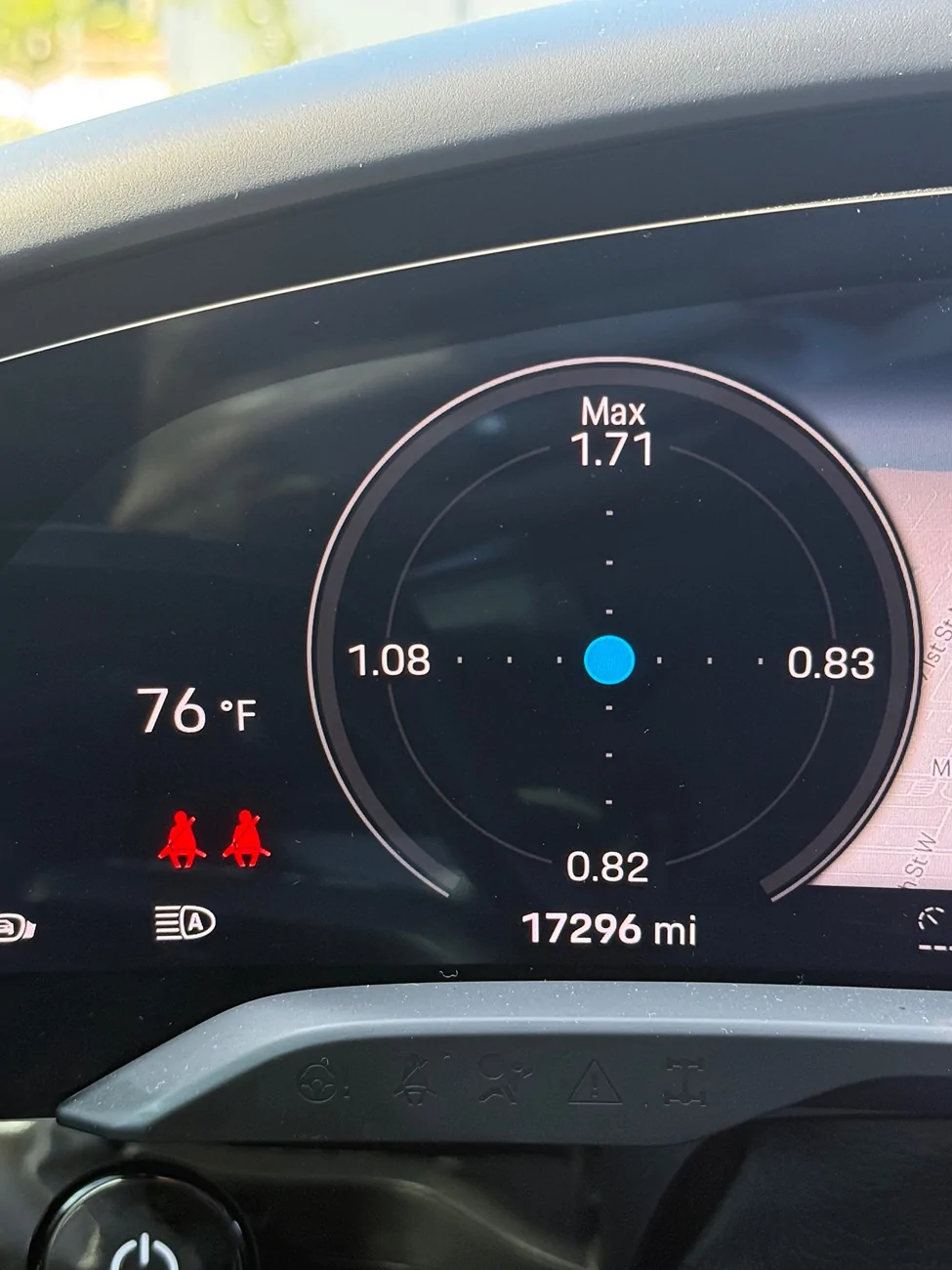

Here are my max readings:
Porsche Taycan Max G force from a roll IMG_2261

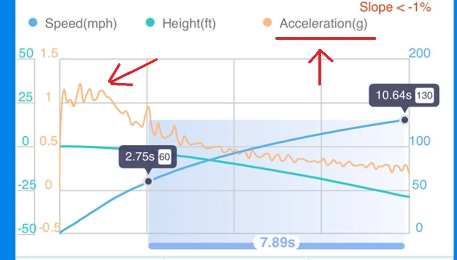

Dragy readings:
Porsche Taycan Max G force from a roll g-forc
Almost hit 1G again when transmission slammed into 2nd gear around 60 MPH.
My SoC was only around 70% which is why the 60-130 wasn't optimal.
Dragy readings:
Curious what your readings in your turbo S are not using launch control and starting from a roll….. 30 mph and again at 50 mph.
My theory is that my tuned 4S will likely be as fast or faster. Looking at your dragy, your launch is significantly quicker though.

I'm running the MapEV tune, so I'm more or less in launch mode all the time (790 hp and 775 ft-lbs).
Assuming your 4S has the performance battery, you should be around (720 hp and 487 ft-lb), at least that's what the MapEV website is showing. So yeah, if I didn't have a tune, I think you would take me.
My dragy run above was with a SoC of 70% on a 60F morning on cold tires on a regular road. So far from ideal. I'm hoping to be able to get down to 10.3 in the quarter at around 133 mph with a 60-130 around 7s, perhaps even slightly below.
