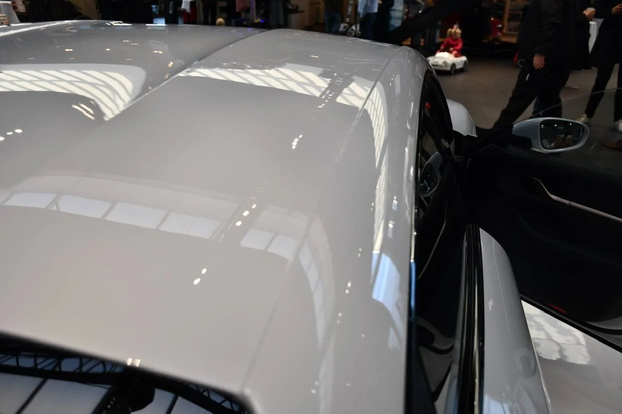

IMHO the aluminum roof looks better, is lighter weight, and even though the pano roof is tinted and provides some insulation from heat having the sun shining through is annoying to me. Also it's no cost. Rear seat headroom and roof transport aren't concerns so I went metal. Just personal preference.

The density of Ally is only about 10% more than glass and whilst I don't know how thick the ally sheet they use is it is likely to be much thinner than the glass maybe half the thickness or less.
There will be a bigger difference on the estate cars than the saloon I have a CT estate car.
I am fairly shocked if the Audi carbon roof weighs 10.2 kg :oops: that seems a lot to me but my experience is carbon fibre in Formula 1 car chassis not budget sensitive road cars...
FWIW I chose the metal roof because it looks so much better but I knew there would be a weight saving just not how much..

I just much prefer the look of the sculpted metal, and I don't like any of the glass roofs on cars I have had and on the Taycan it only benefits passengers and even they don't need it if you don't get drug-dealer windows.
