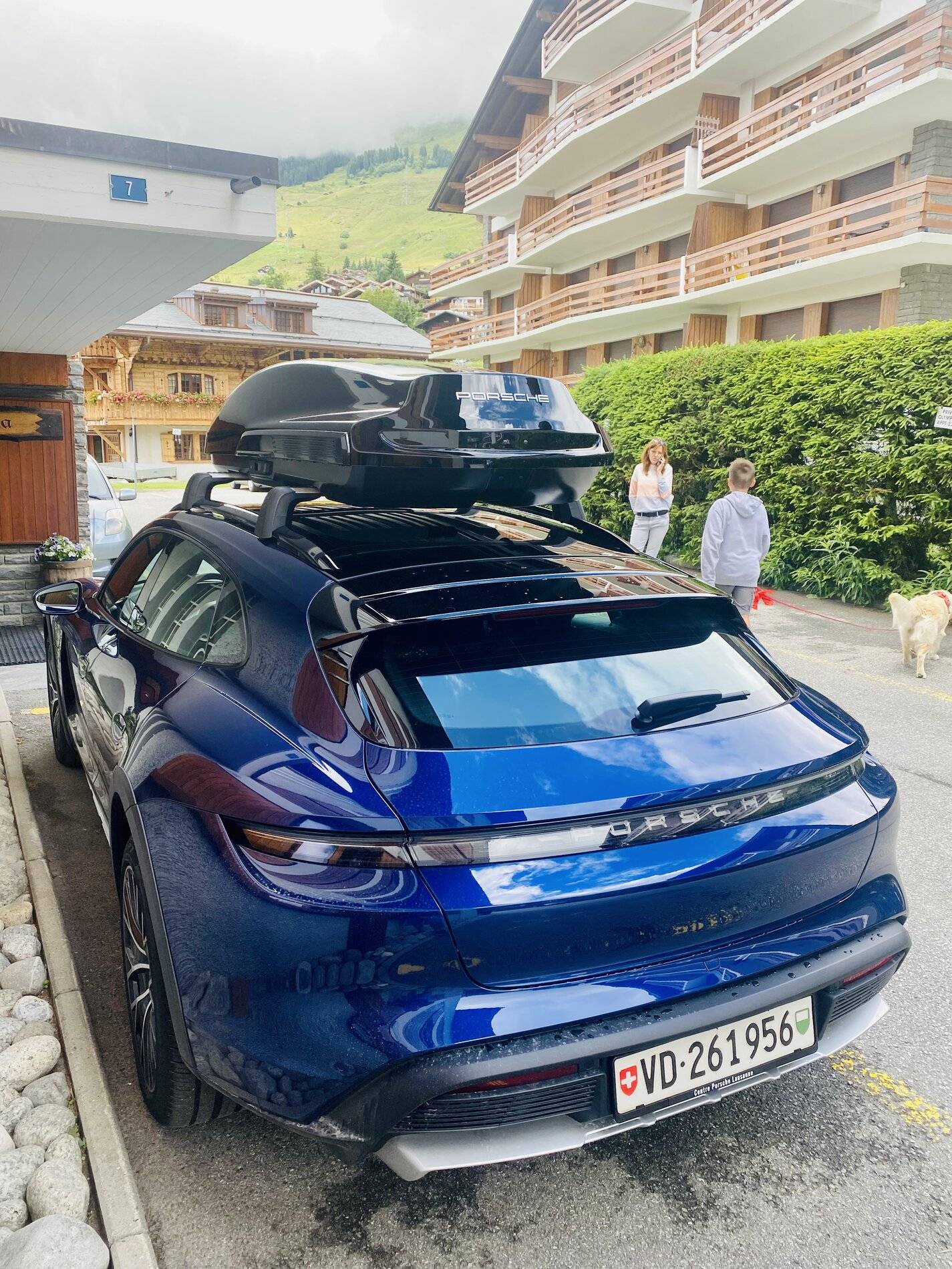

Honestly I didn’t notice much difference with the roof box on - maybe 5-10% worse? I’m getting 400-450km of range (20kWh/100km) without it in regular driving. Maybe 350-400km (22kWh) if all at 120+ With roof box on?

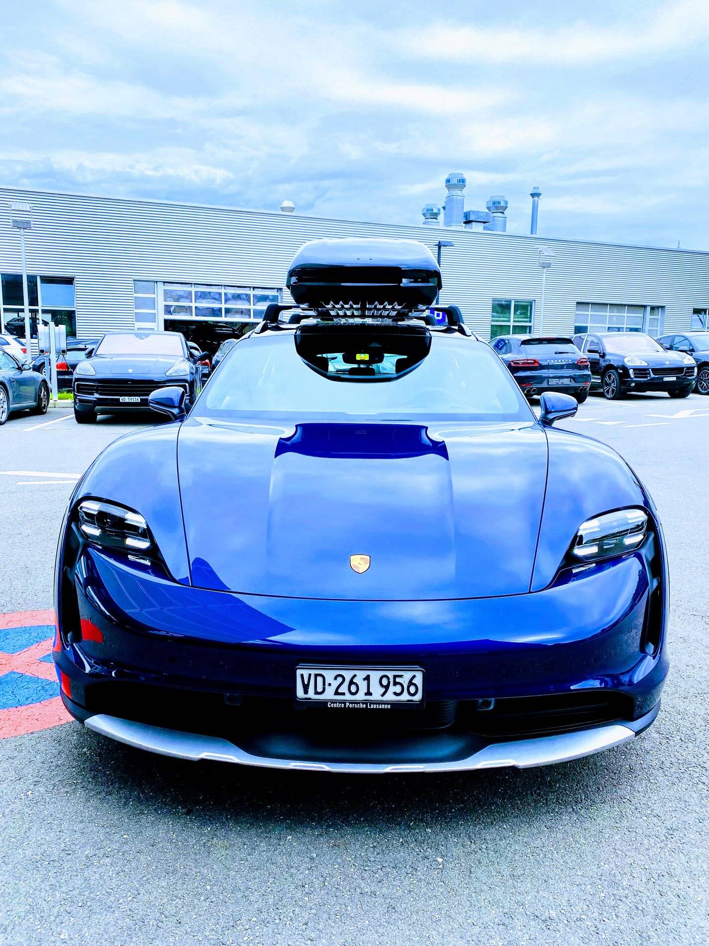

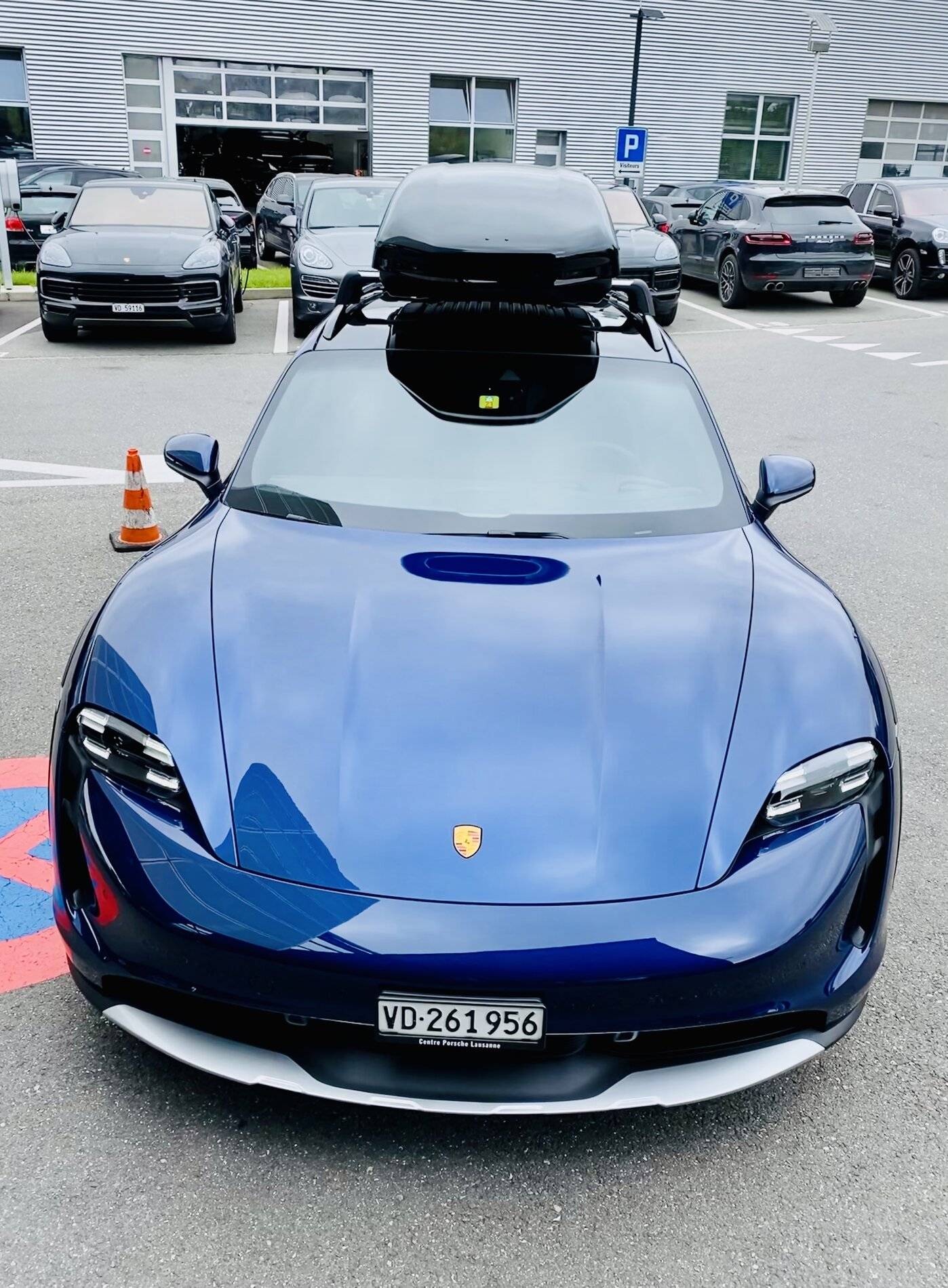

I got the Porsche ones and as above they have black plastic housing with silver bars. You don’t really notice with the roof box on as it’s so big, black and shiny!
