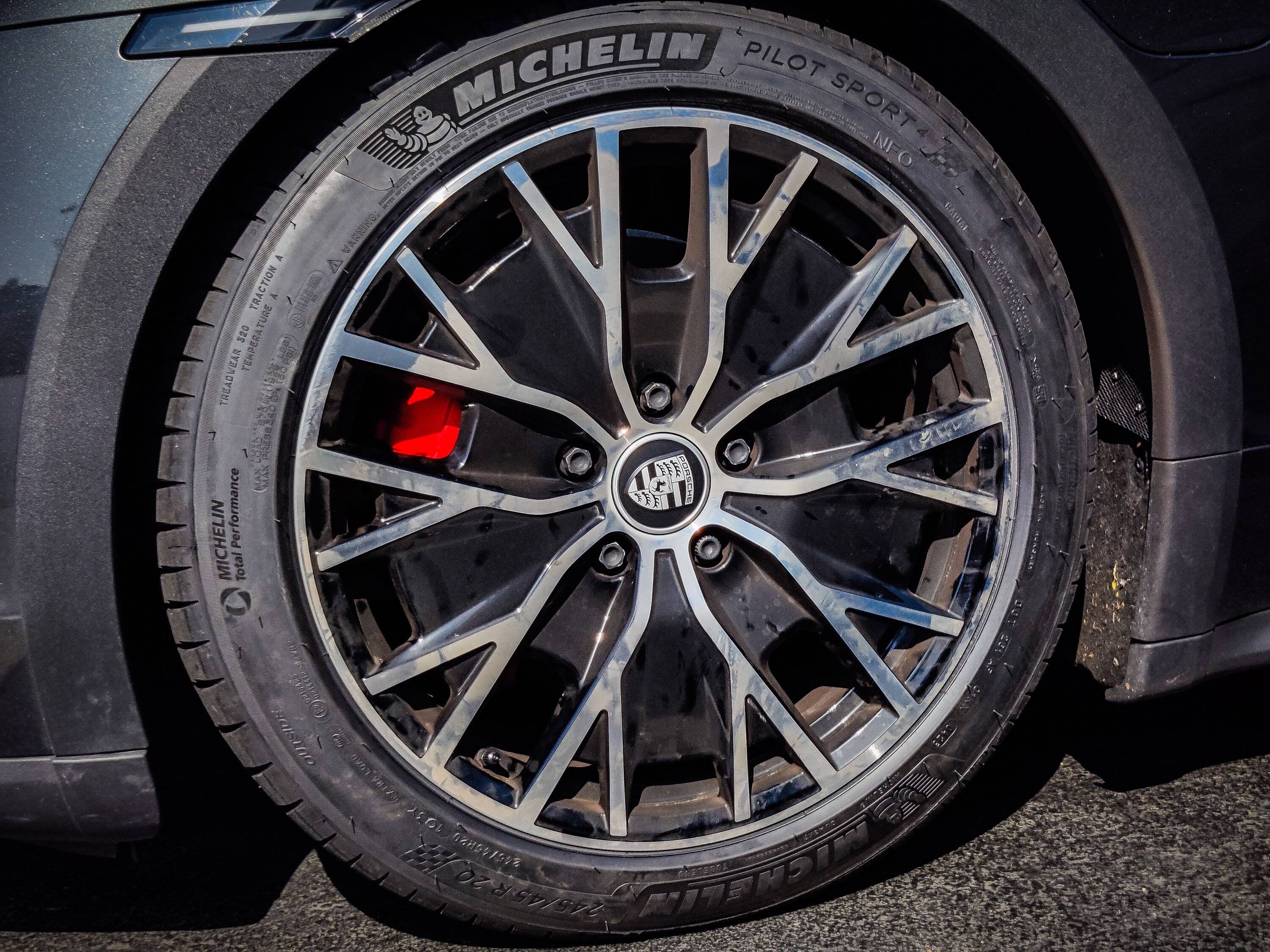

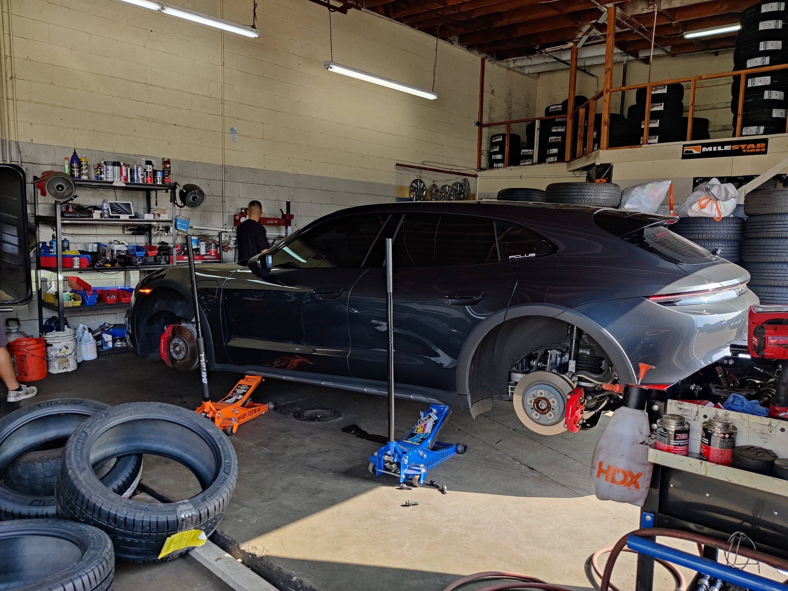

Ended up getting a set of Pilot Sport 4 tires fitted and mounted today. Will share impressions as I drive more:
Porsche Taycan Michelin Pilot Sport EV tires: Good or hot garbage? PSX_20231018_140900
Porsche Taycan Michelin Pilot Sport EV tires: Good or hot garbage? IMG_20231018_105444

Update after a few hundred miles on the Pilot Sport 4 tires:
Very happy with the new rubber, they are in fact more quiet than my Pirelli A/S tires and there is zero change in range efficiency. Still need to drive them hard to appreciate the improved grip and dry traction. ??
