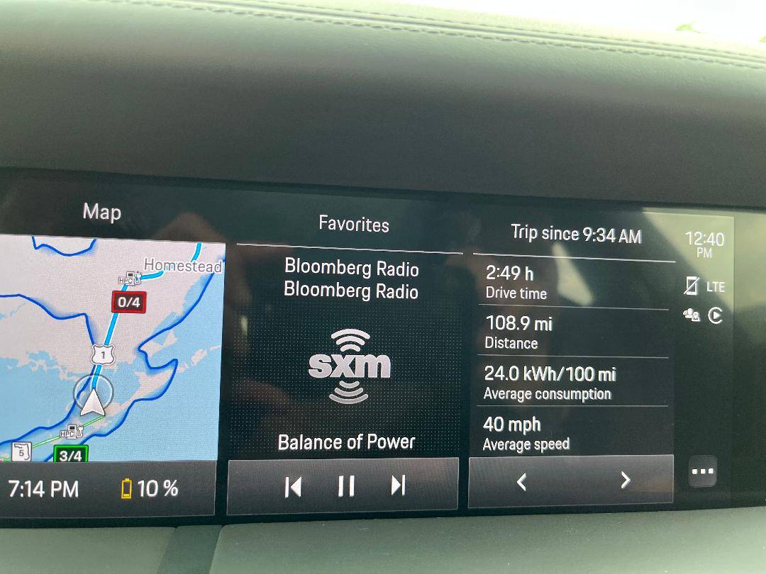

Porsche Taycan Miles(/km) per KwH Figures. Taycan low consumption
Florida, so warmer and flat. Usually 2.8 miles/kWh to 3.2. This was on a mid 70F, very flat, minimal stop lights drive in the Florida Keys. 4.16 miles/kWh. Slow and stead and the car is pretty efficient. The trip data seems to reflect reality pretty closely. The lifetime statistic of 3.6 miles/kWh shown in the app is total fiction. Probably around 3.0 out in the real world. 20" Pirelli Cinturato P7 Blue, pressures at spec.
