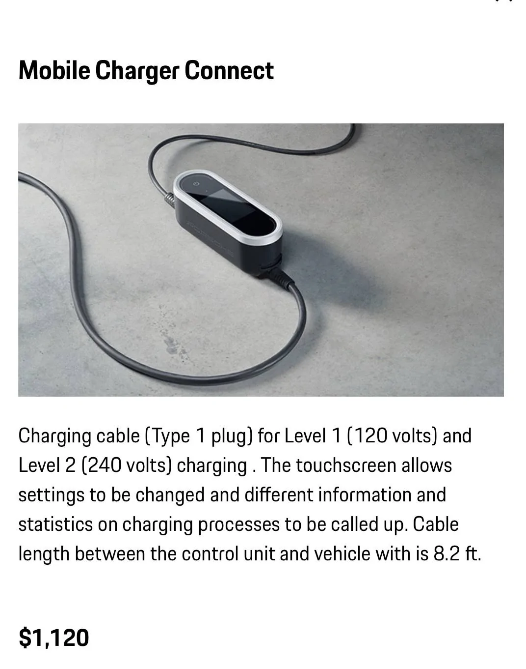

Hello, I bought a 2020 Taycan Turbo 4 months ago, and I love it! It was on the lot and came with an option called "mobile charger connect" for $1,120. They didnt have it at the time, so they ordered it, and I just picked it up. All I got was the main unit, with no cables to plug it into a wall or the car. Is this what that option is, or is it supposed to come with the cable to plug into the car and the wall? This seems like a complete rip off if I need to buy cables on top of the option price.
I have an EVSE at home, so I can charge the car, just want to be sure I get what I paid for!
Thanks in advance!

I believe it should have come with two 12” supply cables (5-15 for 120VAC and 14-50 for 240VAC) as well as an 8’ vehicle cable.
There are other optional supply cables and an optional 25’ vehicle cable.
Porsche Taycan Mobile Charger Connect E318DE3B-1659-4661-9B97-7C6F8C0A5C0E

That's exactly my thought, the description above isnt super clear (from their options on the website). Was hoping someone who got it with their vehicle can confirm, then I can tell the dealer what to give me :)

I have the standard PMC+, not the optional PMCC, but the PMC+ also comes with the two supply cables and the vehicle cable.

It comes in a bag with cables and some kind of mount. You definitely got ripped off.
Haha, Im sure they'll make it right, was just checking what it should come with. Surprised how confused they are.
