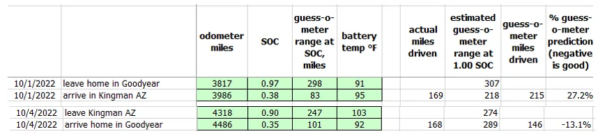

SOC estimates at destination: Example — On 9 Jan I left on a 200km trip and the PCM suggested i would reach my destination with a 22% SOC. The actual SOC on arrival was 12%. Any Idea why the PCM was out so much?
Sweet ride, @DavidS78 !
I've noticed that elevation change affects my guess-o-meter the most. When I drive around the flat Phoenix Arizona USA area, the guess-o-meter is tolerably accurate (within 5 percent).
Last October I drove from home to Kingman AZ (on the way to Las Vegas) with an elevation increase of about 2000 feet (610 m). At the start of the trip, the guess-o-meter read 298 miles (480 km). When I arrived at the charging station in Kingman, the guess-o-meter read 83 miles (134 km). So the guess-o-meter thought I drove 215 miles (346 km), but the odometer increased by only 169 miles (272 km).
A couple of days later, I drove home and stopped to charge up in Kingman again. When I left Kingman the guess-o-meter read 247 miles (398 km). When I arrived home, the guess-o-meter read 101 miles (163 km). So the guess-o-meter thought I drove 146 miles (235 km), but the odometer increased by 168 miles (270 km).
