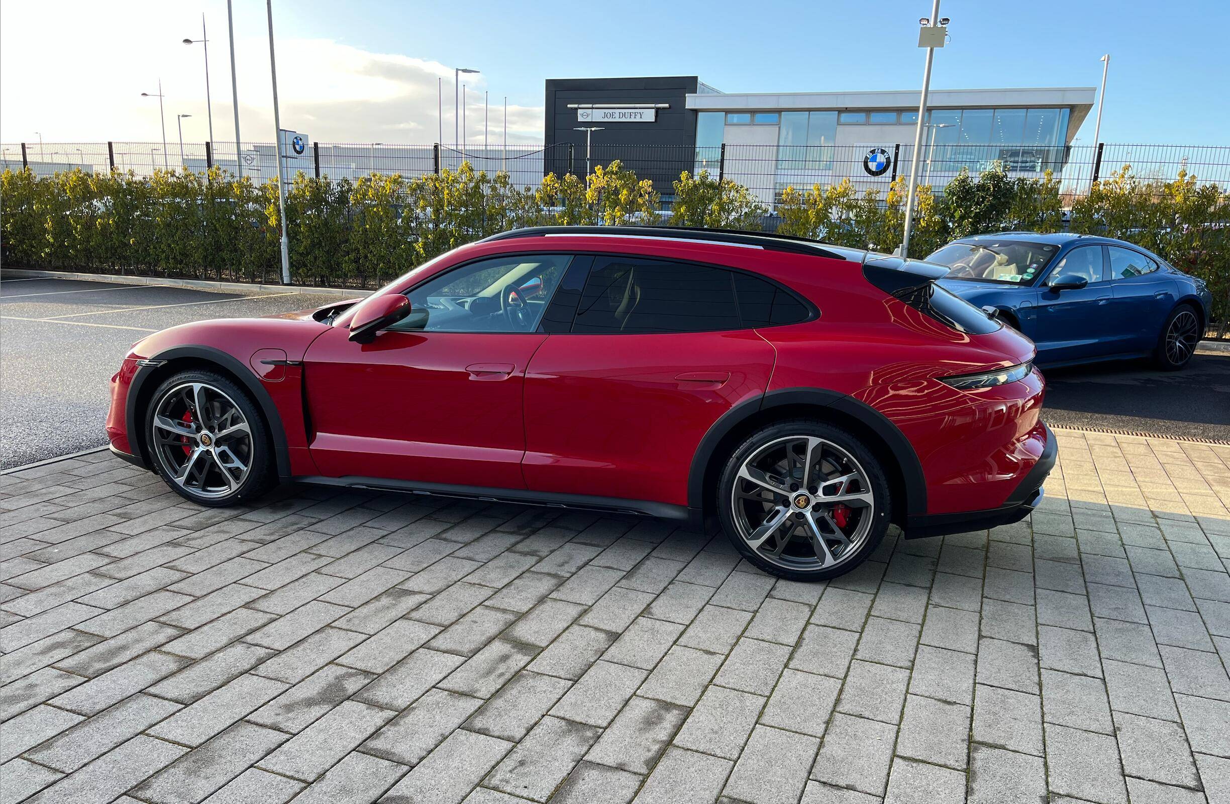

Porsche Taycan My first two days with my Porsche Taycan CT4S Screenshot 2023-01-09 at 21.29.19
  • Overall this car is fantastic. It has presence on the road and I’ve had numerous comments re: how wide it is! Not an issue for me coming from an Audi Q7!
  • Handling: This is not a 911 but for a heavy car it handles impeccably on the 21-Inch Cross Turismo Design Wheels. Regardless of mode it offers great confidence and reminds me of my days racing Go karts!
  • Consumption: As expected it is high but I am expecting this to improve once I put up the miles. I’ll keep the tracker below updated so folks can follow it’s progress.
Porsche Taycan My first two days with my Porsche Taycan CT4S Screenshot 2023-01-10 at 19.29.51
  • Regen: First experience today at circa 460 km on the clock.
  • PCM: Works well from a navigation perspective. On my limited longer trips I’ve purposely used it and it’s very informative.
  • Public Charging: No issues but the output from any I have tried so far is well below expected. Im not sure if this is the car, the ambient temperatures or charging hardware.
    • 9 Jan — Ionity 350 KW delivered a max of 100KW
    • 10 Jan — ESB ecar 150 KW delivered a max of 74KW
My open questions:
Tyre pressures: What impact do these have on consumption. Mine are currently a little all over the place. I’ll get this resolved later today
Weight: What impact if any does additional passengers (2) and luggage (2 x circa 15kg bags) have?
SOC estimates at destination: Example — On 9 Jan I left on a 200km trip and the PCM suggested i would reach my destination with a 22% SOC. The actual SOC on arrival was 12%. Any Idea why the PCM was out so much?
