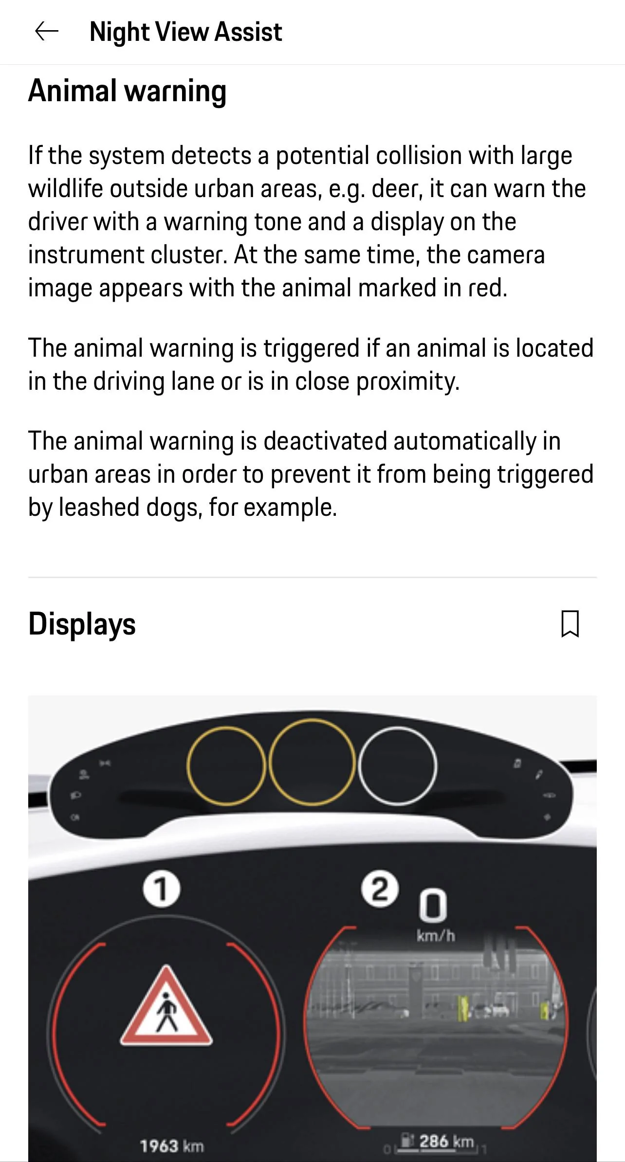

The Taycan is my first car with night vision. Would you say the BMW is as sophisticated as the Taycan for automatically detecting and responding to pedestrians vs. animals? I appreciate how Taycan night vision took over the display and gave an alert when a pedestrian was crossing the highway I was on at night. I did not have night vision displayed on the dash, but it was active in the background. I also appreciate how the Taycan filters out animals (not humans) within city limits to prevent false alerts from leashed pets:
Porsche Taycan My take on Night View Assist IMG_5959

Not possible AFAIK - I wanted to have it displayed in full screen on the Passenger Screen but was just dreaming :) The warnings will appear in the HUD but the thermal imaging cannot.
