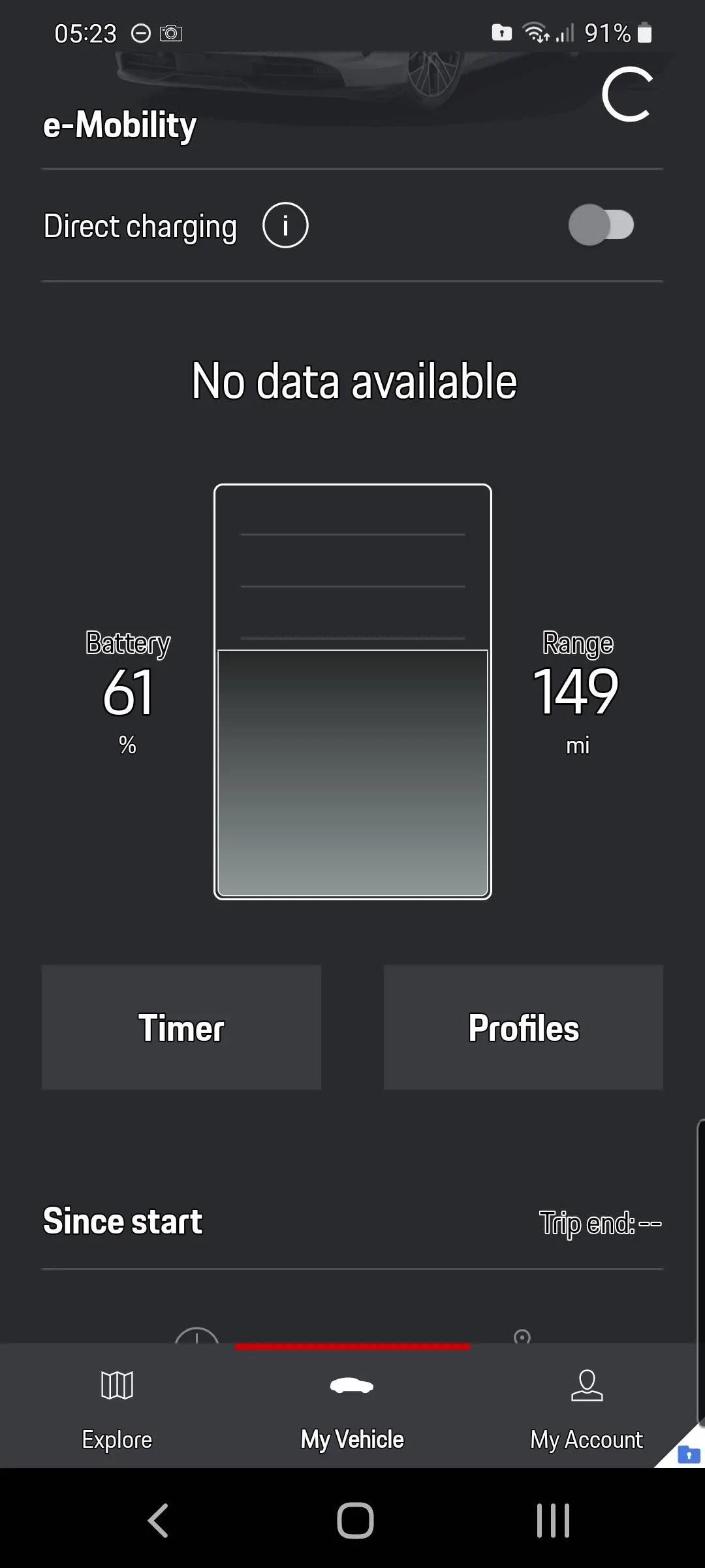

I have a MY21 and for the first time in 5 months when I log onto the app (or My Porsche website) I can't see any info on the car. The car shows but charge etc is not current (charge is actually 80% currently).
It shows the car pinging Porsche, but no response from their servers

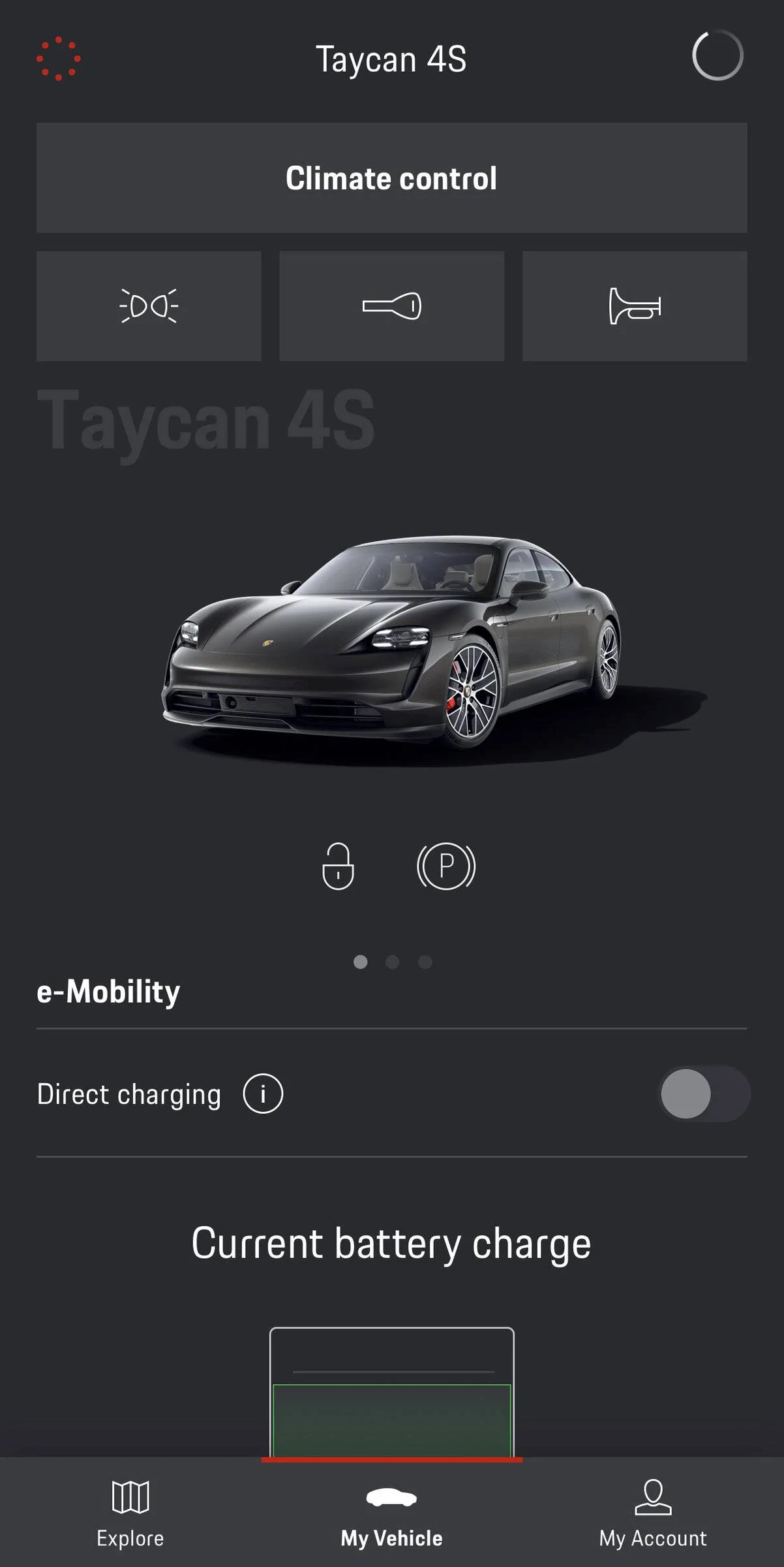

I was able to get setup when I picked up my MY22 on Thursday but the Porsche connect app is not connecting

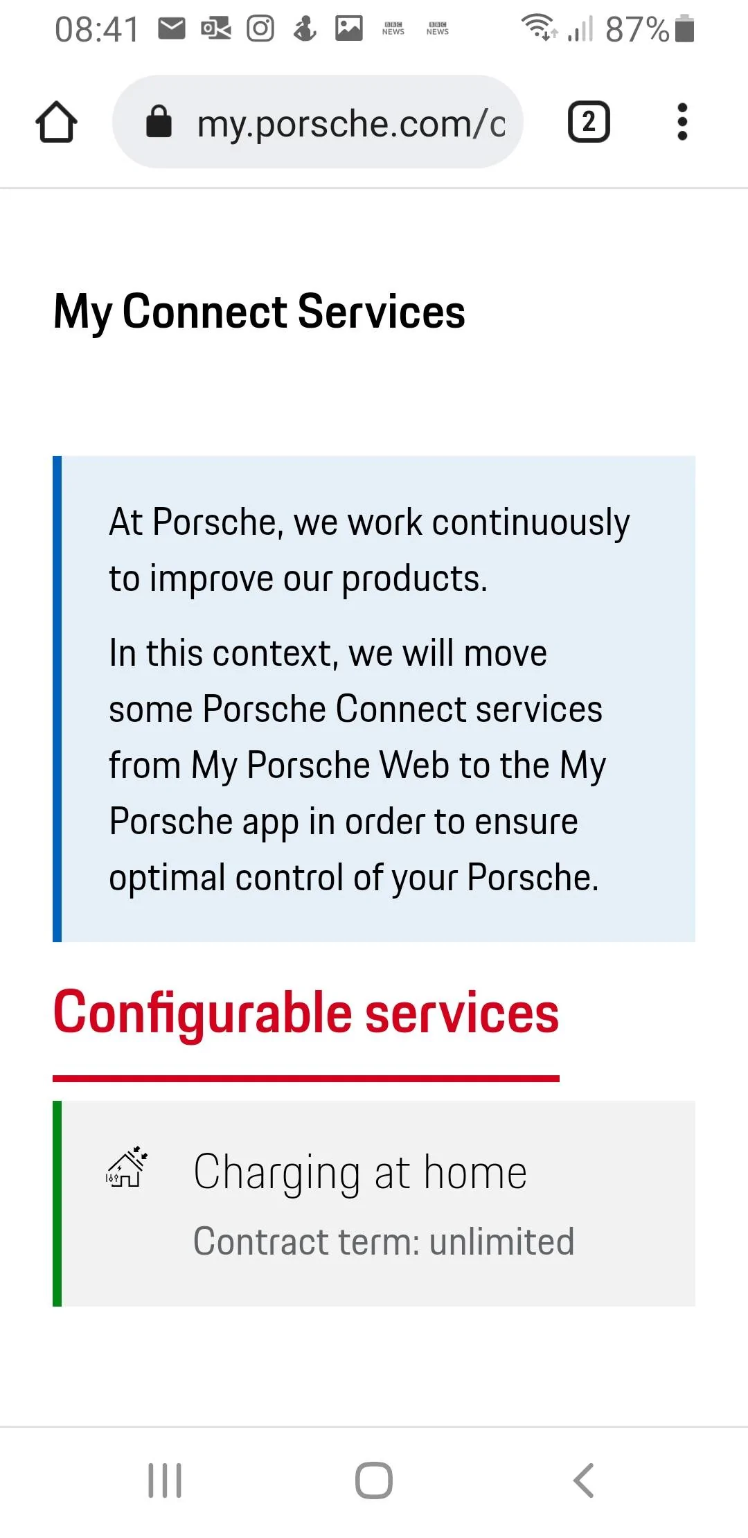

Connect services are down in general today due to web services being migrated to My Porsche App.
Nice of Porsche to communicate same.

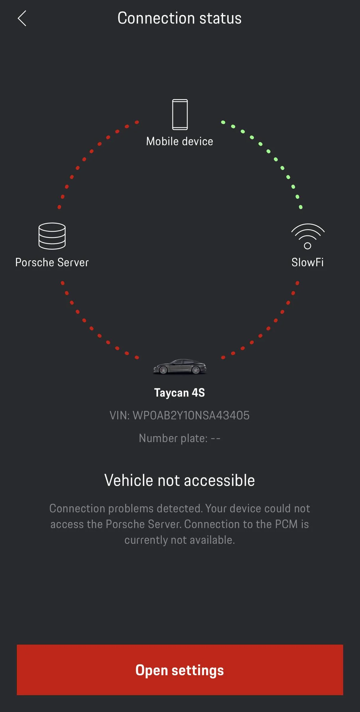

Seems to be working to some degree. No longer having the constant refresh and appear able to make some changes. But when I go to connection status, it says I have no connection to PCM
Edit - I think that is from my wifi network which is fine because the car isn’t at home.
