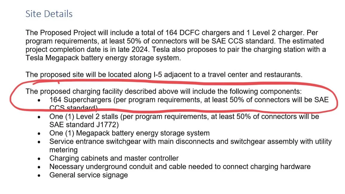

I still think you are wrong - time will tell - it's not that hard - and there are superchargers already permitted and being built that require 50% access to non-Tesla's as a condition of funding

4 sites already planned that require 50% access to non-Tesla vehicles…
https://driveteslacanada.ca/superch...ssive-superchargers-including-worlds-largest/
Most notably, one of the conditions for a successful grant involved a minimum of 50% of connectors being CCS standard. This means Tesla will probably be adding a CCS adapter at every stall, a project we have previously reported on called the Magic Dock
