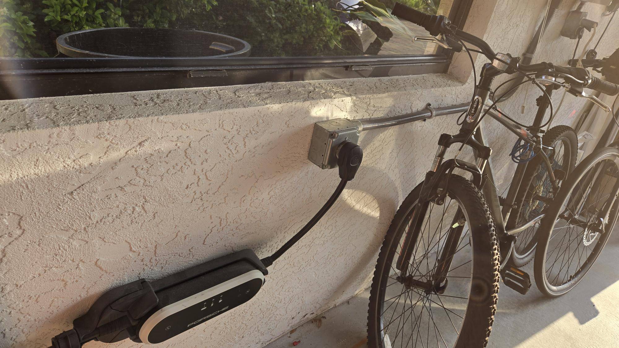

Greetings,
I am replacing my current charge due to the recall. I ordered the ChargePoint Home Flex Level 2 from Amazon. However, I see it won't work given the location of my NEMA outlet. I looked at the Wallbox Pulsar as well and it seems to have the same issue (i.e. the outlet needs to be below the charger).
Any suggestions? The current ChargePoint charger might work if I could turn it on its side and hang to left, but I would need to make the plug take a pretty sharp bend. Not sure that is prudent.
Appreciate any thoughts!

Do you have the chargepoint in hand? The 14-50 outlet doesn’t need to be below, but it does need to be close enough for the home flex to plug in without stressing the cable. Maybe it will reach if the box is just to the left? You might have to flip the 14-50 outlet 180. Otherwise if it were me, I would move the outlet down and to the right with a couple of conduit bends in a way that doesn’t need a longer wire run. If it isn’t a Hubble or other industrial outlet I’d swap it out as well. There might be other boxes that have longer pigtails. I don’t like the sideways idea, but that would work I guess. Finally. The home flex can be hardwired, and that might solve all this. But those options require an electrician if you are not comfortable with DIY.

Yeah it looks like your issues are twofold. First, the high outlet, second, it would be to the right of the charger, not the left, making your run to the outlet that much more challenging.
First I'd recommend trying to rotate the 14-50 outlet by 90 degrees so that the charger's plug would "naturally" fit that angle, and if that didn't work maybe try hardwiring. I just updated my ChargePoint's power to hardwire so I could make better use of my 60A breaker. Hardwiring was time consuming but not really difficult as long as you're being careful.
