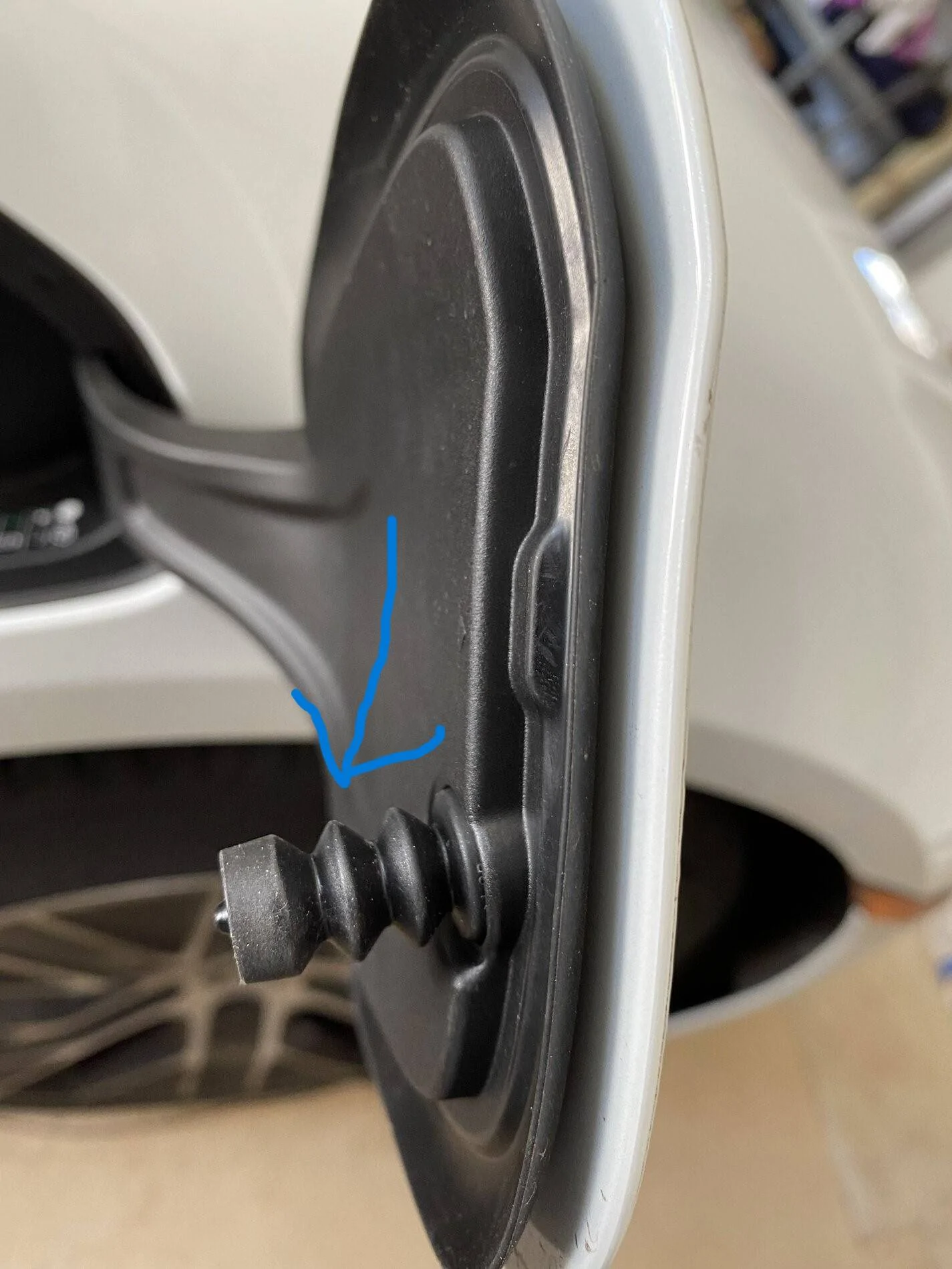

I broke this plastic part trying to manhandle the dainty CCS charging gun. I have tried everywhere to source with no joy.
Does anyone have the part # for this part? It is the locking pin/actuator for the non powered charging port door right side, not that the side should matter.
Thanks in advance.

Do you still have the pin and sure that it’s broken? I had mine come loose early in my ownership and it is held in by a twist to lock motion.

The pin broke off from the twist on base. Luckily I was able to locate it, but could not find the rubber dust shield. Yesterday, I sourced the part at a dealer and it is part of the entire throttle activation part. The pin is not sold separately. They want $88 for the entire unit part and then there is the labor to install it.
I went to plan B and used JB Weld epoxy to secure the pin to the base. Works just fine now!!!!
