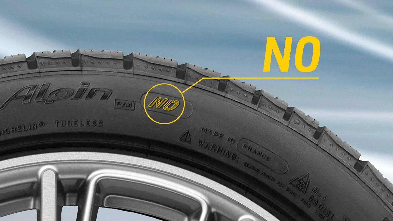

Sorry to keep getting back to the same topic - but when you say approved - I'm new to the brand, what does this mean in Porsche world? I know with my current car it can even impact your warranty, is it like that? Or is it more about the speed rating or the actual dimensions?
BigBob
Nov 27, 2021
1,959
1,533
They carry a Porsche rating on them. Basically a N rating. For the Taycan it is NF0 I think. Generally for porkers it is for a speed /performance rating and the Taycan version has extra strength given car weight.
