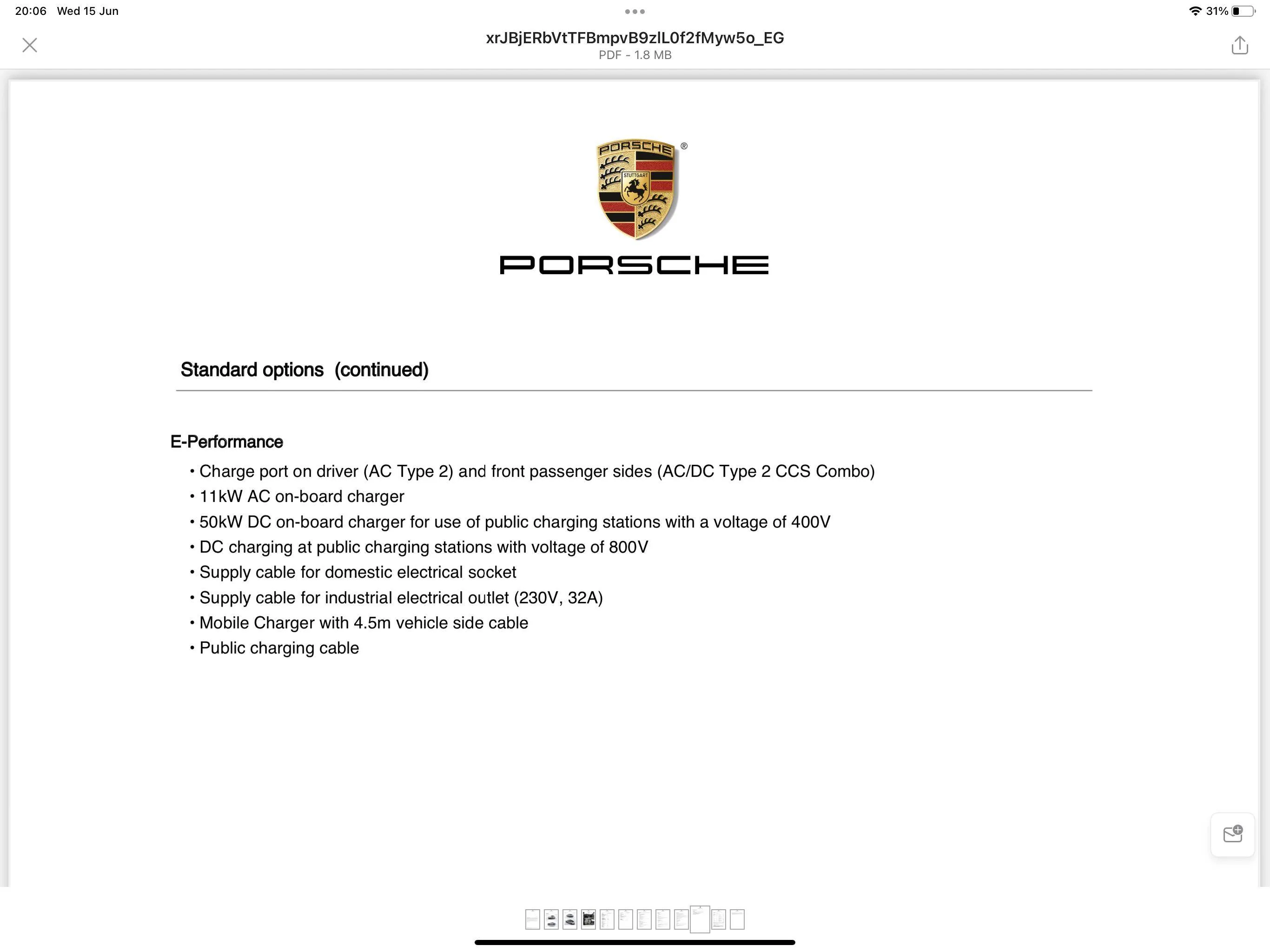

I'm not new to Porsche having owned 997's and 991's, with a 992 currently on order, but I am new to electric. So here's the basic question and forgive me if this has been covered elsewhere on the forum. The order confirmation states that the car ships with (amongst other cables), a 'mobile charger with 4.5m vehicle side cable'. Would this be 'Mobile Charger Plus' or 'Mobile Charger Connect'? I can't seem to find clarity on the Porsche website. Just trying to then work out how to set up at home and also separately at my place of work for coverage in terms of charging. Any guidance is most welcomed! Thanks, Ed

Mobile Charger Plus, 4.5m 32A EVSE (charger) to car cable (may be too short for your needs), 13A to EVSE supply cable and a 32A industrial supply cable (you must install a 32A fused supply from your main fuse board to your EVSE location in order to get 7.4kW of power.
Mobile Charger Connect is an expensive option but can handle up to 22kW of power if you plan to have a 3 phase electrical supply and have optioned the 22kW AC on board charger. If you don't option the 22kW AC onboard option but have 3 phase then you can still take advantage and charge to the max 11kW (standard AC onboard charger).
Note that 'charger' is misleading. The actual charger for AC and DC charging is physically in the car. The wall box, Mobile Charger Plus, Mobile Charger Connect, other 3rd party devices are Electrical Vehicle Supply Equipment (for safe supply of electricity) otherwise known as an EVSE.

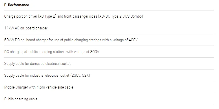

Standard spec details this for you on the configurator

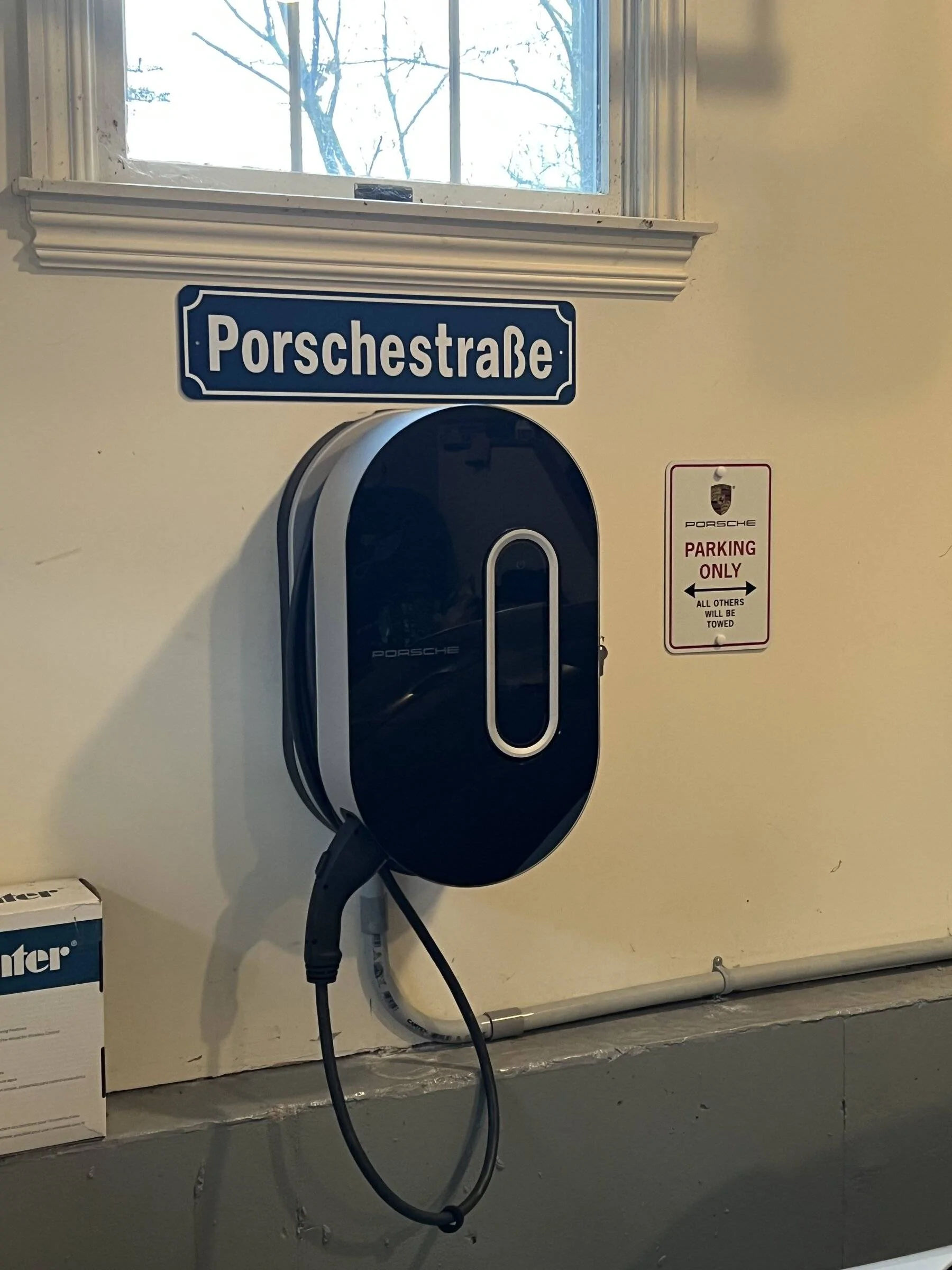

Porsche Taycan Newbie basic questions! 3ba619df-5682-4ec2-82d5-c3afbd0d7b5e-jpeg
50 amp circuit to the PMCC in the charging dock delivering 40 amps and 9.6kw (usually see about 8.7-8.9kw into the battery). Picture is to really only to show off Porschestraße and Parking signs my kids got me for Christmas from Suncoast ;)
This was from a previous post.

The PMC+ is thinner (therefore lighter) than the PMCC which means it doesn't sit well within the dock and I wouldn't recommend it. PMCC sits flush and the PMC+ would look quite recessed and therefore 'odd'.
Both PMC+ and PMCC are IP55 rated and therefore don't require special housing. That said I would not install either without some protection. My neighbour has a PMCC installed outside and fully exposed to the weather - so far so good.
