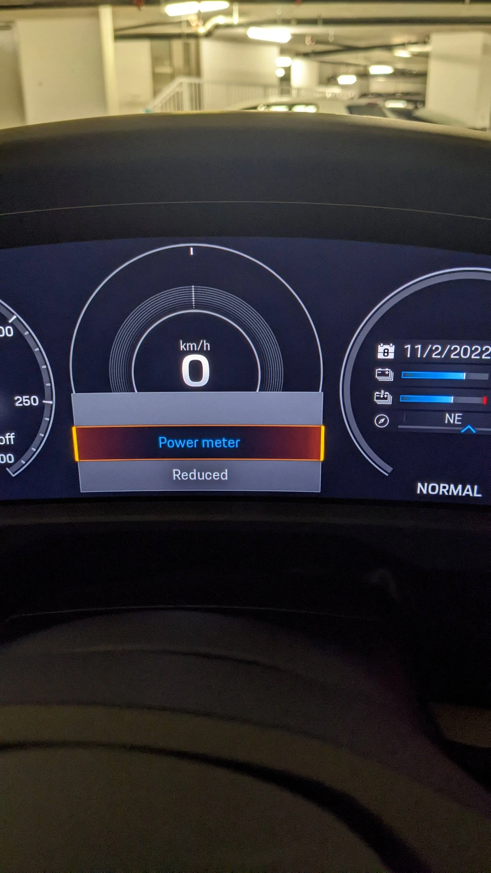

Just took my car back following the PCM 6 update. Now on version 3793.
Seems like I no longer have the ability to display/navigation in the instrument cluster display. Is this a feature that was removed or just another bug I am experiencing? See photo below:

I expect that's a bug. I have the uPdate and the map on the gauge cluster works fine for me.

Hi Jay,
I’ve had this happen a couple of times...before the update and after. An annoying bug that seems to occur mostly after my car is parked in the garage. After leaving it parked and locked outside for a while, it comes good.

I think my instrument cluster map went off one of the times my PCM has had a brief 'blackout' post uPdate?
I know last time my PCM went blank, then shortly after the lower screen also blacked out (both just rebooted after a couple of minutes).
Pretty sure it is something to do with poor signal and possibly OTA update.
Is your car getting a good signal?
I wouldn't say a bug... it's probably temporary glitch.
Map worked before and it works for me after uPdate without any problems.

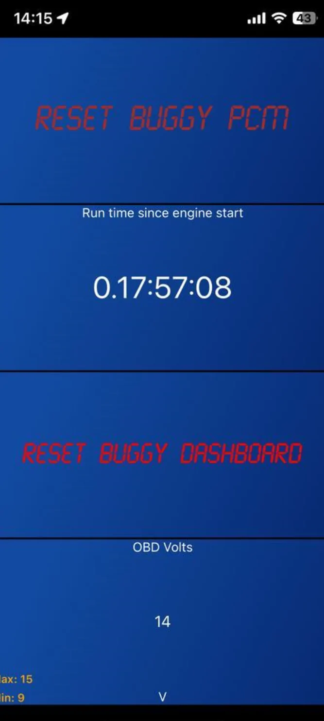

it's not the only issue the dashboad has since uPdate (see also my mentioned maneuver info bug)
I even added a new button to car scanner app to reset the dashboard.
Porsche Taycan No more map display in the instrument cluster since PCM6 update 1667481382909
to create such a reset button simply create custom sensor of type Action PID with command "1102" and header "714"
I mostly park underground so poor signal. Will try again with it outside. Thanks!
