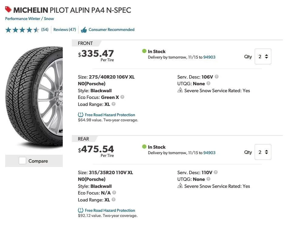

Okay, I've done some research about what would match the oem diameters, and it looks like this would be the best option:
Front: 275/40R20
Rear: 315/35R20
Anyone have notes/experience on this sizing?

The TS860 looks great, but unfortunately it doesn't look like those specific sizes are available in the US. I'm now trying to locate a set of the Alpin 5s since those seem to have improved mileage and reduced aquaplaning, but they are new in these sizes so I'm not seeing availability for the 315s yet.

Update that I went ahead with the PA4s: the Alpin 5s were launched in August, but neither TireRack nor local retailers thought I would be able to get the 315s this year. Tires arrive today and I'm headed up to Tahoe this weekend, so I'll report back soon.

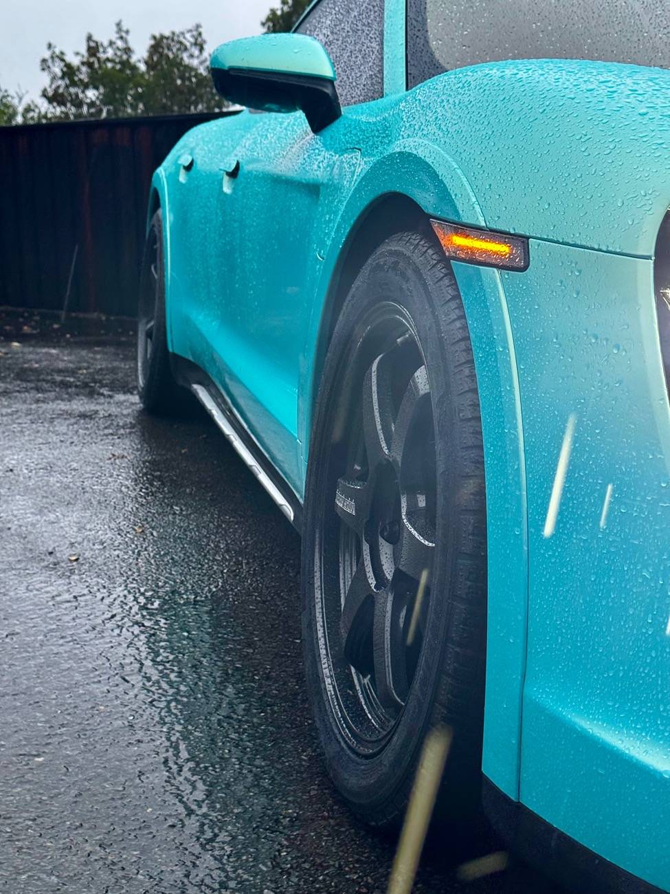

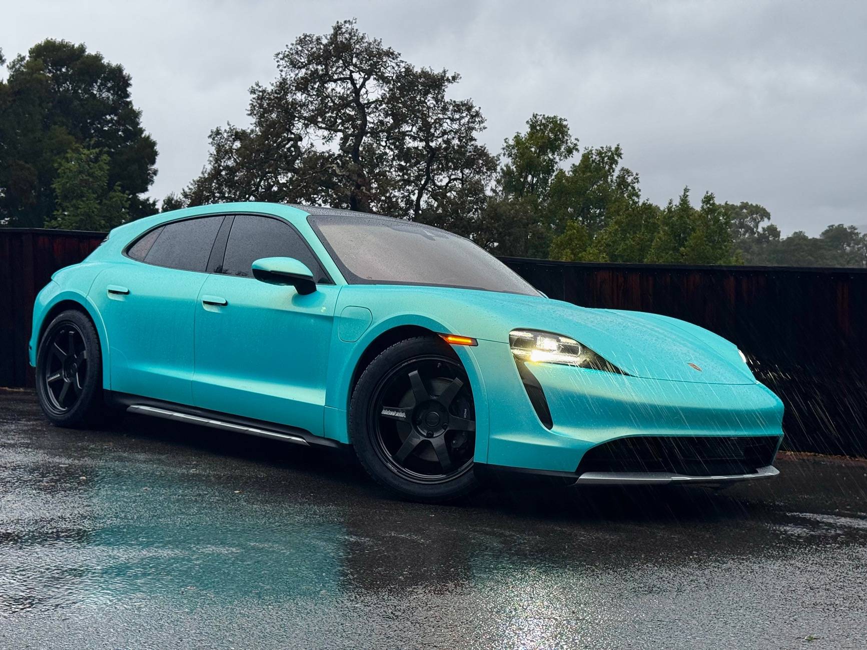

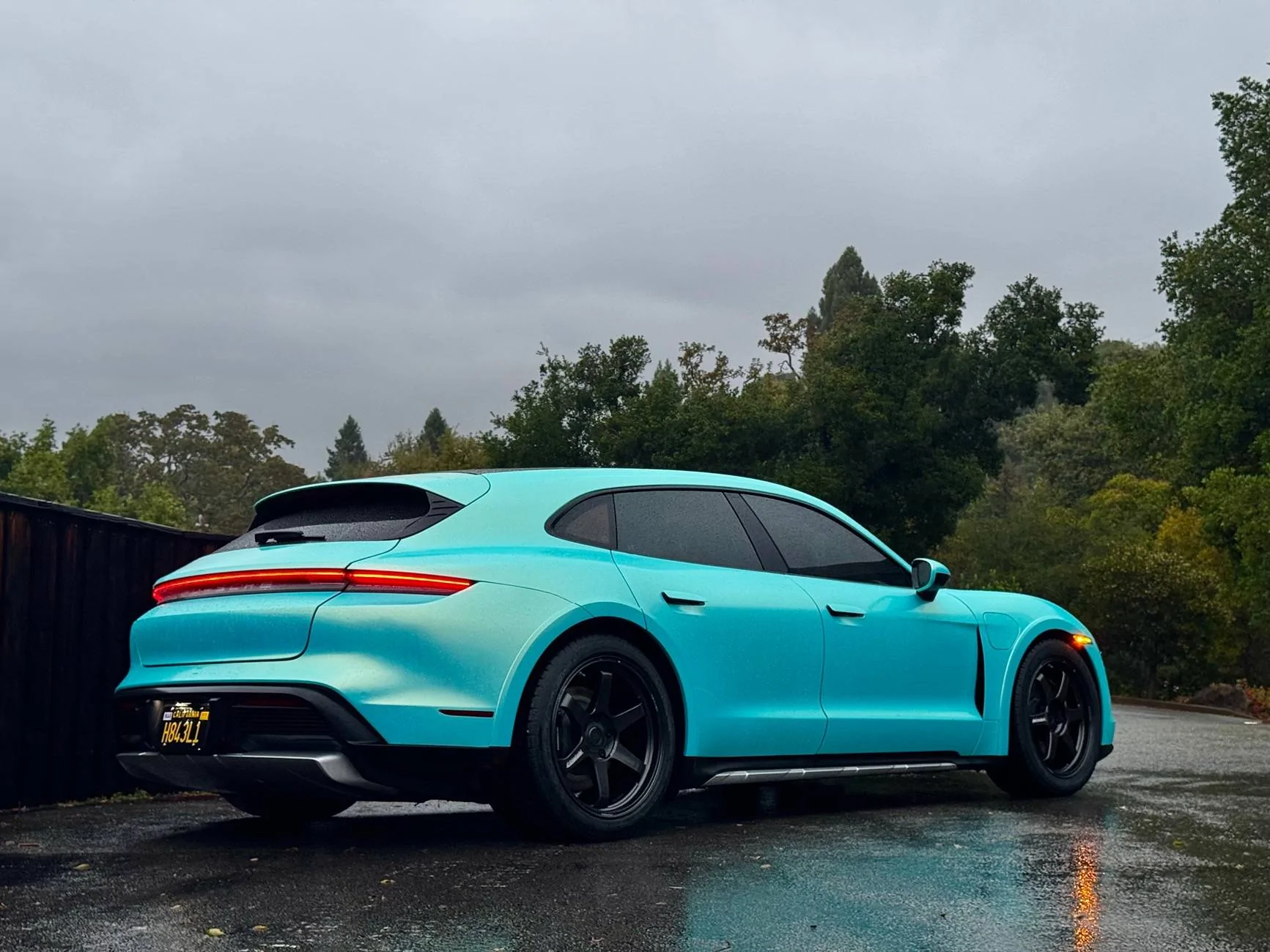

Got the Volks installed today!
No snow yet, but I got about 40 miles in the dumping rain and they are definitely handling it better than the summer tires. Ride quality is fantastic on the 20s (vs 21s).

This looks great. Whats the tire size? Did u lower ur car?
illTonic
illTonic
Ryan
Mar 7, 2024
'01 M3, '06 Z4M Coupe, '13 Golf R, '23 Lucid Air
The car is lowered with oem sport turismo links. Final specs were as discussed above:
Wheels Volk Racing TE37 Ultra M-Spec, 5x130, Diamond Dark Gunmetal
20x9 +45 Front
20x12 +58 Rear
Tires Michelin Pilot Alpin PA4
275/40R20 ̃ Front
315/35R20 ̃ Rear
