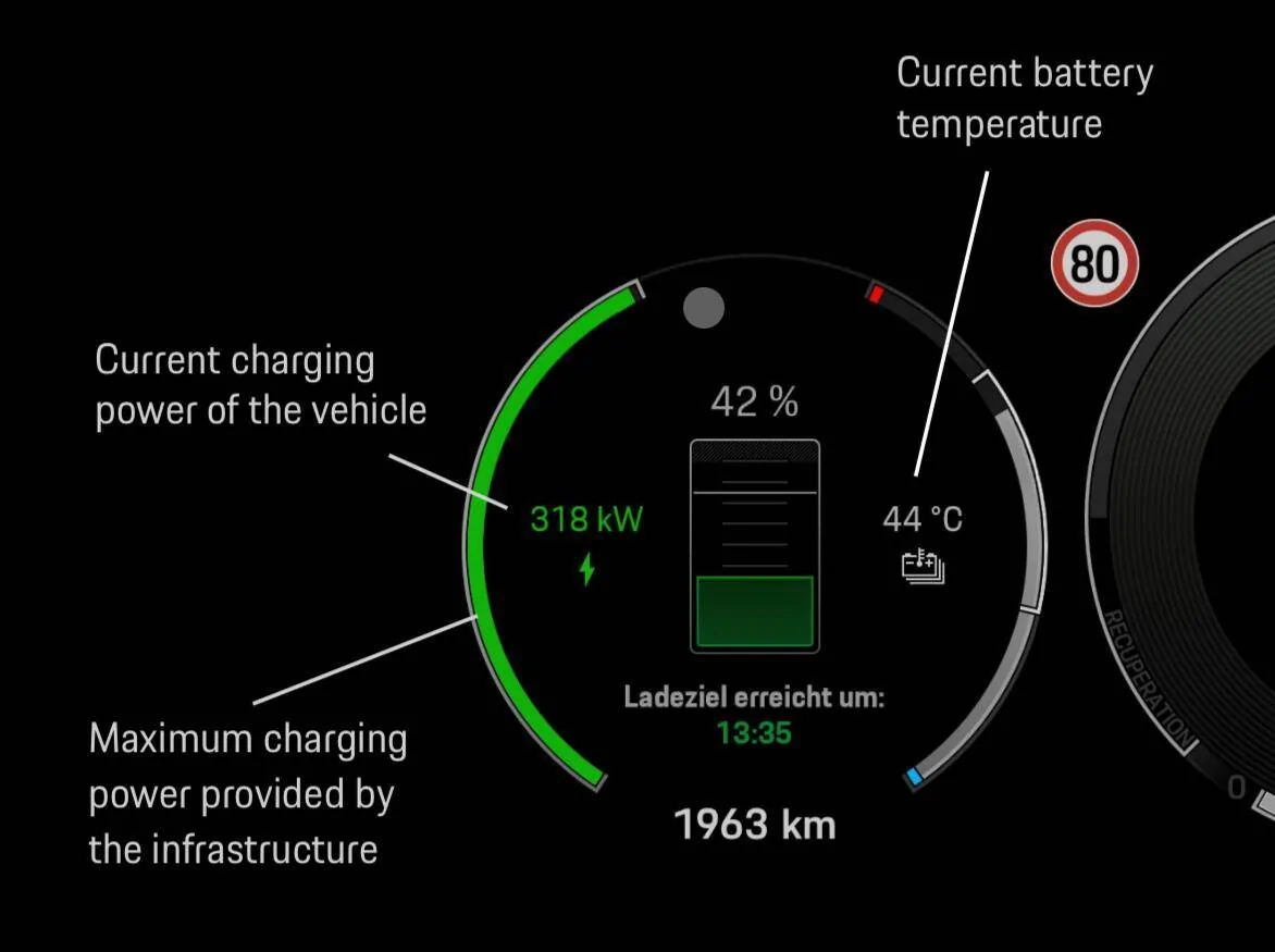

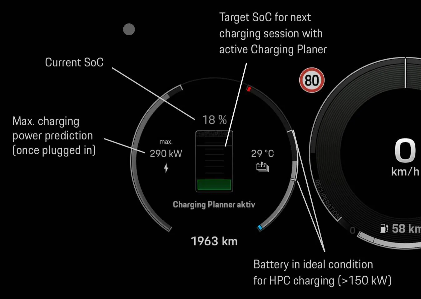

The new Taycan already has this actually. It shows the currently maximum charge rate of the car, what the charger outputs, the optimal temperature range of the battery and the current temperature.
193
7,039
10,541
It has been a very warm summer, so
screen shot?
193
7,039
10,541
They also added a button to manually preheat/precool the battery for charging instead of having to start navigation to the charger.
wow! thank you thank you thank you!!!! This is a vast software improvement vs gen1 Taycan charging information - I hope they have similar or better for the new Macan!!!
thank you again for posting this - I was unaware gen2 finally has better charging information.
