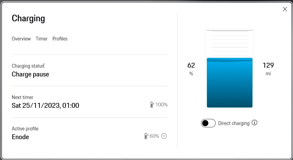

  2. Enode is the automatic profile that is generated. Screenshot from My Porsche website (more info than from the app). Your in car lower display will show something similar as will the My Porsche App. Ignore the random times. Rely on the Charge Anytime App for departure time and minimum charge when charging at home where the OVO supply is.
