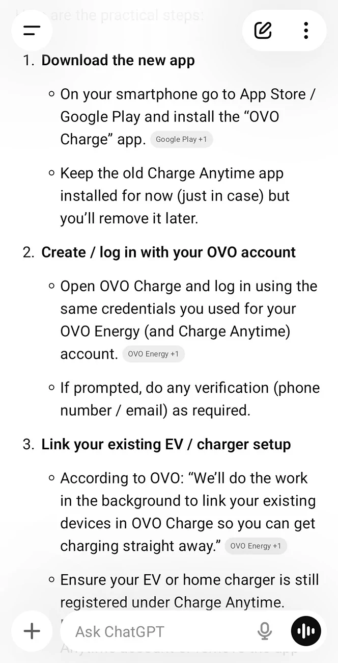

Hi Frank
My move to the new OVO Charge App went smoothly and from memory I just logged in with my OVO Energy log in and followed the instructions
Chat GPT instructions attached
I may move to EON but the savings are not huge. For me it is not worth paying for any of the OVO subscriptions
Porsche Taycan Ovo Charge Anytime changing Screenshot_20251108_130017_ChatGPT

Yup, I did the same move to new app this morning using my OVO Energy account details. Shame they brought this in now because i’ve only got a few months left on my Taycan before it goes and then I’m done with EVs for a bit and will also likely be switching away from OVO Engery too.

The new app is far better - and shows actual cost savings better. Seems to communicate with the car better too. It’s worth persevering with logging in
